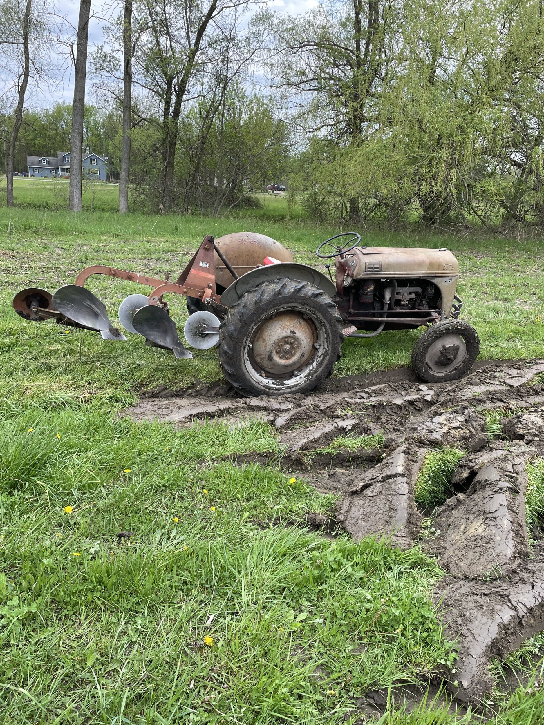

I still have that tractor, and still enjoy using it for many tasks. There’s none I’d rather have for use on firewood with a carryall, or on my two row corn planter. The funnest thing to do with it is plowing though, and I just knocked off three acres with it yesterday.
It pulls that 2x12 plow better than it ever did, since one of the rear rims rusted thru and all the calcium leaked out (3) winters ago. It used to always pull a little to one side, taking lots of brake use to keep it straight. That was a waste of gasoline and needless wear on brake pads.
Traction is better on the furrow side, where the down draft is greater. Lightening the weight, by loosing the ballast on that side, makes for a more even pull force. That keeps the tractor and the furrows straight. While that works great now on the plow, it hurts me on the two row cultivator, and I’ve had to move that operation to one of my other “modern” tractors, which had both rear tires ballasted.

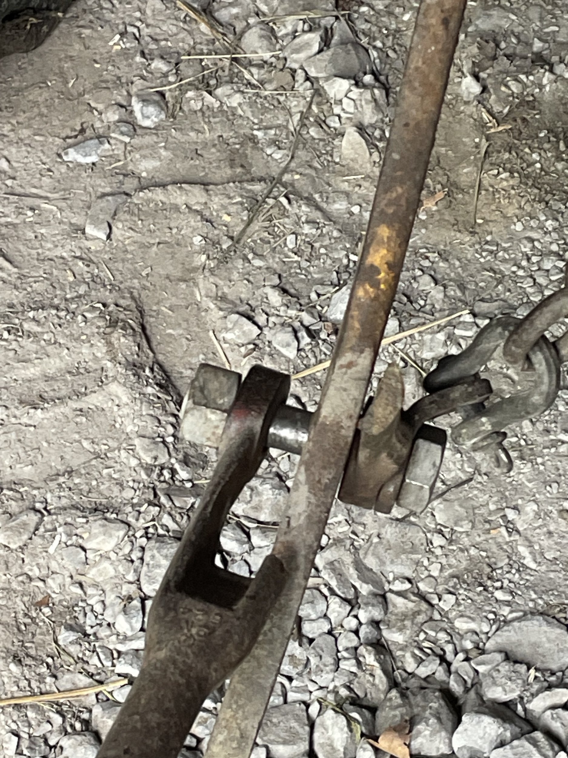

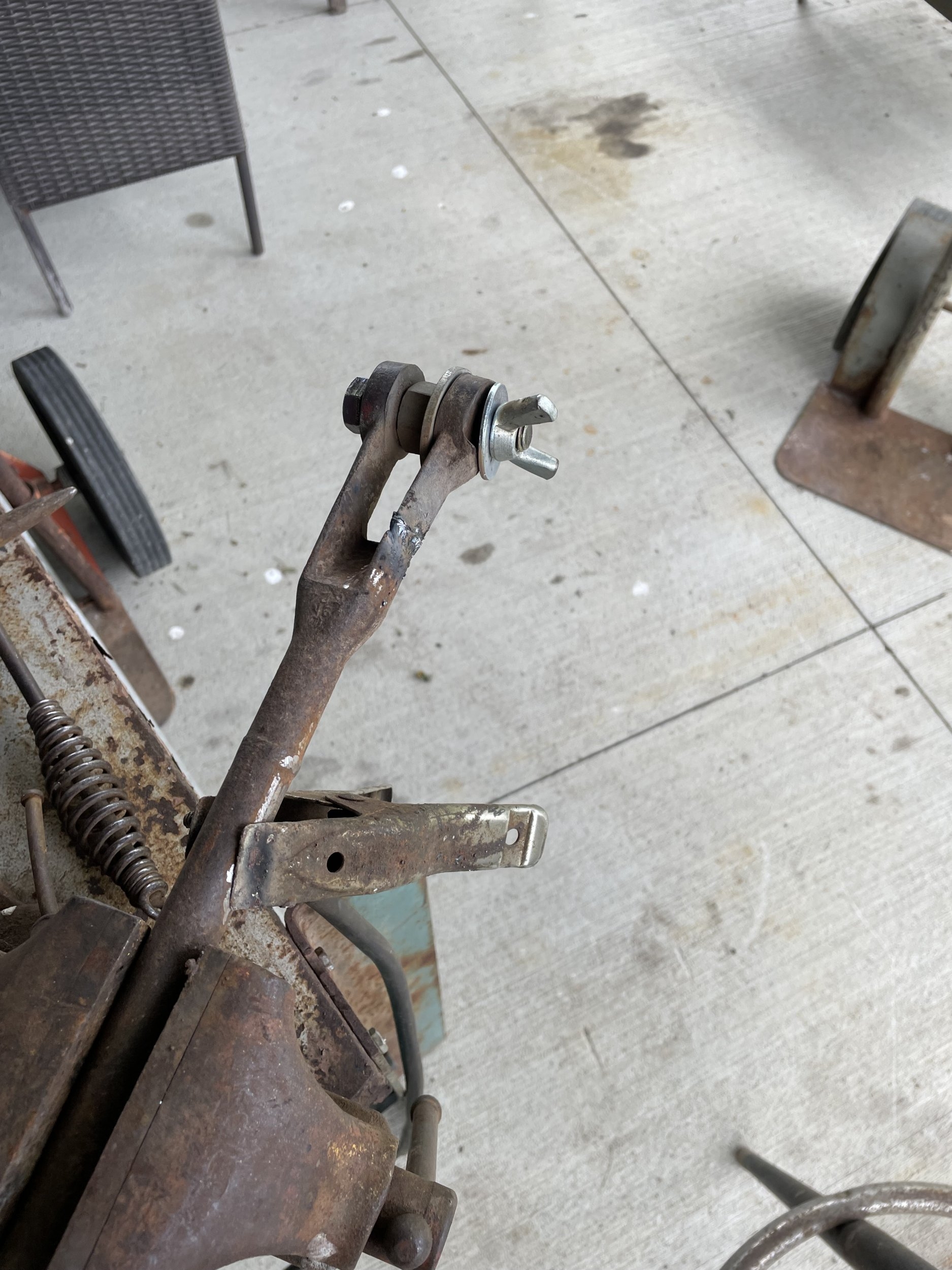

Speaking of plowing, I did suffer a minor breakdown on Saturday. I’m not sure when it happened, but I noticed it when I was putting the plow away. The fork broke on the end of the left lower link support.

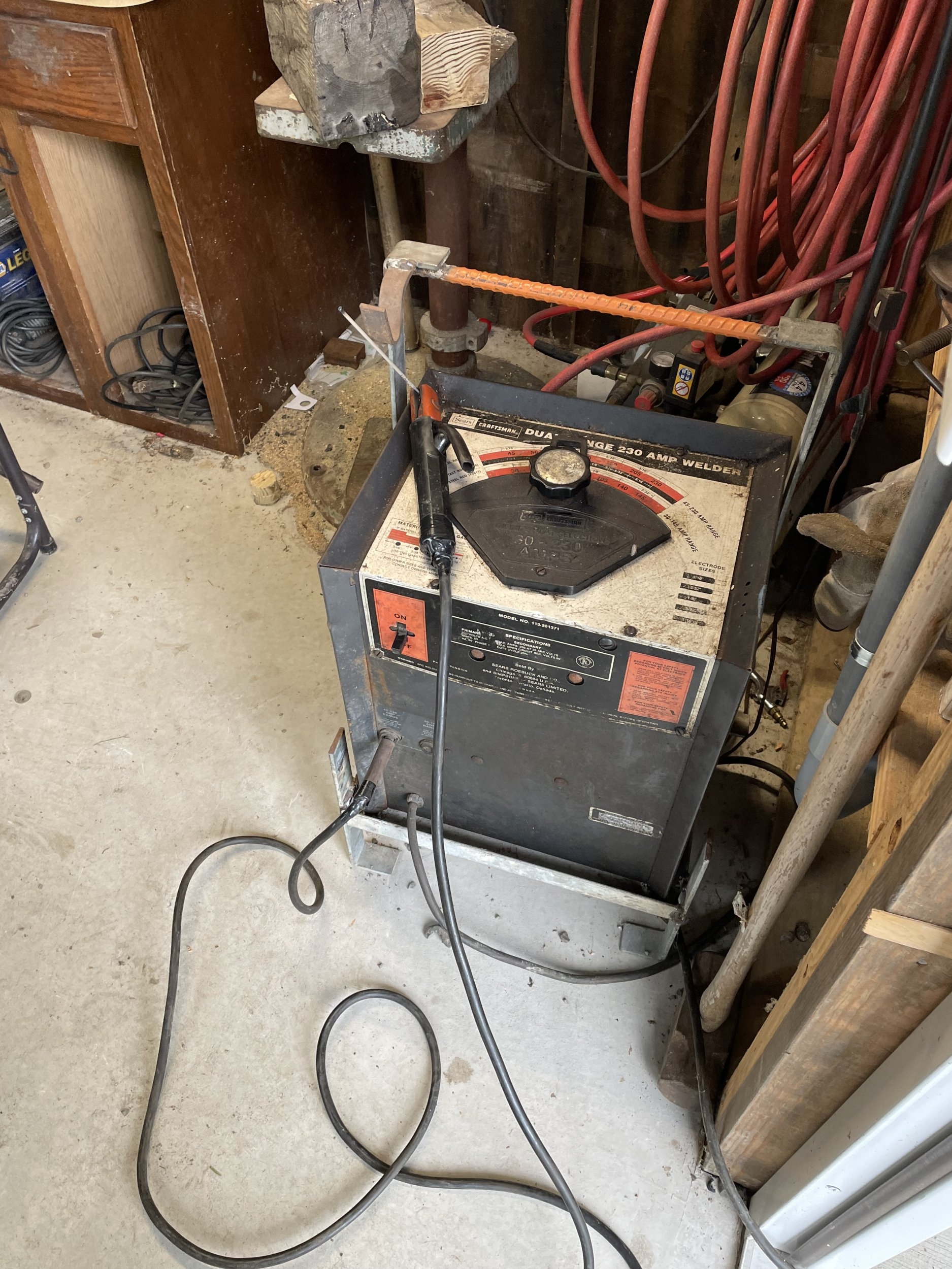

I wasn’t sure if I could fix it because I thought it could be cast iron. It must be cast steel or ductile iron because that 75 year old part welded up real nice. The repair took me less than 15 minutes.
I must have taken a turn too fast in 2nd gear with the plow. Years ago, I broke the original lower link on that side doing that. The one on there now came off of my Ford 2000. It was a little bent and I got a new Ford part for that one. The cheap aftermarket ones they sell at TSC are garbage.
I straightened the original bent one out on a press and use it still on my 8n. That’s a part that stayed the same thru many model changes.

You can make sweeping turns with ground-engaging implements, but sharp turns with the implement in the ground will break things on Ford Ns. Ford beefed up the upper lift arms with my model but I still lift plows, cultivators and disc harrows when making turns.

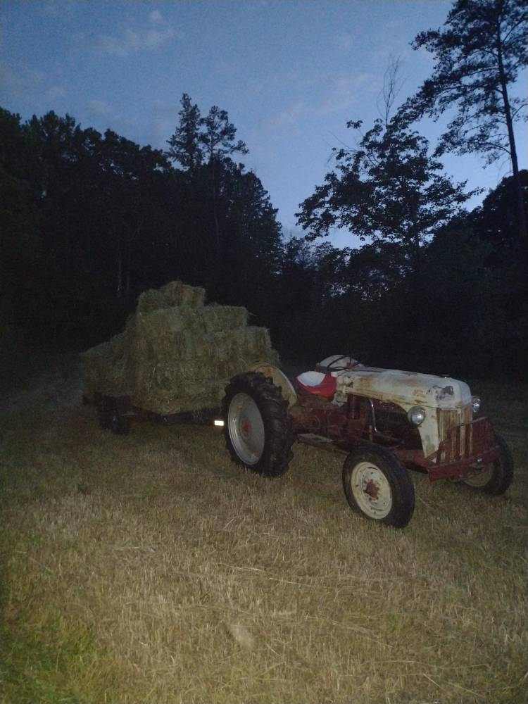

Gotta love the 8n. When I bought one I didn't think I would use it much but after having it a couple years I could not imagine my farm without it. I have a 6ft pull behind brush hog and it's my favorite mowing setup. I use it to tear up ground, get up hay and ask so much of it and it keeps going. You have a good looking tractor. I like the look of a working tractor and not a parade queen. If you look in the back of the picture with cultipacker to the right you can see my cow in mid head ram lol.
