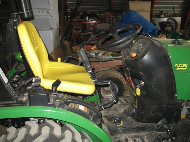

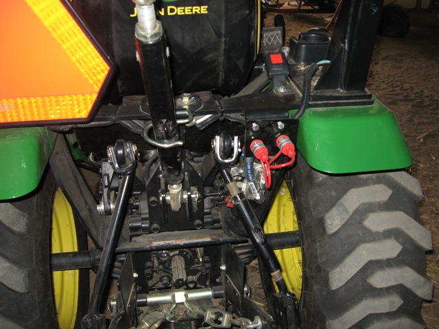

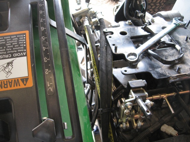

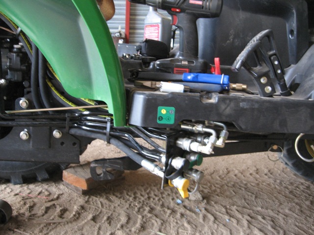

I added a set of hyd ports to the back of my 2320 so I could control a hyd top link or the hyd chute on my blower, raise and lower a scikle bar mower or any number of other tasks. Here are a few pics of the install. Total cost was a little over 800 cdn and it works like a charm.

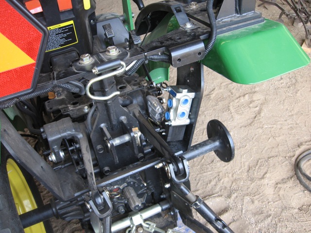

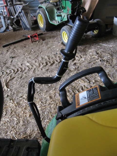

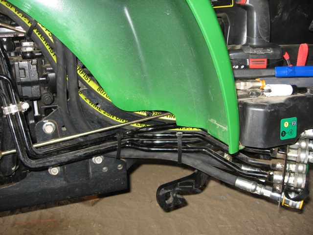

And a few more of the hyd lines and diverter.

Looks good! Why did you go the diverter route? You could have fit a solenoid operate spool valve in there and had independent control...I am just curious;)
   / My Electric Diverter
Not sure why I would want another spool vale to do what the existing one can via the diverter as it uses the dump/regen cct on the Dual SCV. This way I can if need be in the future possibly add the power beyond and outlets at the back to run a splitter or any other thing like a hyd motor on a bank mower or what have you and still have my electric control cct.
