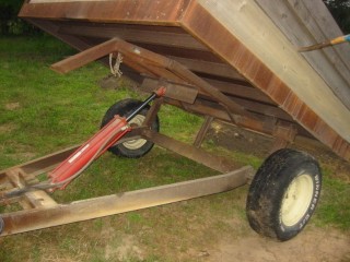

Here's my homemade dirt wagon. It used to be a spray tank carrier for a 110 gallon boom sprayer.
Needless to say, there's a lot more steel there now. New tongue and a-frame, new 6-lug stub axles and hubs scavenged from an auction, new 4x24 cylinder from TSC, new 8' by 8' steel bed, etc. I designed it and paid a welder for the steel and the labor.
Cost me about $1700 for everything but it's great for hauling dirt. It carries 6 buckets per load which I figure is 3-4 yards. It's heavy when it's loaded.
Notice - no springs. I have an older dump wagon that originally had mobile home springs and I kept breaking them. Now it has solid stub axles too.

Another view with the cylinder retracted part way.

Gabby,
That is a true example of ingenuity.. But, I would bet that other trailer did keep breaking axles... Figure dirt on average, weighs about 1-1/3 tons per cubic yard.. 4-5 yards of dirt would weigh about 10 thousand pounds..
Cool dirt hauler though. I may try to build something on a much much smaller scale..

Hey DT,
It sounds like the GMC truck bed does not already have a dump hoist? If that's the case, that dog probably won't hunt because you will spend more putting a hoist under it than it would cost to buy a junk dump truck and convert it to a tractor dump wagon.
If you could find a junk one with a decent dump bed, it should be pretty simple to run remote hoses to the dump cylinder and operate the dump.
On the other hand, you will have a heavy rig if you do this and it will require a big tractor to handle it.
Here's another idea - find an old cotton wagon or grain wagon or silage wagon and cut the front half off and make a dump wagon out of the rear half. Your axle and wheels are already there, as well as the bed if you're lucky. Make an A-frame from the hitch to the rear running gear like I did, and add a 24" cylinder like I did.
I've bought serviceable old farm wagons within the past year for $100 to $250 with no bed on them. A cylinder will be $200 or less at TSC plus about $40 for two hoses, plus you will have some steel and labor expense.
I paid a stiff labor charge to have mine built, and the sheet metal floor was expensive too. Luckily, it was before the ChiComs bid up the price of steel. My $1700 dirt wagon project would undoubtedly be well over $2000 today.
