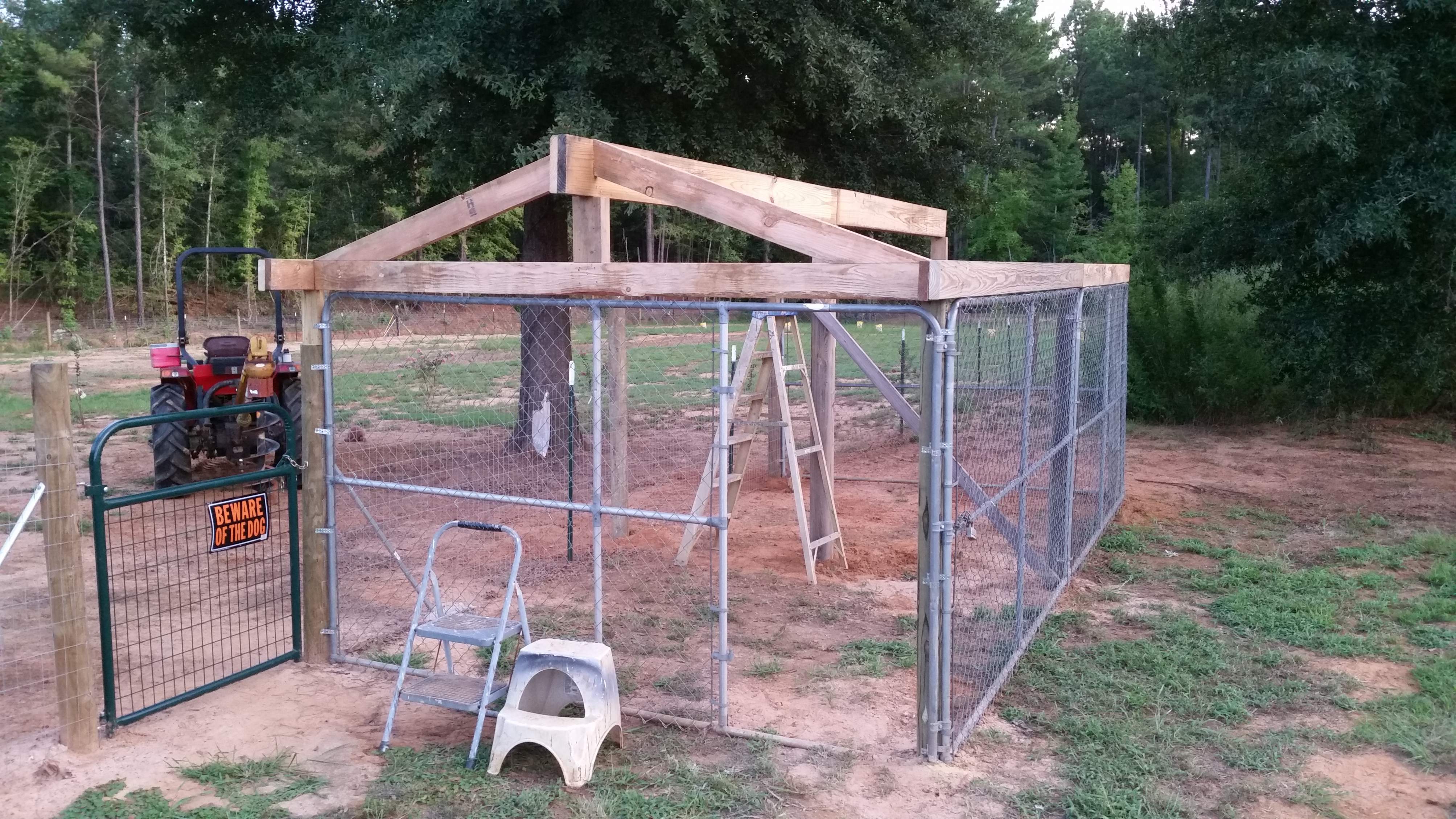

After a lot of research and probably too much thinking, we've started building our chicken coop. The reason for starting this is that we where given a dozen guinea fowl as a wedding gift from one of the nurses that works at the hospital with Karen. They are still pretty young and will need a safe place to stay for another month or two before we let them loose with the three we already have that roam freely.
Then we will start getting chickens and go from there.
A friend gave me a dog kennel a few years ago. She needed it to disappear, and I've had it leaning up against a tree ever since. The plan is to set posts at the corners and middle section. We are going to use the four panels for the front, two side sections and the back, then we will use our existing garden fence for the fourth wall. We will wrap the bottom three feet with 1/2 inch screen to keep the animals out. We might wrap the top half too, but for now, it's just going to be the bottom half. Then we will dig a trench under the wire and pour concrete up to and over the wire. The roof will be metal at a 4:12 pitch to match our house.
Here is what we got done yesterday.

To start, we are just planning on wrapping the bottom three feet in 1/4 galvanized mesh. Once that's on, we are going to dig a trench under the wire and pour concrete up to and just over the wire. Nothing will be able to get through it or under it.
The door is still where I need to do some thinking. Right now, I'm leaning towards a wood frame inside the door so when it closes, it's tight against the wood.
