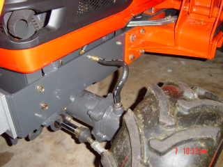

This is a picture of my frony axle vent on my BX22. I didn't get around to adding hose clamps because I am going to replace the rubber line with steel braided line.
Thanks for the idea bluecon1.
Jeff

This is a picture of the vent up under the hood.

I have heard on this forum that the front axle is prone to leaking at the seals even when the machine is relatively new. I have also heard that the one possible reason is due to the fact that the axle is not vented---(my dealer agrees with this). This makes sense because heat build up in the axle will cause pressure to build up in the housing. When that pressure gets high enough the fluid will leak out of the weakest point which is the seals. Granted, the machine would have to be worked pretty hard in 4wd for this to occur but I think it is certainly possible. Rather than taking a chance of leaky seals-- the vent was very easy to do and it certainly wont hurt the machine. Besides that, I was bored and needed something to do. /forums/images/graemlins/smile.gif /forums/images/graemlins/smile.gif

how does it release pressure while not allowing dirt to enter?
Are you using some sort of one way valve.

That assumes the axle is 100% filled with oil...isn't there some air in there? if the oil expands when hot, the air will compress. Is there a vent in the tranny, that gets even hotter? Also, since you now have a vent, you may want to put a filter or some mesh material over the vent port...just to prevent debris from entering (as someone else mentioned).

Don't *worry* about the potential for leakage. Just know that some of us have experienced oil leaking from the seals when the air pressure inside the front axle increases a few psi. The air pressure increases when the air temperature increases. This happens when the oil and air in the axle get warm.
The same thing can occur if the air pressure in the axle is cooled to winter temps and then the filler cap removed to equalize the pressure. If the ambient day temp warms the axle about 10 degrees, the seals may leak a little. That's what mine did in 30 degree weather in February this year. I checked the axle oil level at 20 degrees and then a week later I brought the tractor into the 30 degree garage for a couple of days. It was then the axle began to leak. As soon as I checked the oil level again, I heard air come out of the axle as the cap was removed, and the leak stopped.
Basically the leaking can occur on hot days or on cold days. What matters is the internal air pressure of the axle. If you see an axle leak, open the filler cap. That will equalize the pressure and the leak will/may stop.
To completely remove the potential for the "pressure created front axle oil leak" add a breather as shown in the photos above.

Nice job Jeff. The question was asked about filtering the vent, being that it looks like you installed the same kind of vent that I did. All I did was fold up some paper towel several times, and ti-wrap it to the vent. This thing doesn't need to breath alot of air, so it should be fine. I haven't any trouble since I vented mine.
Bellweather: there is a vent under the seat of the 2200........that was my next modification if Kubota hadn't done it from the factory. As others have mentioned, you just need to hear the gasp of air once when opening the dip stick on the front axle to realize the pressure that can build here. As Jeff mentioned, it doesn't take long to do this little mod.
