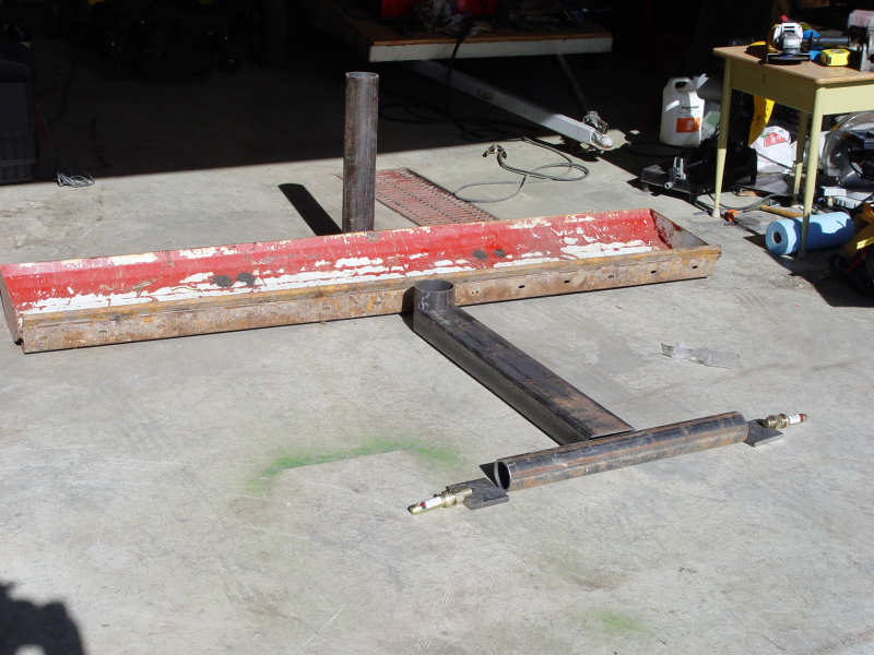

Here I've done a little bit of cutting and layed some of the pieces out to help me plan things out in my head. I had a general idea of what I was going to do but mainly made it up as I went along (my favorite way to do things).

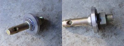

Normally I am a bit reluctant to hide bolts inside something where you can't get at them, but in this case I relented. The 3pt pins needed to stick out of the ends of a piece of round pipe and it just didn't seem right to cut open the pipe enough to get at the nuts. I made some round pieces of flat bar and bolted AND welded the pins in place. I also machined a small shoulder in the pieces, mainly to help hold them in place while I welded them on the ends of the pipe, but I think being slightly recessed into the pipe ends will also add some strength.

The main beam parts all stuck together. The horizontal pipe was fitted to the main beam the same was as the larger piece of pipe. Trace around the pipe where I wanted it and a bit of plasma cutter and angle grinder action. I also bevelled the edges of all the cutouts to leave a bit of a 'V' to weld into along the seam, hopefully creating a stronger weld.
