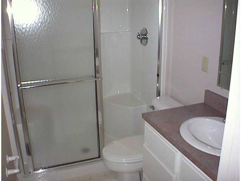

Here's a before pic just ta give ya an idea. 5' by 8'.

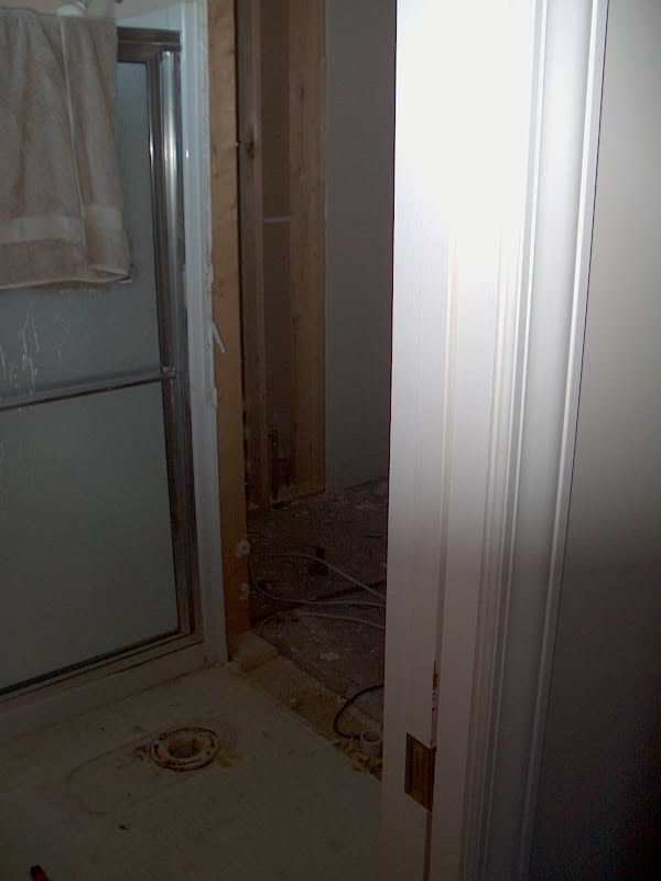

Tearin' out da wall, boss. A wet wall, by the way -- supply lines, pvc drains, GFI electric -- you get the picture.

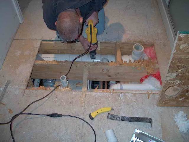

Here's one of my buddy cutting out the old crapper pipe.

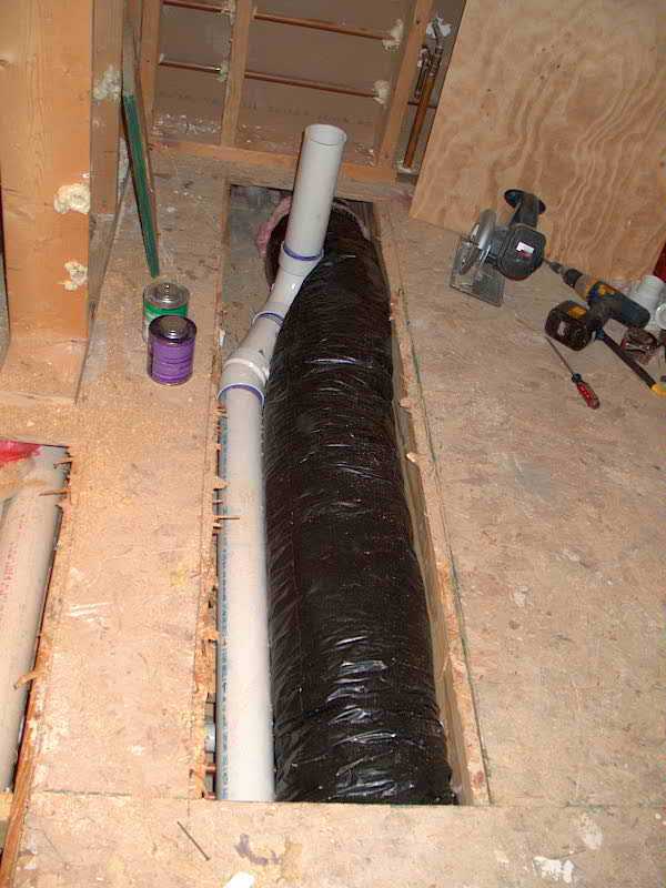

All was going well. We had the new commode line connected to the main line to the septic, but when we cut the hole for toilet flange ..... an 8" heating duct peaked up through the hole and said, "Na, Bubba, na." "Oh yeah?" we said, and cut the duct, replacing it with 8" flex duct and jogging the toilet line around it. Pic attached.

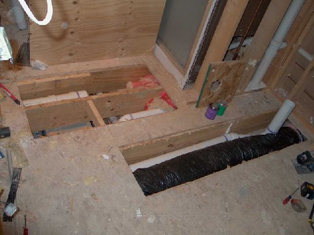

Here's a pic of both holes in the floor we had to cut out. It gives you a pretty good idea of the new toilet location and size of the new master.

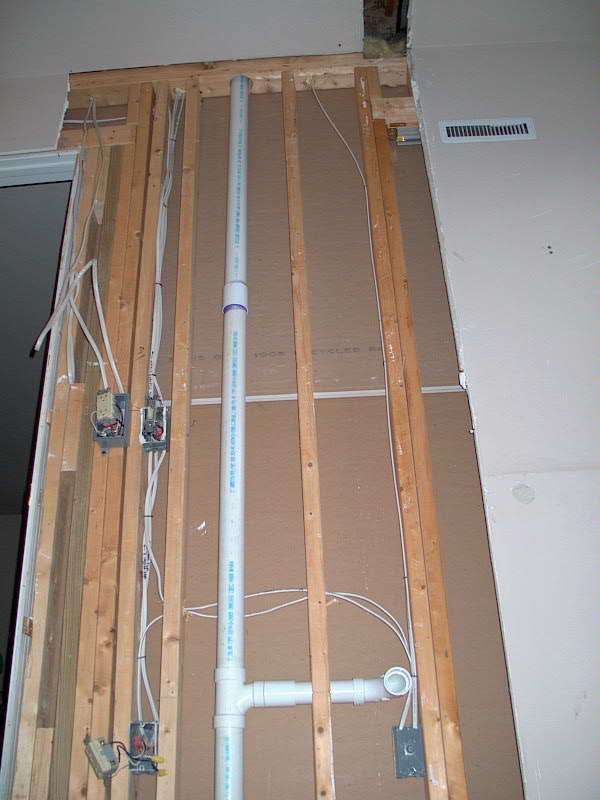

The new vanity drain and vent running into the attic. It also shows how far to the left in the picture the new bathroom will go compared to where the old wall was at the upper right of the pic.
"Why cut out all those holes in the floor when you could have just redone the plumbing from the basement?" you ask? Because stupid me had to finish the basement FIRST and that's where the basement bathroom is.
