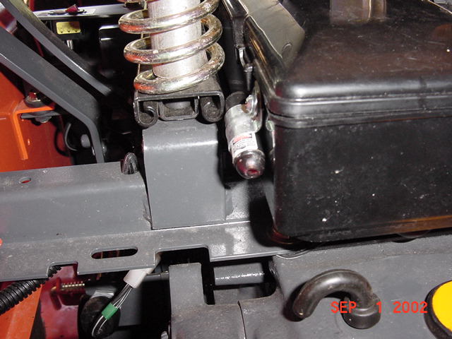

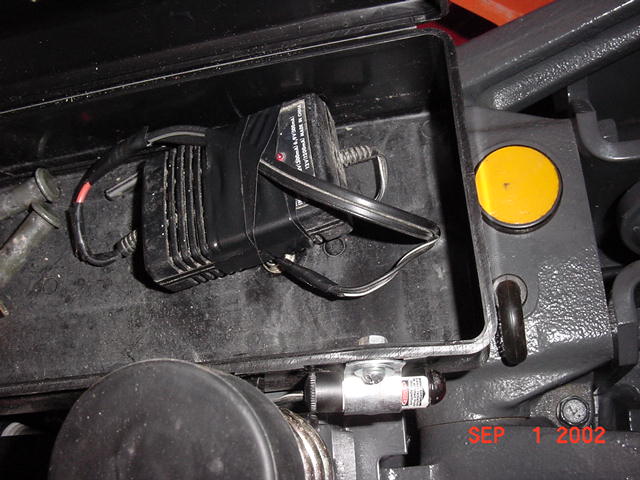

Here is my answer to pc. B7500's don't come with it, so I came up with this.
laser pointer - $10 @ Office Max
12v to 3v power supply - $8 @ Walmart
metal yard stick - $2 @ Walmart

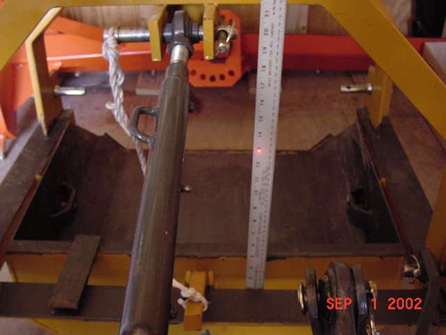

Basically, the laser spot hits the yard stick on the implement, and you can keep track of how high it is everytime. I do keep yard sticks on all my implements including one on a drawbar for watching the mmm.
Here is a picture of the power supply and laser pointer mounted in and on the tool box under the seat.

Here's another of the laser pointer.
   / My alternative to position control with pictures
Dirt scoop with metal yard stick showing laser spot.

Sorry, the last 2 pictures are reversed.
