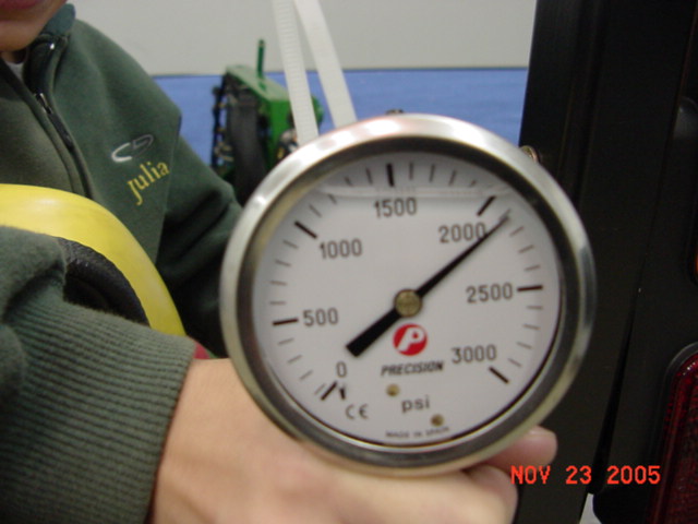

Did you check the relief valve pressure before and after?

I also have been considering this mod. Mine has trouble lifting a bucket load of damp sod.

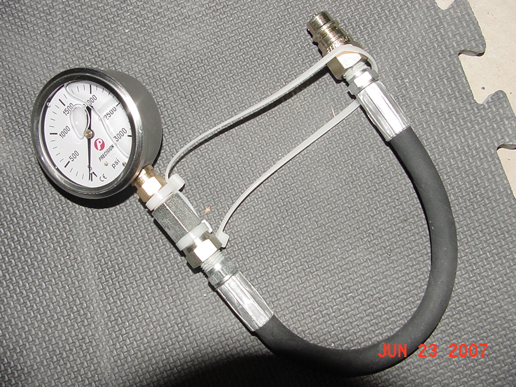

I'd like to check the pressure before and after the mod, but how can that be done easily. I have seen 0-5000 psi hydraulic gages in the internet for about $20. It has a pipe thread on it and would need to be adapted somehow to a fitting that would interface to the tractor. Has anyone done this? Would you put a male QD on the gage and plug it into one of the loader ports?
   / My 790/300 loader capacity in now great! #4
I have done it, and written about it many times...
Get a gauge, a short hose (mine is 12", but I would do 24" next time) and a QD nipple that fits into one of you loader ports (I got mine from JD) I bought all my parts from the SurplusCenter
Now, just plug the gauge into one of the QD ports, then move the joystick to energize that port-the system will go into relief and you will see what the valve is set at on the gauge. Only hold the joystick for a few seconds at a time though, the fluid can heat up rapidly when the system is in relief.
Hope this helps...

   / My 790/300 loader capacity in now great! #5
Hope this helps...
Thanks for the info... I'm making one.
