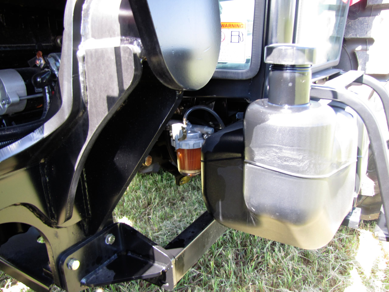

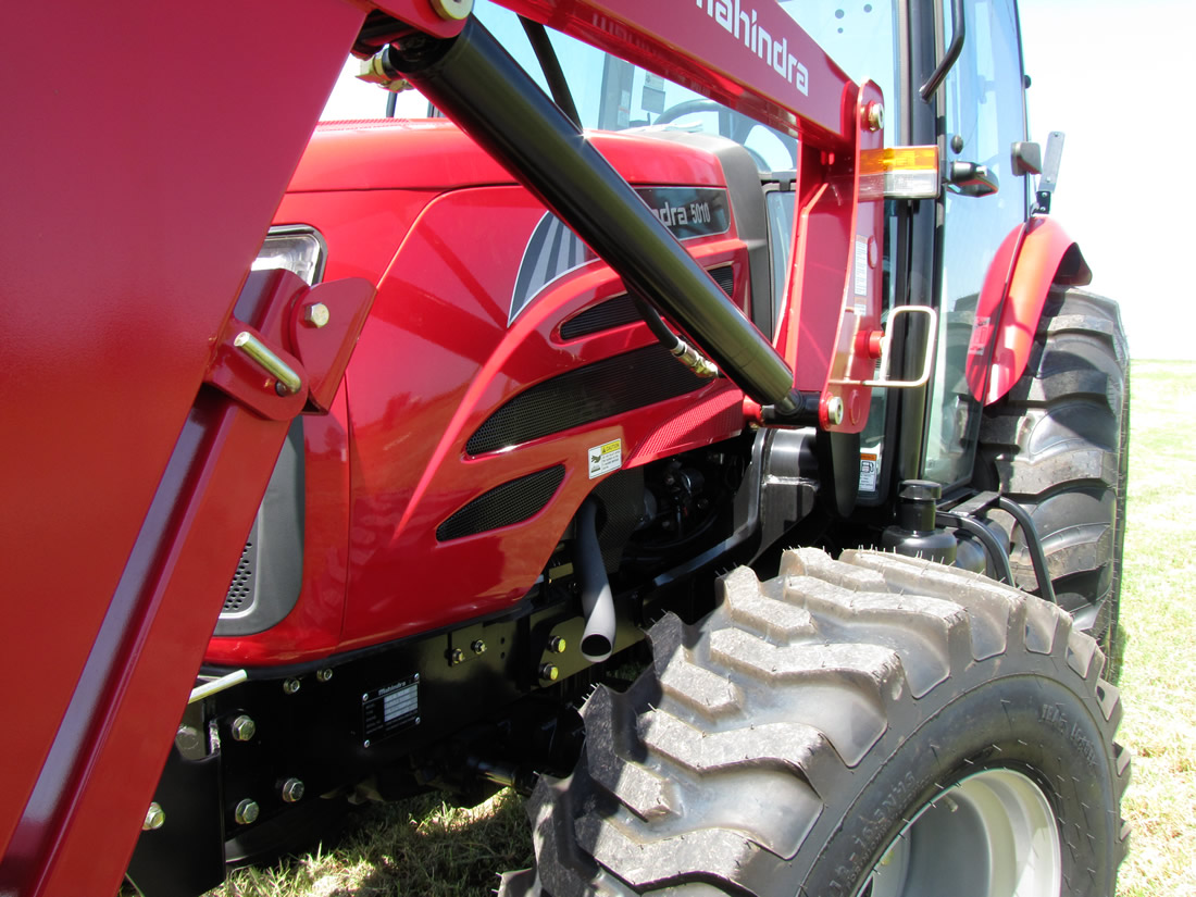

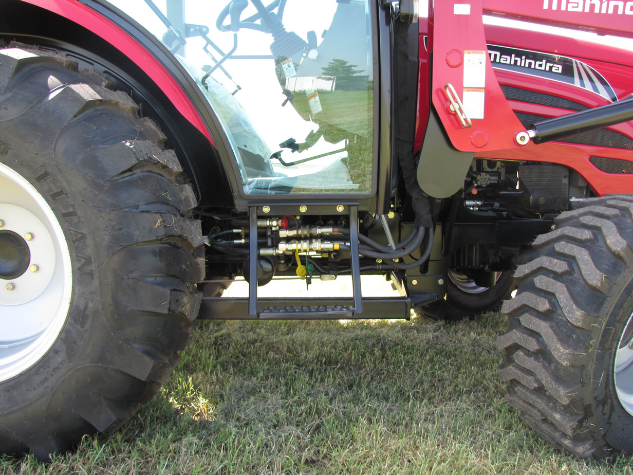

Looking over the exterior of the tractor you can really see that the wires and hoses and cables have been very well thought out. Hoses are not rubbing on stuff, wires are all in loom and routed like there was a plan. I had an opportunity to check out a YTO tractor a few years ago and the first thing I noticed was all of the hoses and wires running all over the place. Hoses were rubbing on sharp edges, wires were stretched banjo tight to reach sensors, wires were rubbing on sharp sheet metal and hot exhaust components. That thing was going to be a maintenance nightmare in no time. The 5010 is very well thought out.

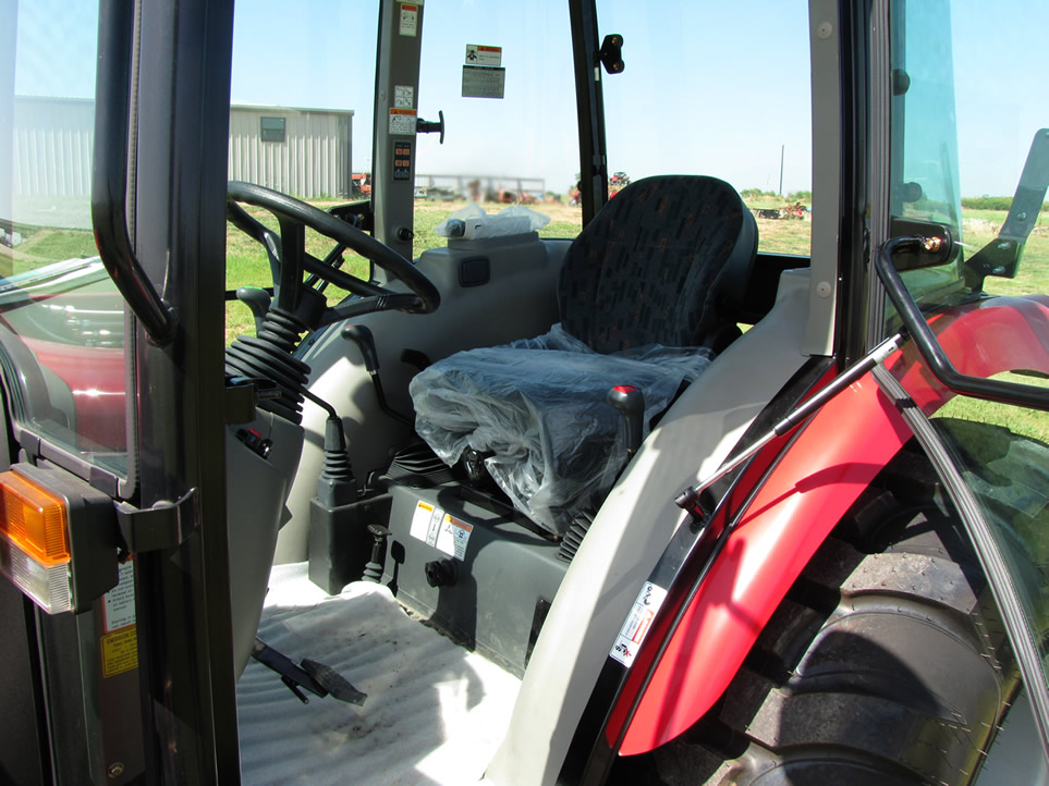

The 5010's doors shut nicely with a solid thud. You do have to slam them a little harder than I feel comfortable slamming a 100% glass door but I'm sure it is fine. Once the weatherstripping has a chance to wear a little it will probably get easier. I am nervous about opening the door on a windy day though. We had a Deutz that had an all glass door and it got broke two days in a row when it was windy. I think it was about a $500 door if I remember right. The 5010's door's damper does seem adequate so it might not be a problem. Time will tell.
The grille guard is nicely designed to pivot forward to open the hood. No tools required either. I have having to unbolt a grille guard to open a hood! Once the hood is open the air filter is right there easy to get to which is nice. The battery is easily accessible too.
The seat appears very well made. The suspension mechanism, once adjusted correctly, is really just for the bigger bumps. Don't expect an air ride style cushion. Visibility is great! Lots of curved glass that I'm sure will me cost a fortune to replace when my 8 year old tries to shoot a bird off the cab with his BB gun.

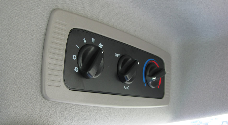

The A/C is very cold. It was 100 degrees today when I started it and the cab cooled down very quickly. I did not ever turn the A/C down but I never wished it was a little cooler either.
The plastic parts are the nice high quality durable feeling plastic- not that shiny cheap brittle looking junk. Even things like the plastic fuel cap are surprisingly heavy and very solid. The fuel tank includes a built in removable screen which is nice.

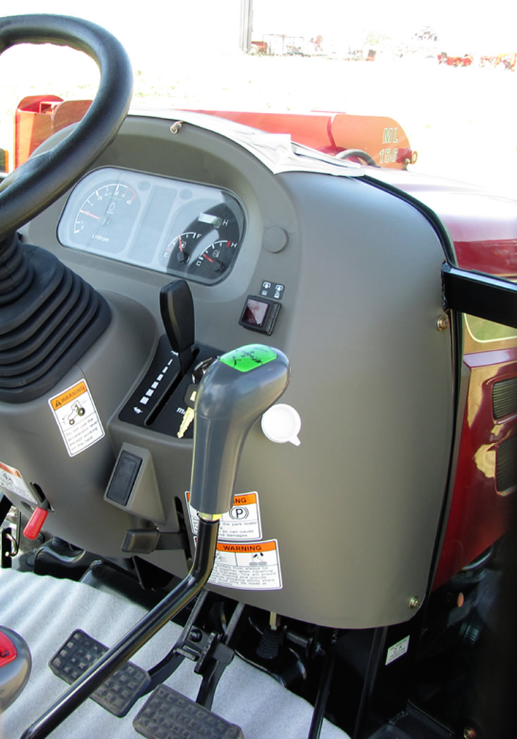

The operation manual says there is an automatic PTO switch that mine does not have. The PTO is either on or off. No way to have it automatically disengage when the clutch is depressed which would have been nice. The PTO button is not in the ideal position for the "Oh crap I just mowed over a 50,000 foot roll of bale twine" type panic stops. I might either move the button up on the right fender or make a second e-stop style switch for easier access. Or... I might just get used to it where it is.

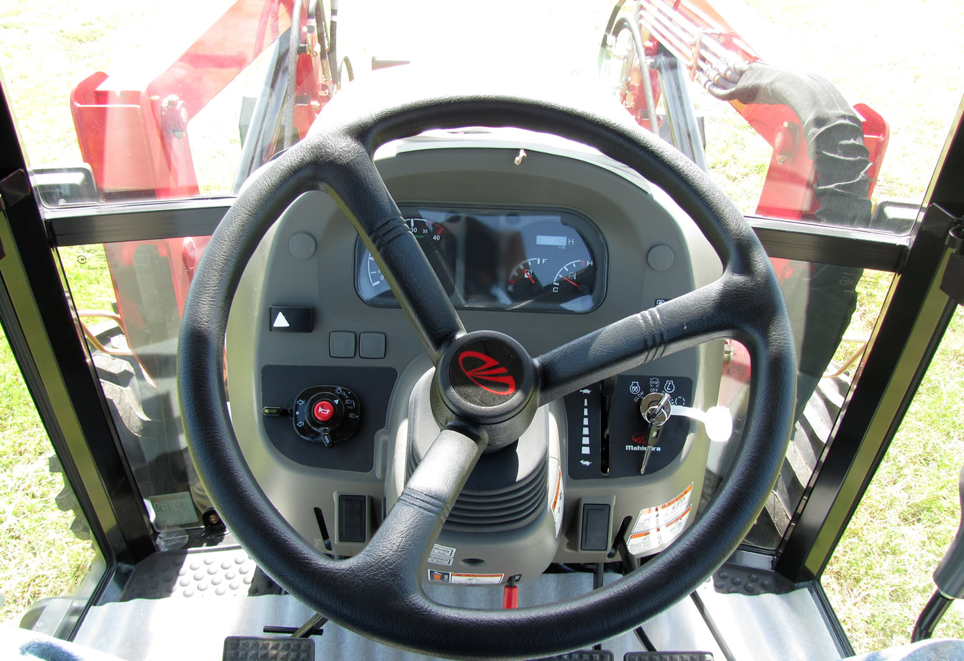

The steering is tight and perfect. Not too light and not too hard and no free travel to speak of. In road gear it tracks nice and straight. You don't have to work to keep it between the lines. In the field it turns with very little effort.
The transmission shifts like butter. No problems there. The clutch is light and engages just like you'd expect. There was never any of those times when you though " I'm going to have to get used to this". Everything works just like it should.
The loader joystick has a fair amount of play before anything moves but is very smooth and controlling the loader was very easy. I like the built in bucket level indicator. I've never had one that worked and this one works very nice and is not in the way.

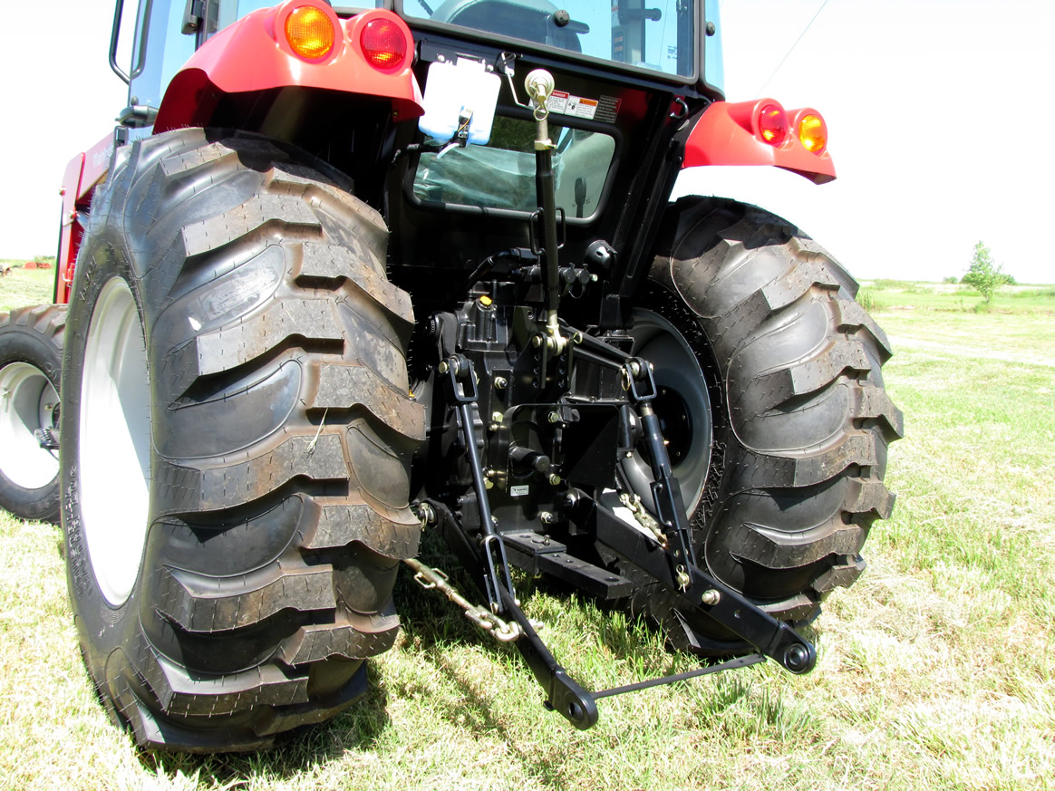

Overall I'm really liking the tractor and think I made the right choice. My only real problem so far (I know... its only been 45 minutes) is a rear axle seal that is very slowly dripping. My hope is that once it starts getting used it will soften up and seal again.
