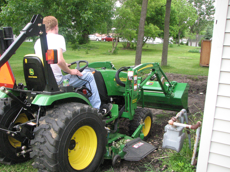

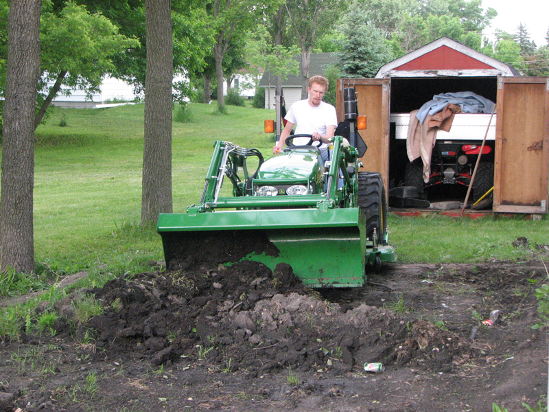

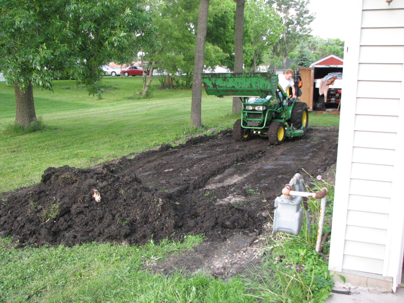

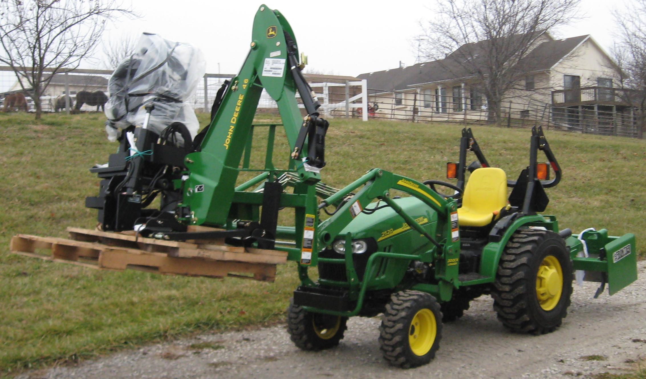

Hey everyone got some action shots for you guys.
Yes I know my ROPS are down. too many low trees to have them up.
I leanred a lesson though.
Don't play in the dirt with the mower deck on. because it's a paint to clean when your done. reason i had it on was for weight. the black dirt was HEAVY and i could feel the tail getting floaty when i went to dump. need to get a ballist box asap.
What i'm trying to go in these pictures is dig that whole area down 3 inches for gravel. and i've boardered it with Railroad tie.
It's 16X48 when i'm finish.
i'm going to have a big pile of dirt when i'm done. the pictures only show half of the area i'm working on. going to put up a 15X20 building there to keep the ATV and tractor in and rip down that ugly red on.

Good pictures!
BUT, Get a Ballast Box and a I-Match faster than ASAP before you tear that MMM up, or overload the front axle and break something. Why some dealers do not include this if the tires are not loaded is crazy! My dealer will NOT sell a FEL without one or the other.
Also, trim the trees and get that ROPS up!

I agree the Imatch and Ballist are a must. i'm going to call the dealer today and get them ordered.
How will it harm the axle? the weight amount it about the same with or without tail weight isn't it. because the pressure from the bucket is the same. the area i'm working in is very small and i'm in L going maybe 1/2mph in there so i'm going very slow and only half loading the buck to keep the weight down.
I'm been kinda bugged he didn't tell me to get the ballist right away.
But I agree from now on the MMM comes off. I spent 3 hours cleaning it when i finshed no damange to it thanks to how slow i was going but i don't like it dirty like that.

Raptor, by using ballast behind the rear wheels, you are reducing the load on the front wheels (filling your tires doesn't have this affect, but it does make you less likely to tip over forward and makes the tractor more stable). The load in the bucket is the same with or without the rear ballast, this is correct, but the resultant load on the front tires does change when you add the rear ballast. Here's a good way to get the point....I'm assuming you have towed a trailer before? If you've got enough tongue weight, you'll notice that the front of your tow vehicle gets light, and tends to wander a bit more than usual. That is because you're adding weight to the rear and reducing the down force on your front tires. Same applies to adding rear ballast to a tractor.
You haven't done any damage in the short time you've used your tractor (it'd take a long time to do that), it is just less wear and tear on the front end by ballasting the rear.
Just my opinion, but I'd get your tires filled and use rear ballast. Unless you've got super soft lawn, the filled tires shouldn't cause much if any damage. I use my 2520 to mow (in addition to dirt work) and it leaves no marks on the lawn what so ever. In fact, the wheels on my finish mower leave more marks.
