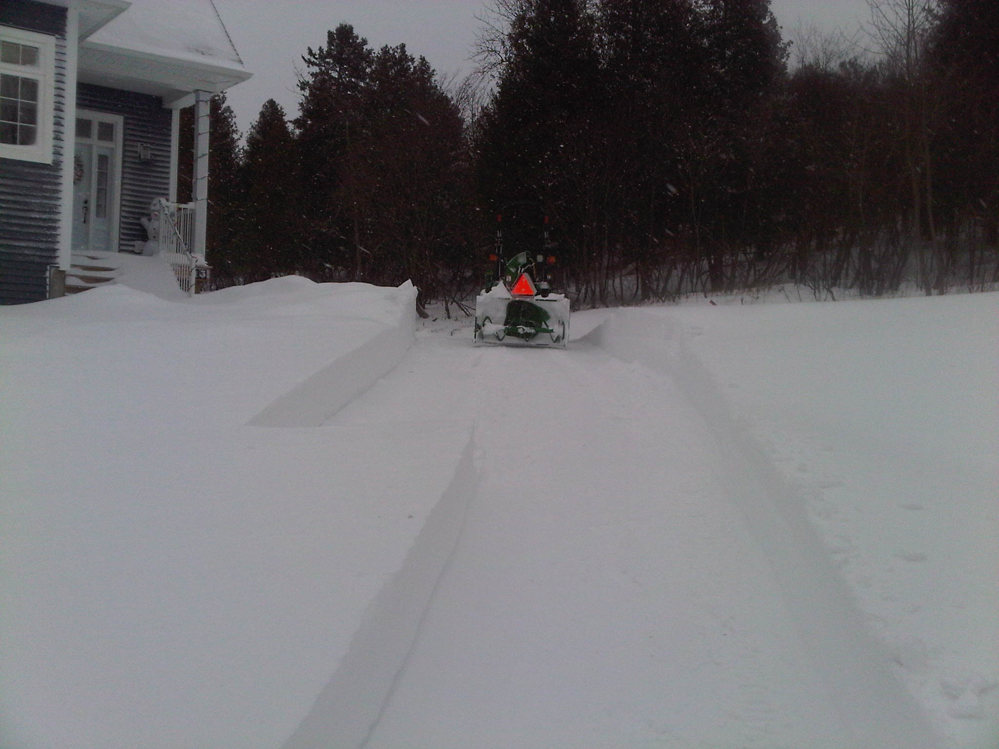

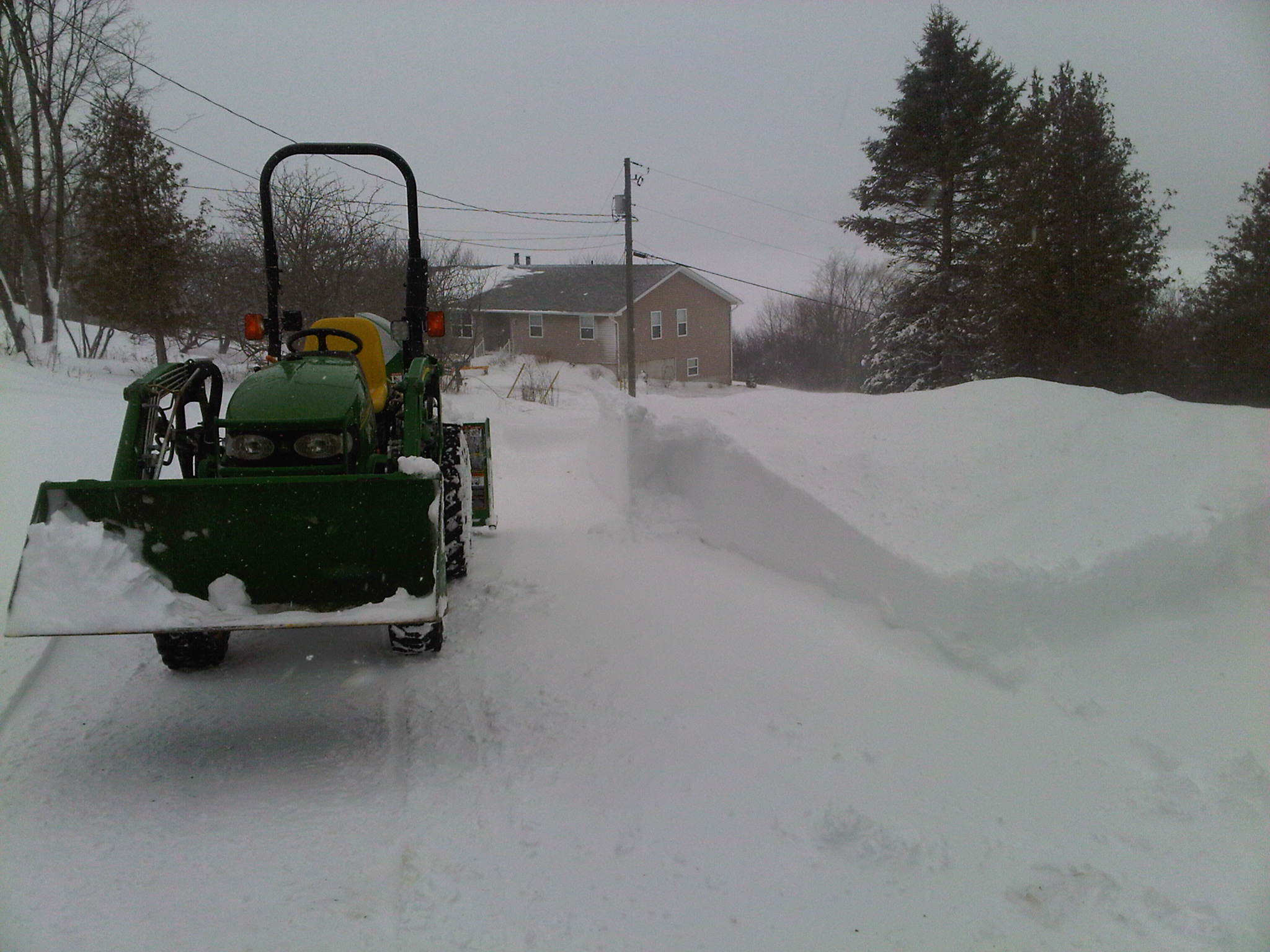

BTW,
Here is a picture of the last snow.... IMG-20121230-00640.jpgIMG-20121230-00639.jpg
