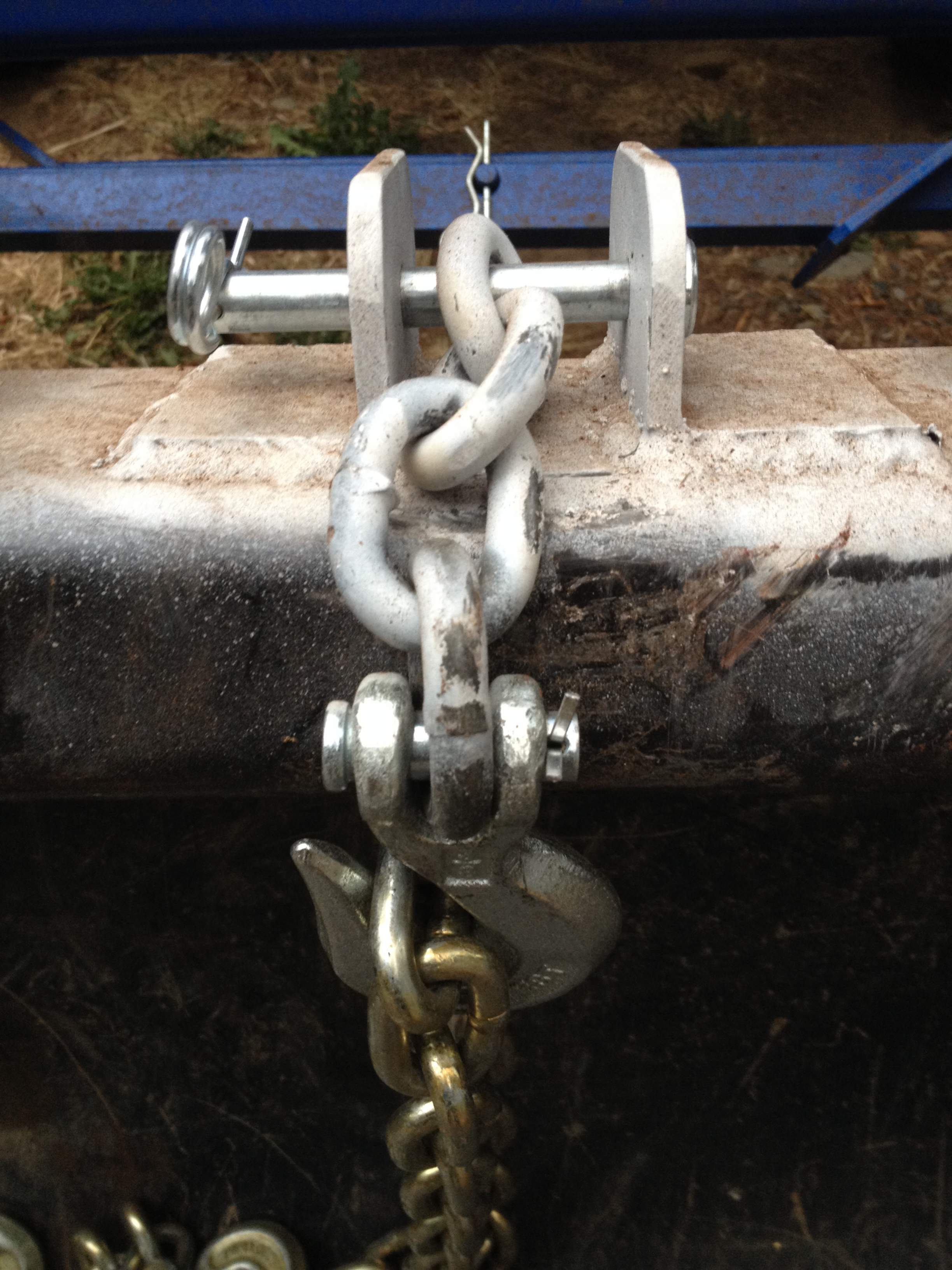

5) I welded a lifting lug to the bucket to hook a chain to drag logs. It only had an edge across top of bucket to put a hook on, not a good method.

Have you looked at Kens bolt on hooks? He is a vendor on here and has the hooks for the different type of front end loaders. Neat stuff on there.
Ken's Bolt on Grab Hooks <<Bolt-On>>

"I welded a lifting lug onto the bucket" You pretty much have to do this. I don't know why hooks aren't standard on buckets as they all have them added by owners. Lawyers I suppose.

The best way to add hooks on the top of pretty much every bucket from every Mfg would be to first weld on a reinforcement piece, then weld the hooks to that... Most bucket tops are thin.
