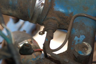

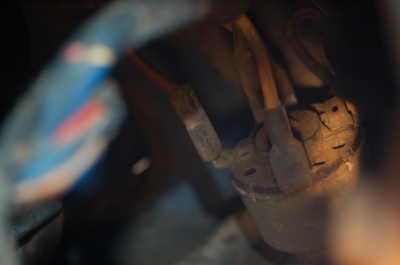

I gave my tractor the once over yesterday and found a red wire that goes from the ignition switch to what appears to be a solenoid, which I image is the glow plug, in the intake manifold.
It was disconnected at the manifold end.
My plan today is to remove the glow plug and reconnect the wire and turn the key to see if it’s doing its job.
At this point this would explain why it started when I first bought it.
   / My 1973 Ford 2000 won't start again. #9
post a pic of the part you intend to remove and hook a wire to and then think it might do something.
One photo depicts the plug under the Glow Plug (?) in the intake manifold and the other photo shows that the wire goes to the ignition switch (Red wire on the left side of the switch.
