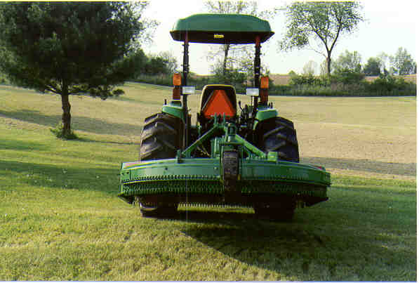

What price is a good one for a MX6, by itself?
I know there will be a lashing from the good members, here, but my dealer wants me to try one. For pasture cutting, loader on, he thinks it'd be great.

Do not do it on a 4310. I use one with a 4710 & it is light on the front end with the loader on. I hooked it up to the tractor once without the loader on. With the cutter raised I could push down on the cutter & raise the front wheels of the tractor off the ground. If do decide to try it, do not use the top link so the tail wheel is always on the ground. I paid $1,800 for my MX6.

I paid $1,800 for my MX6. See attached.
...Bob

You and your dealer need to check the JD website. The MX6 is not recommended for the 4310.
How are the Rhino/Bush hog/Woods not comparable...Besides price and color?
   / MX6 Price
#9
OK, we know Deere doesn't recommend it. It is specified for a slightly higher hp. But I will be using it to maintain a pasture, not cut brush. The real issue is the weight. But I will cut with my loader on, and essentially use it as a pull type, not 3point. And still, I am TRYING it, I know it might not work out.
