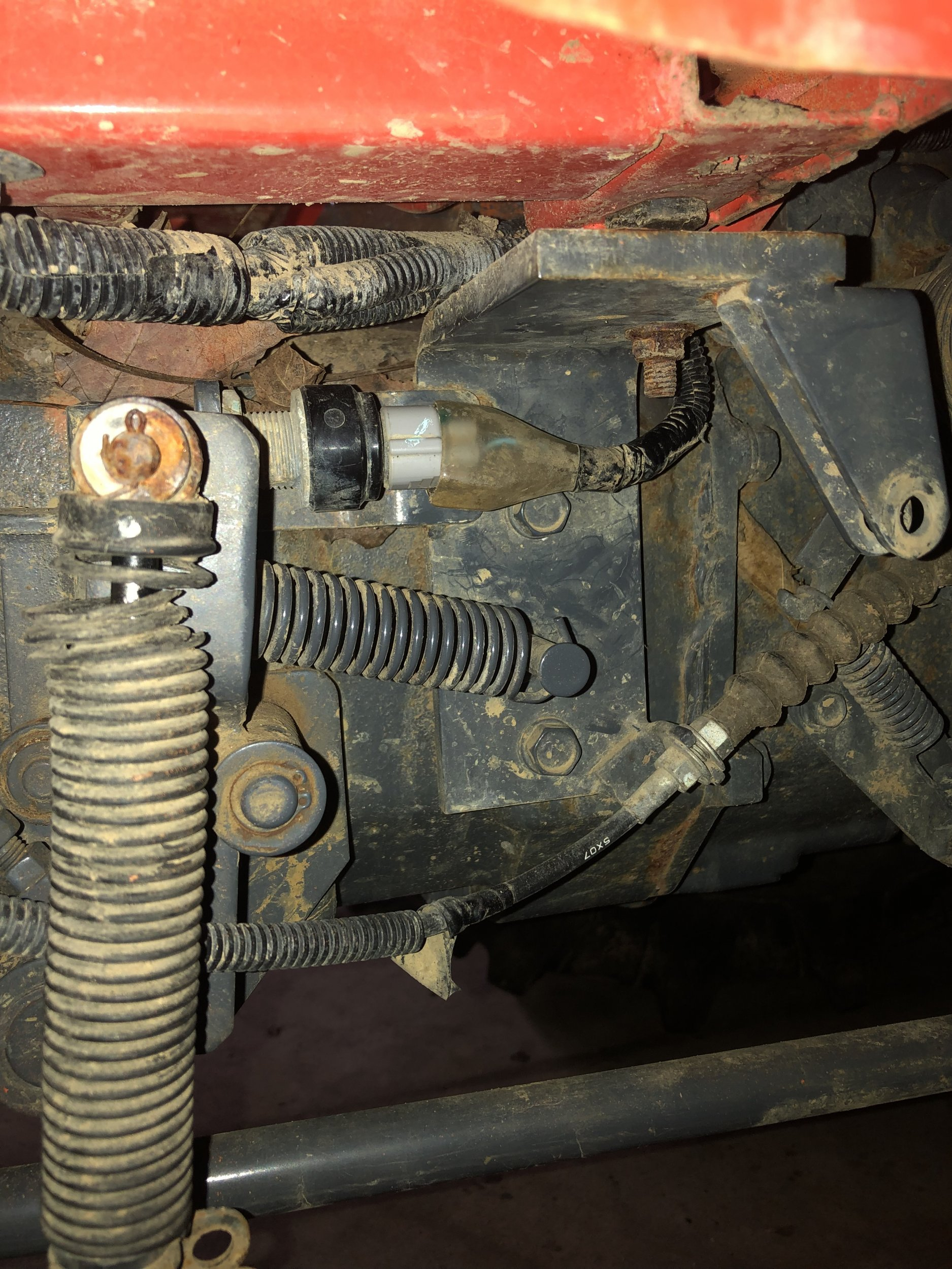

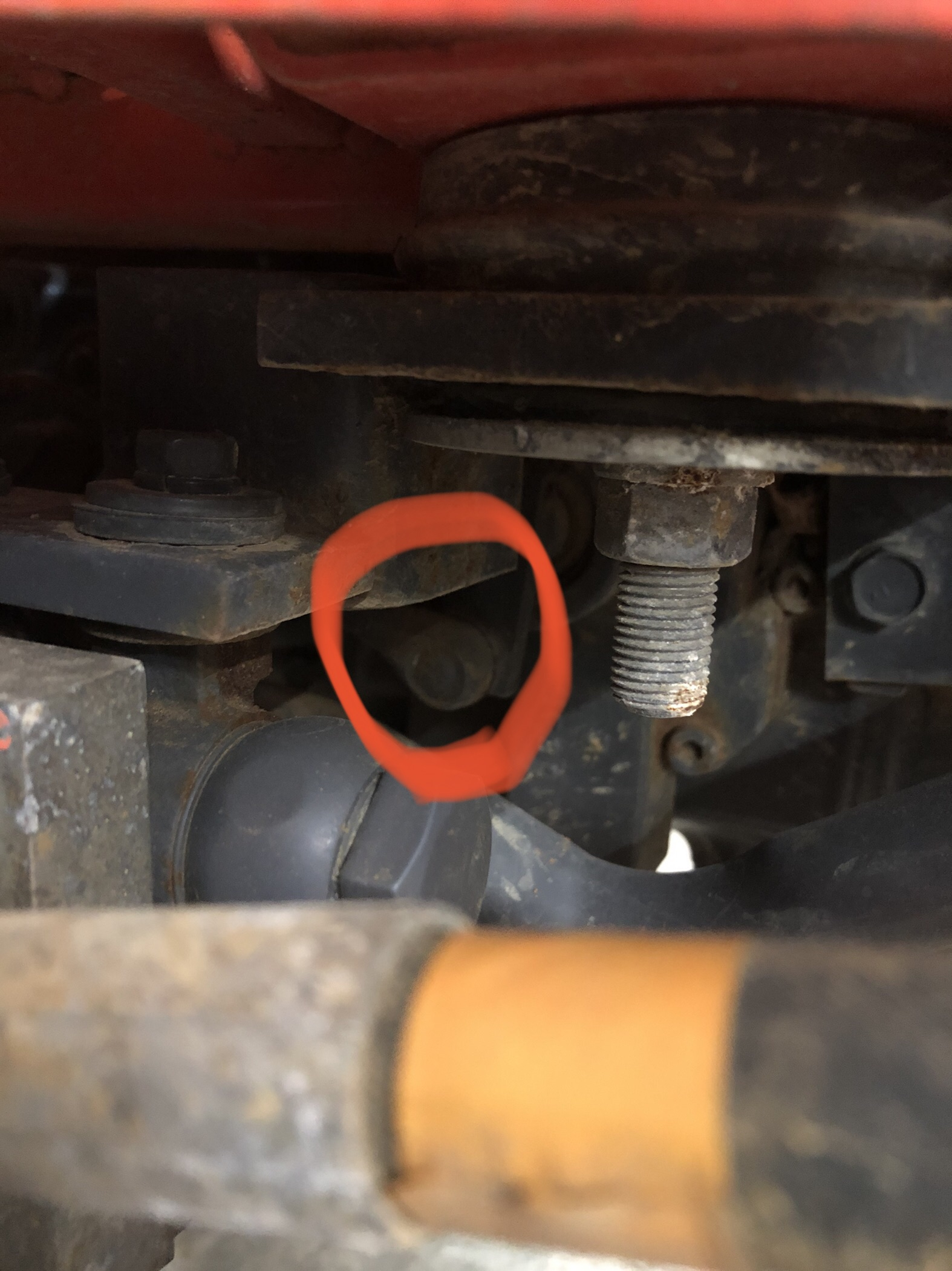

here are the safeties and linkage from treadle (red circle)
