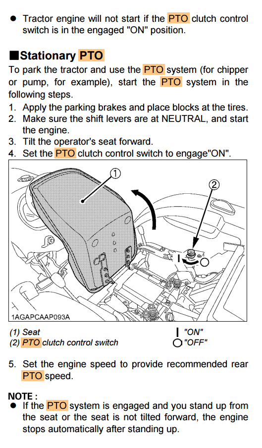

Is this the sequence you have to use the PTO if your not in the seat:

Thanks for the PTO sequence diagram. The thing is with this tractor we've always been able to simply start the tractor and then the PTO standing next to it. No parking brake needed. No flipping the seat forward. We run both a feed grinder and a hay bale elevator from the PTO. The tractor was purchased used and there is no sign anyone bypassed any safety features.
I hope it isn't the ECU because it ain't cheap. That's for sure.

That sure does seem strange that something has changed with how you used to be able to operate your PTO and especially now you can not move the tractor without it shutting off.

Is there any sensor/switch that lets the tractor know that the seat is flipped up as is described in the PTO sequence?
