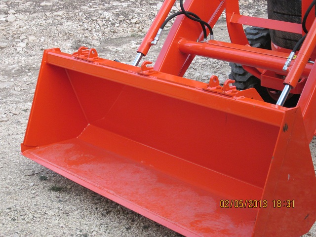

So I see a lot of people recommending the Ken's Bolt On Grab Hooks for the bucket. I'm looking at installing 2 of the bolt on (not welded) grab hooks on my MX5800 roughly in-line w/ the loader lift arms (from what everyone says). I'm running 5/16" G70 chain, which grab hooks should I get? I've also seen some that put a shackle or another grab hook in the center of the bucket, good idea or no?
   / MX5800 bucket grab hooks #2
5/16" grab hooks hold 3/8", 5/16" and 1/4" chain securely; all the spread in chain diameter you can wish for.

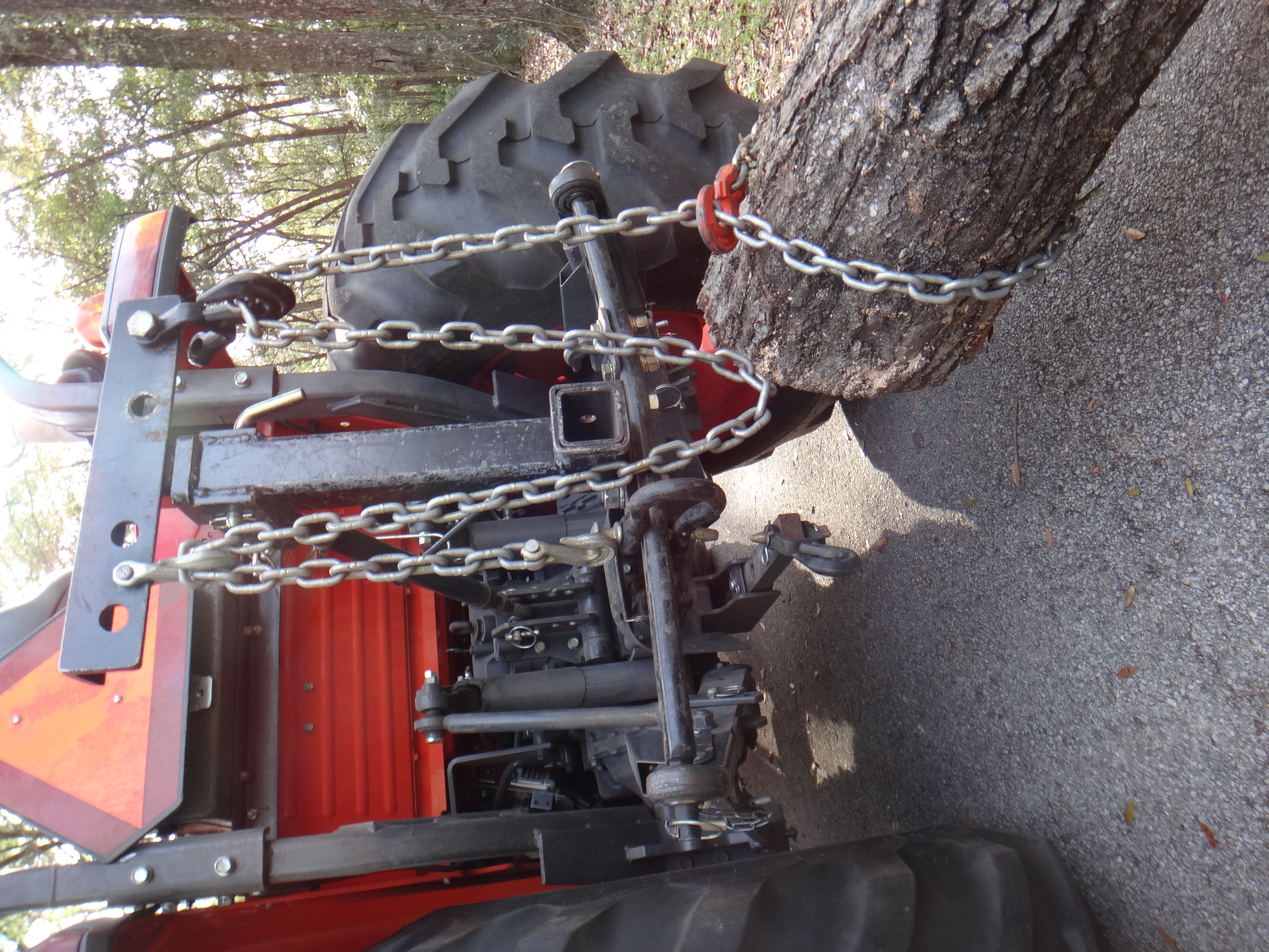

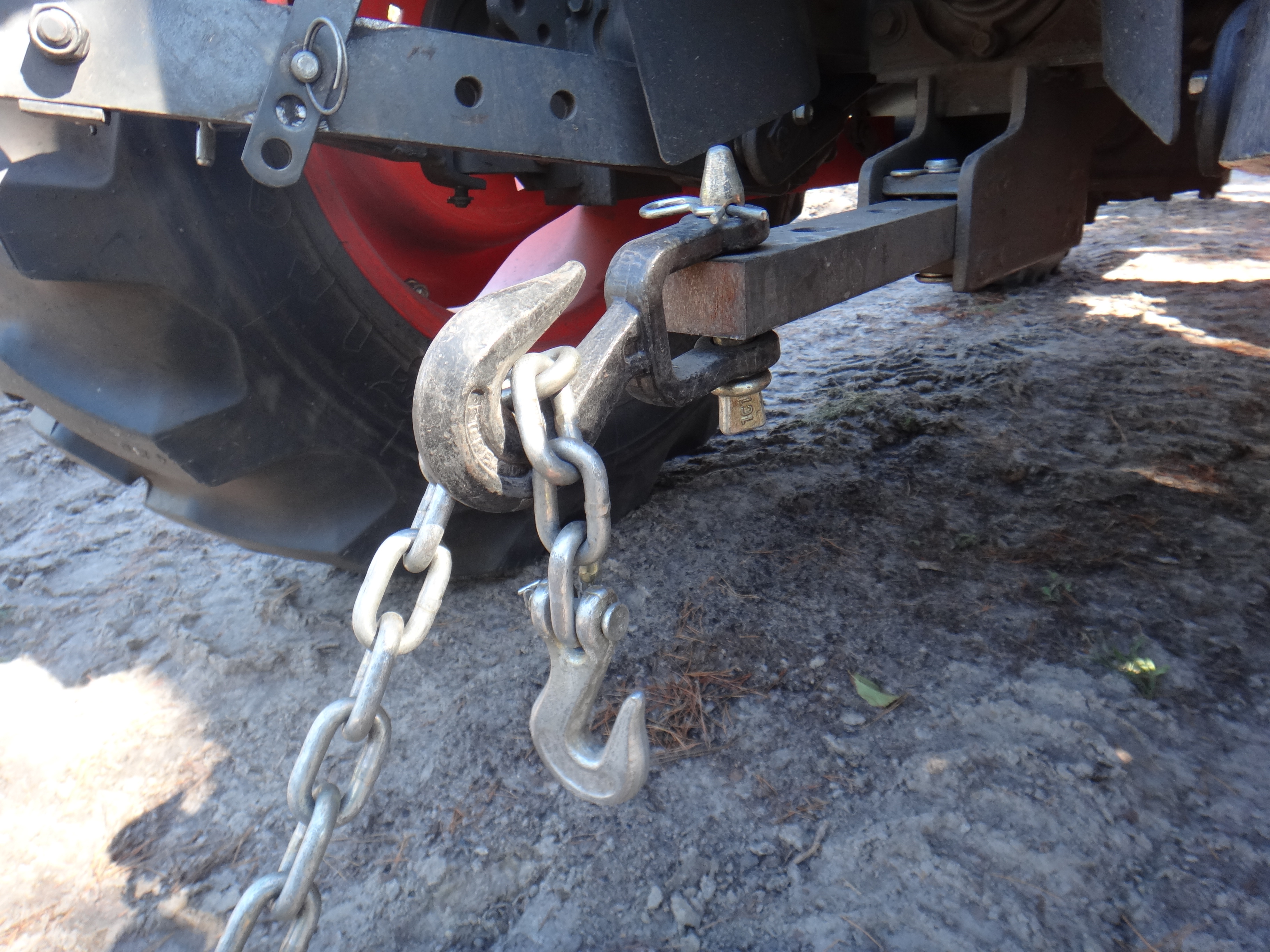

You do not want to put too much strain on the FEL, operating the tractor in reverse. Get a clevis grab hook for your rear/center drawbar. TSC is a good source. The rear/center Drawbar is designed to PULL.

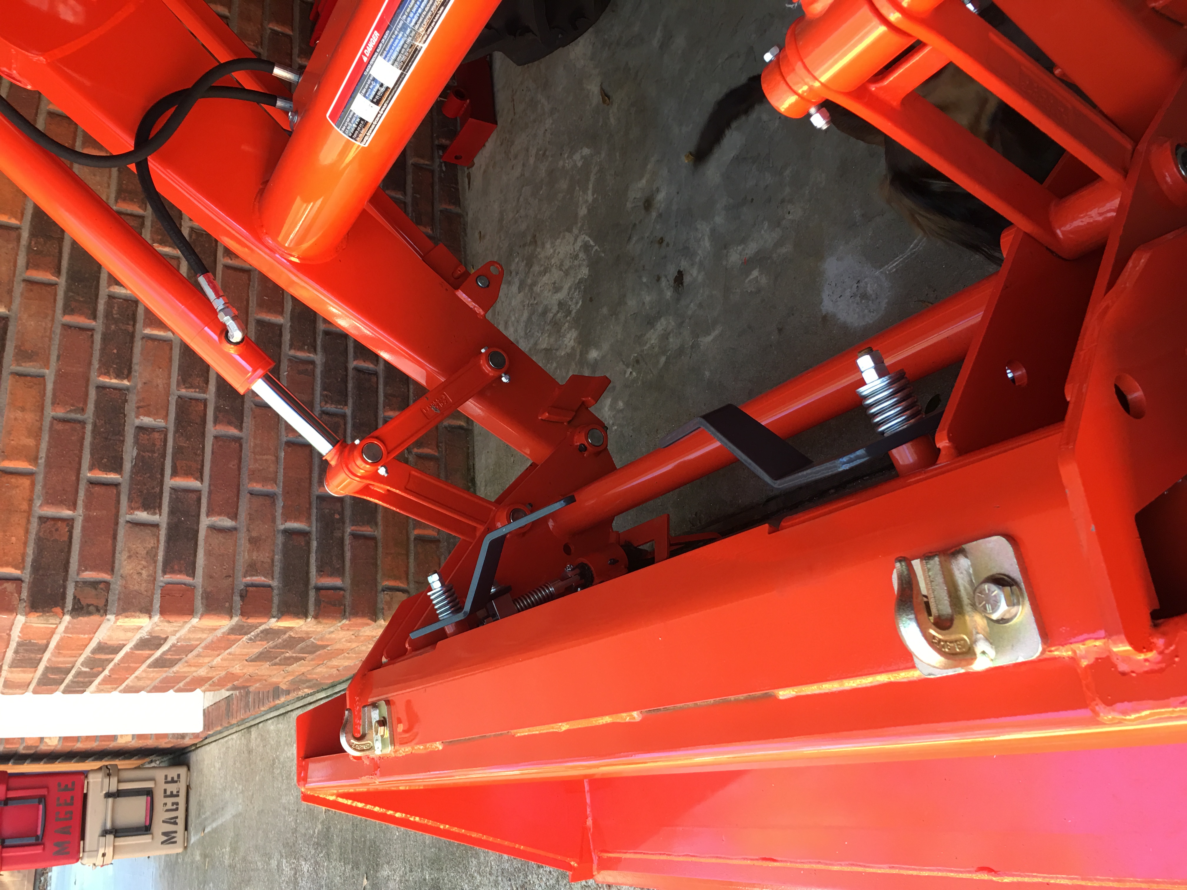

I had a center clevis in addition to two grab hooks on my former B3300SU. Seldom used the center mount much; I took it off.

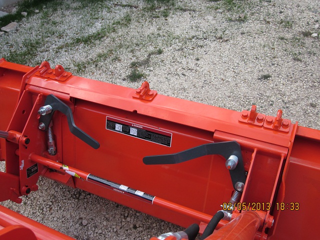

Those buckets hols the Bolt-On hooks and Clevis Mounts nicely:
   / MX5800 bucket grab hooks #5
As noted, hooks on the bucket are really just for lifting and, once in a blue moon, lighter pulling. Centered over the lift arms on the bucket is the best idea and bolted or welding to a piece of plate steel that is welding to the bucket makes it stronger. That plate in the shape of a "fishplate" makes it stronger for higher HP applications. Search my screen name for pictures or details on my Deere 5520 for more.
I hook a chain between my two hooks, keeping it pretty tight, and hook a short chain in the center of it to lift with. That way the load is borne by the two hooks and is better supported. One hook in the middle is nice for light things but my two hooks and chain does the same thing and I don't have to worry about bending the bucket at it's weakest point. We've all seen bent buckets and they are not easy to un-bend.
