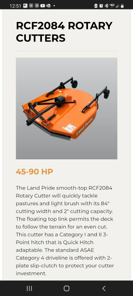

   / MX5400. What brush cutter size? 60" or 72"? #8
I have a 2084 landpride behind our old m5400 and I am really happy how it handles and definitely wouldn't want anything lighter or smaller doing similar stuff. The one I have only has single rear wheel.
So go heavy and at least 72 wide with slip clutch. You won't regret it once you write the check.
