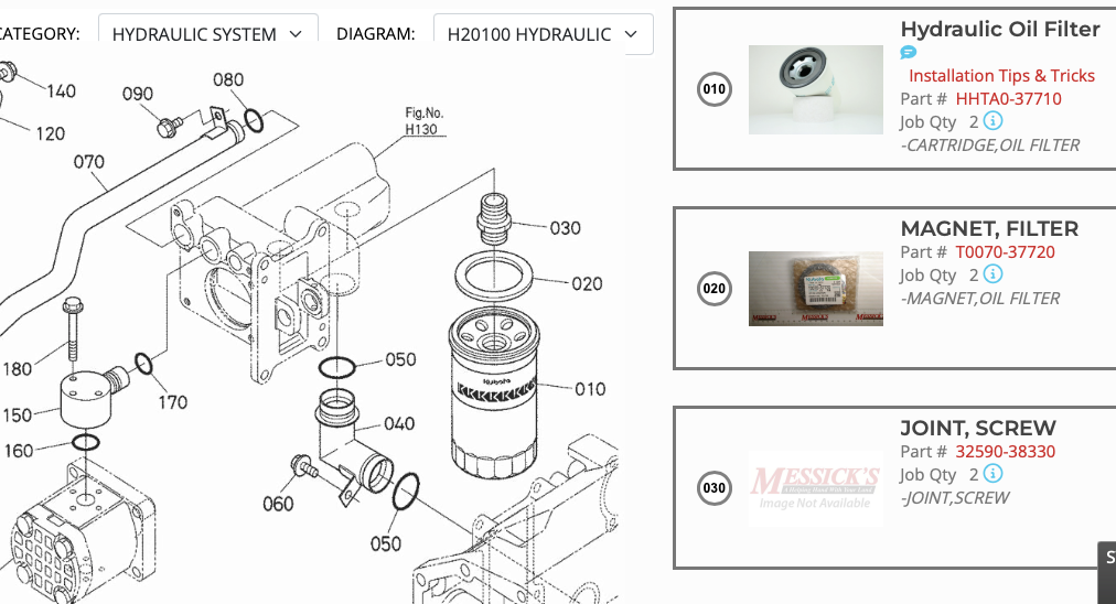

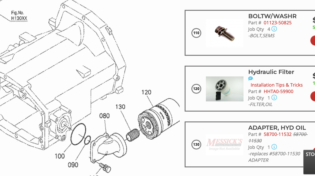

I've never heard of another one being loose - I was sort of surprised that it could even come loose.
I think that once the filter is snugged up nothing can move. The compression of the filter gasket not only prevents leaks, but I think it should keep the pipe nipple from turning too.
Here are pictures showing the pipe nipples we are talking about. Threaded on both ends. It looked to be a parallel pipe thread, but I didn't measure it.
rScotty Screenshot 2023-04-11 at 8.14.46 AM.pngScreenshot 2023-04-11 at 8.19.13 AM.png
