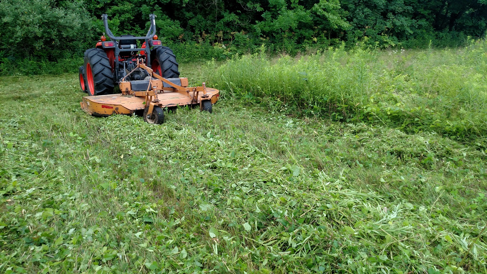

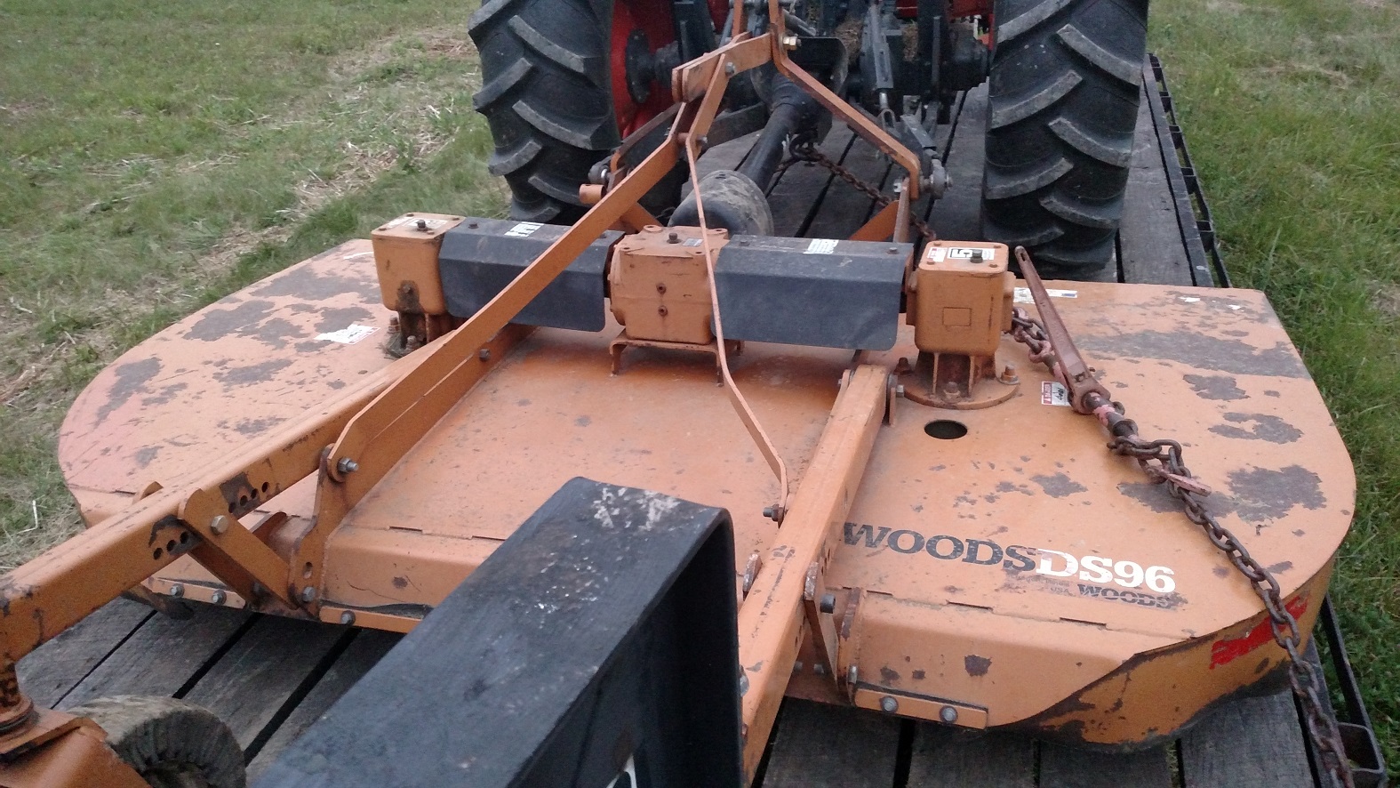

Pics today of mowing with the new-to-me Woods DS96. Its a nice cutter for sure.
IMG_20160704_055715880.jpgIMG_20160704_055736524.jpgIMG_20160704_070224500.jpgIMG_20160704_070340506.jpg

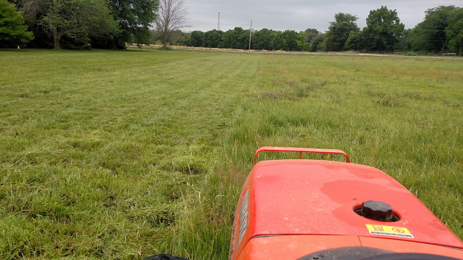

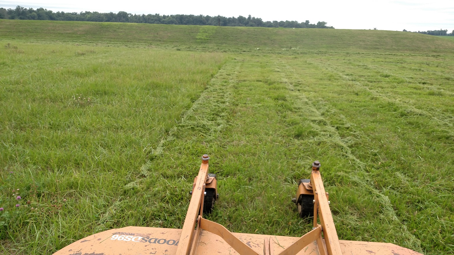

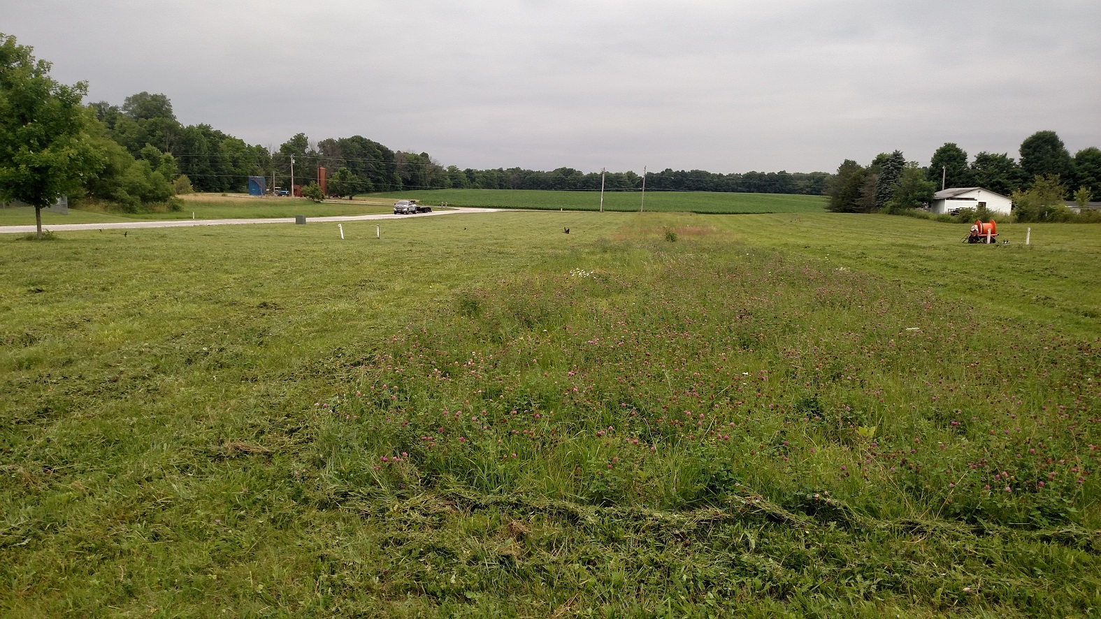

And these next pics are of two different lots that I do 3 times a year. Lucky if I can stay on the seat much over 4-5 MPH. One is 3 acres the other 2 acres. Jobs like these make me wish for a 10' cutter.

Nice lookin cutter! Whats the weight? With no FEL, how light is the front?
1620# according to woods.
Front is real light. While mowing and cutter down, no issue. But have to back on the trailer. Need about 300-400# of front weights.

I like the cutter. I only have 42.5 hp, and can still go pretty fast in the thickest stuff I have been in. But bear in mind, this cutter is only rated to cut 1.5" stuff. I haven't pushed it in that aspect. If I get I to jobs like that, I use my bushhog 306. This is mainly a pasture mower for speed. And I keep blades pretty sharp.
I don't much care for the blade bolt design. I'd rather have a threaded bolt and big nut as opposed to this keeper thingy.
