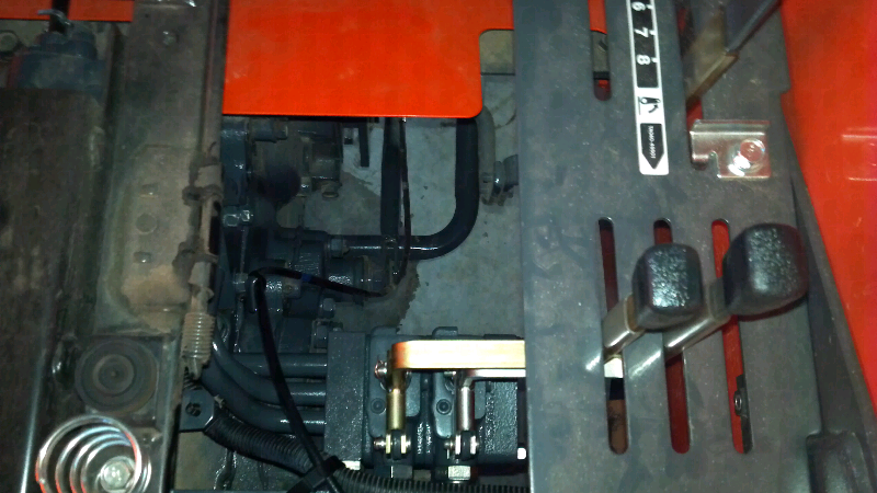

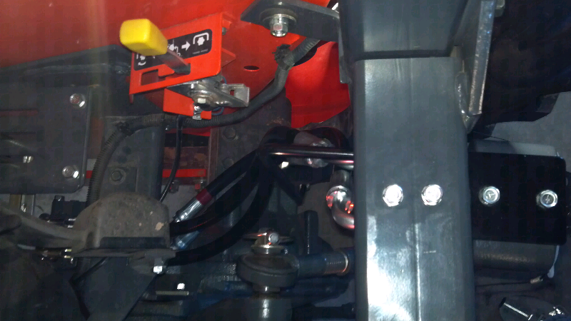

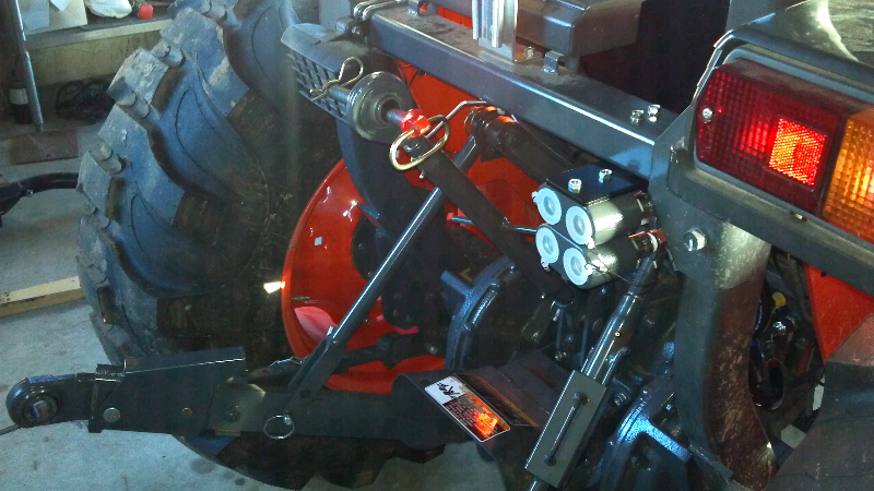

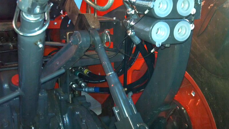

Since i searched and searched for any pictures shoeing the way the hoses are ran and the machine looks with ill post my pics here when I'm done. Should be interesting.
Today I will be adding 2 sets of rear remotes to the tractor. It is the factory setup.

Kubota has it set up as the first is detent and the second is a float. So there really isn't a choice.
Ill post pics later how the hoses and everything mount up later today
