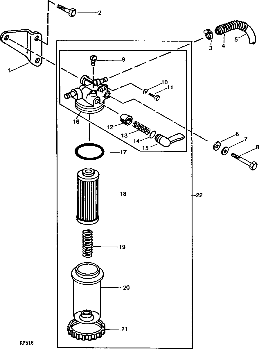

Have you checked that fuel tank vent is open? On a M4900 that I previously purchased used I found a tiny white screen in the water separater/filter that was plugged that would make it stop running.
   / MX5100 only runs with air vent open
Thanks for the suggestion. Where are the fuel tank vent and water separater/filter located?
   / MX5100 only runs with air vent open #6
Fuel tank vent on my M4900 that I did own was on the top of the fuel tank. You can check if vent is the problem by loosening or removing fuel cap. Here's a parts photo of a water separator similar to what Kubota uses.
