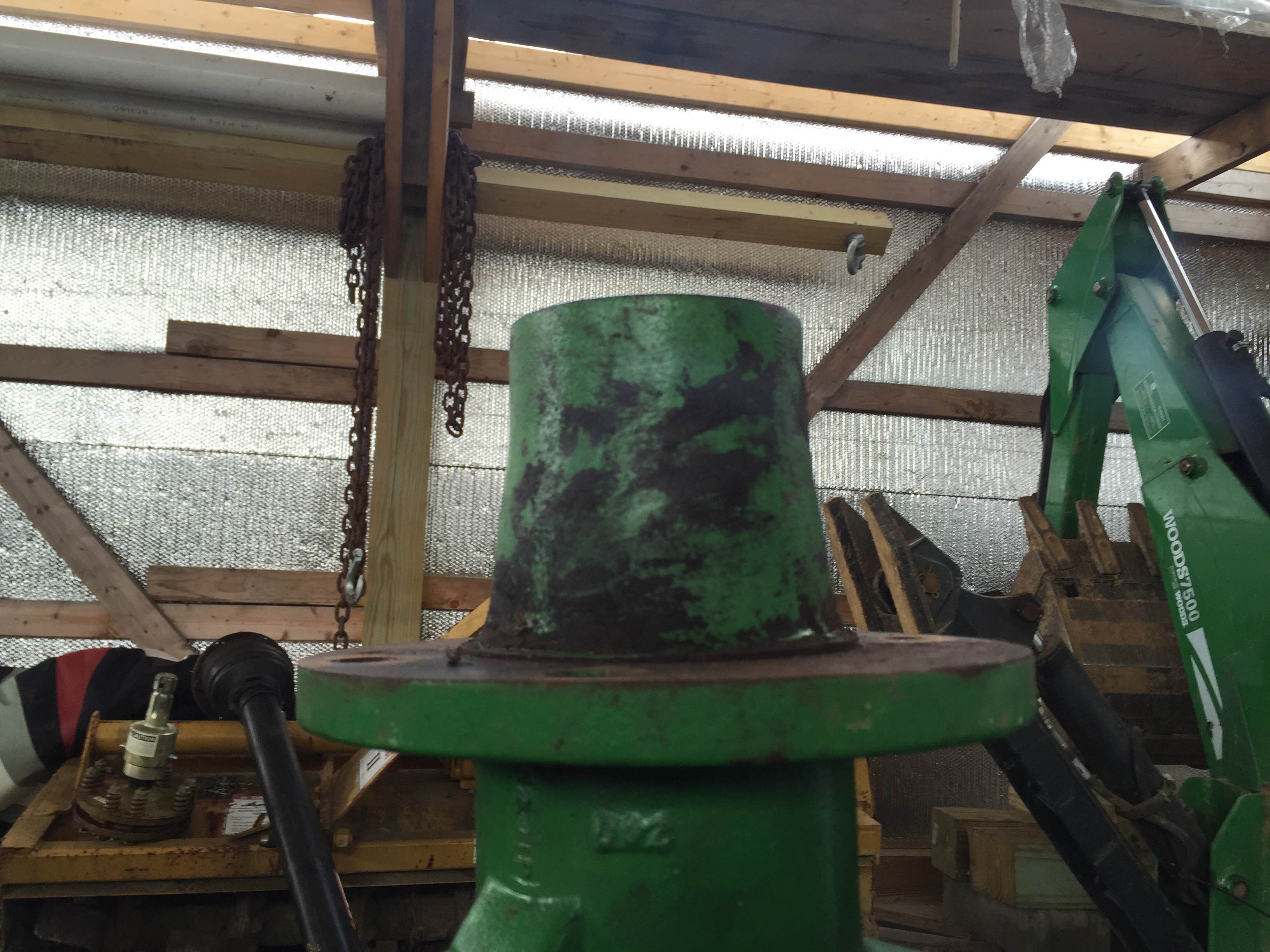

Well it's definitely not just a matter of bolting it on; have to remove more material from the bottom of the stump jumper & radius the hole shoulder in the hub spline and see how close that gets me to the hole on the castle nut... the original bolt was over 3 inches, and the output threads are only 2... committed now so will resolve then document.
As far as bolt pattern & length to output shaft spline, its right on the money.
Its important to note I have "version 1" of the stump jumper, with the 1"x 4" bar stock straight across the bottom of the hub/top of the jumper, where version 2 had a redesign that seems it would be more easily mated to the comer. I began with 1.375" of steel and 1/2" gap from the spline end to the steel start.
The stump jumper is wide and heavy compared to some others I've seen, and must transfer a lot more shock. It definitely does not lend itself to being retrofitted with a castle nut, but it will be licked!

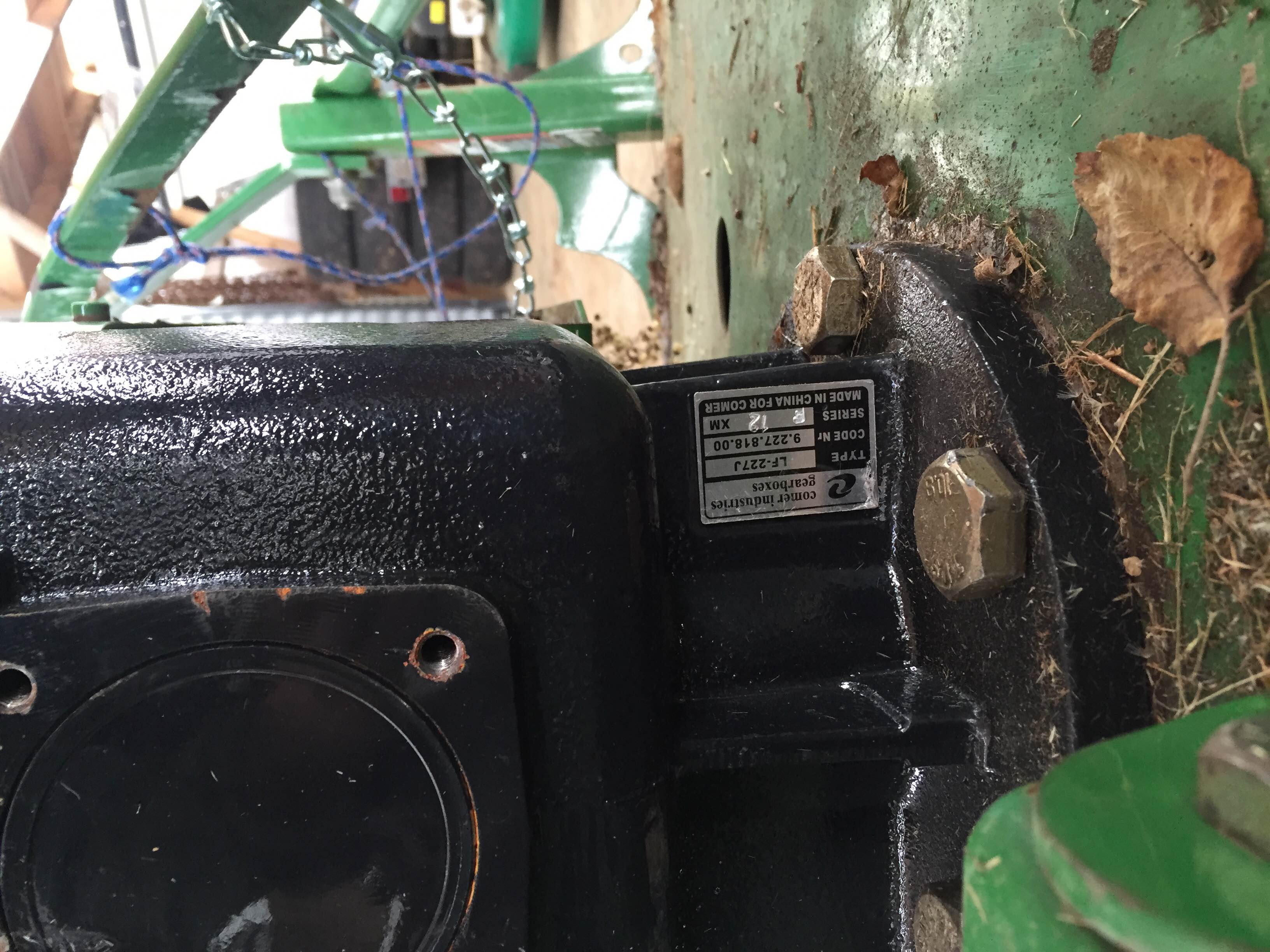

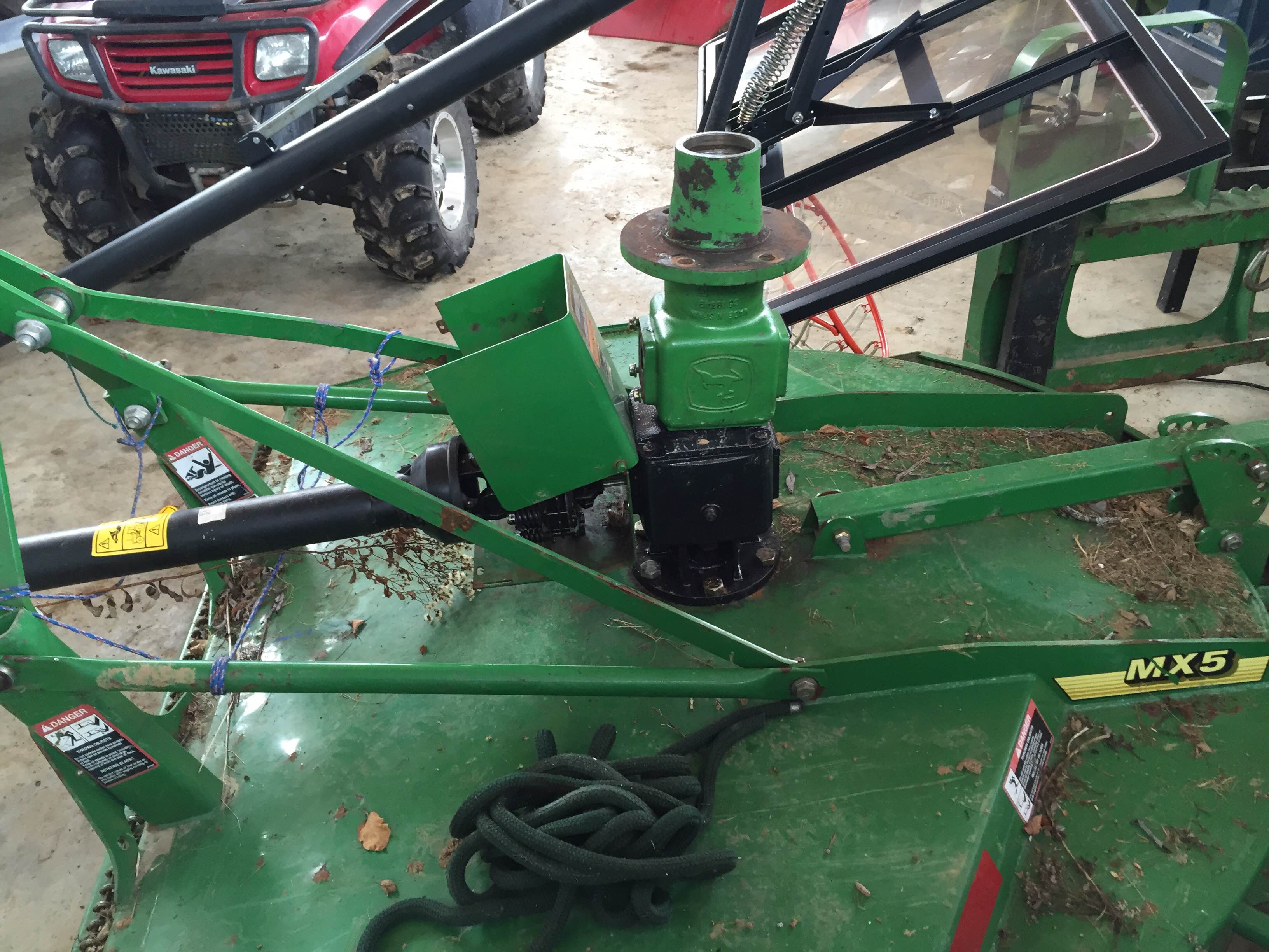

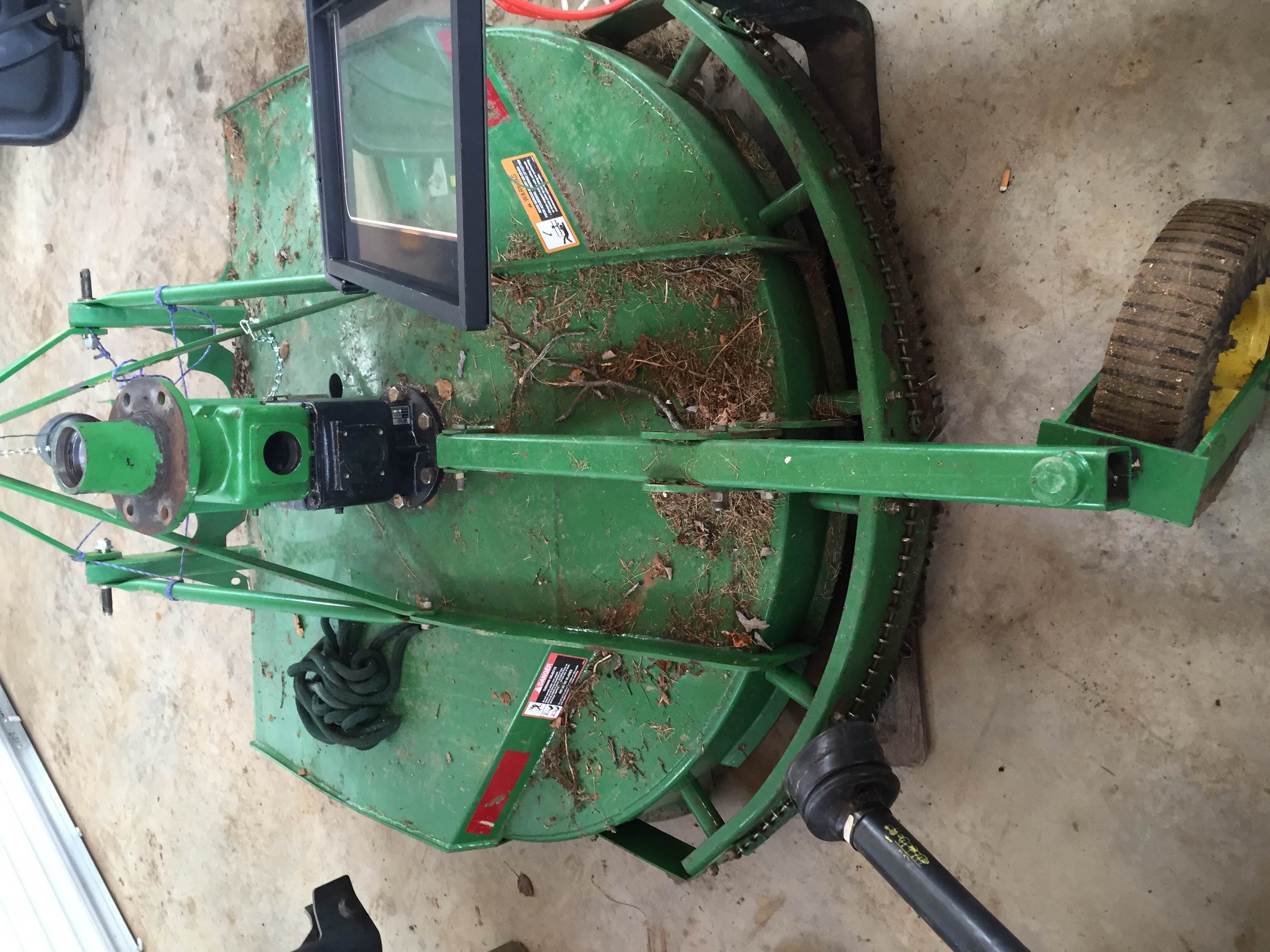

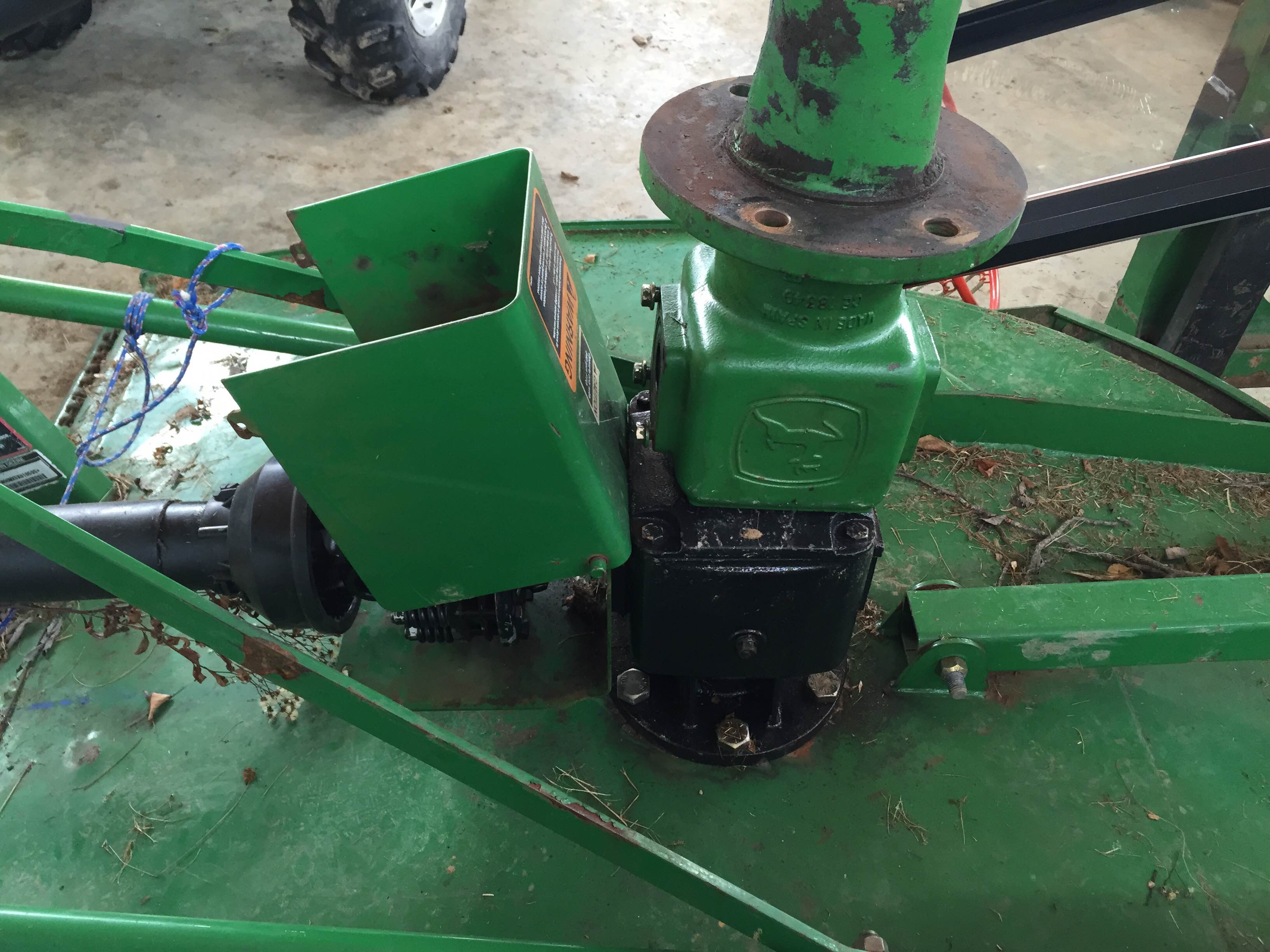

Hey All,
Sorry about not getting pictures up sooner. Thanks for reminding me.
Unfortunately I have no pictures of the cutting and reconstruction of the deck reinforcing bowl. For those that aren't staring at one--it's a steel bowl--about the size of a medium kitchen bowl with six holes drilled in it. It's 3/8 inch thick and is continuously welded to the lower deck on the rim of the bowl.
4 tack welds hold the drilled bowl 'bottom' to to the upper deck. The gearbox bolts to the bottom of the bowl.
Note the 60 degree shift in bolt pattern between the new black comer box and the busted green deere one. One could drill six new holes and accomplish the same thing--it would leave very little steel in the bowl, which seems to be the heart of the double deck design.
The bowl depth is what makes replacement an issue for the MX series.
The comer 227 specs match the dimensions of the failed gearbox bottom--i.e. the steel bowl depth between the decks.
It took a lot of modification to the hub to get the castle nut seated, and the long term durability remains to be seen.
It is intact, it runs fine so far--time will tell!
   / MX 5/6/7 John Deere gearbox solution found #10
I agree on the cut, reposition and reweld verses drilling 6 new holes that size (not easy to drill large holes by hand).
