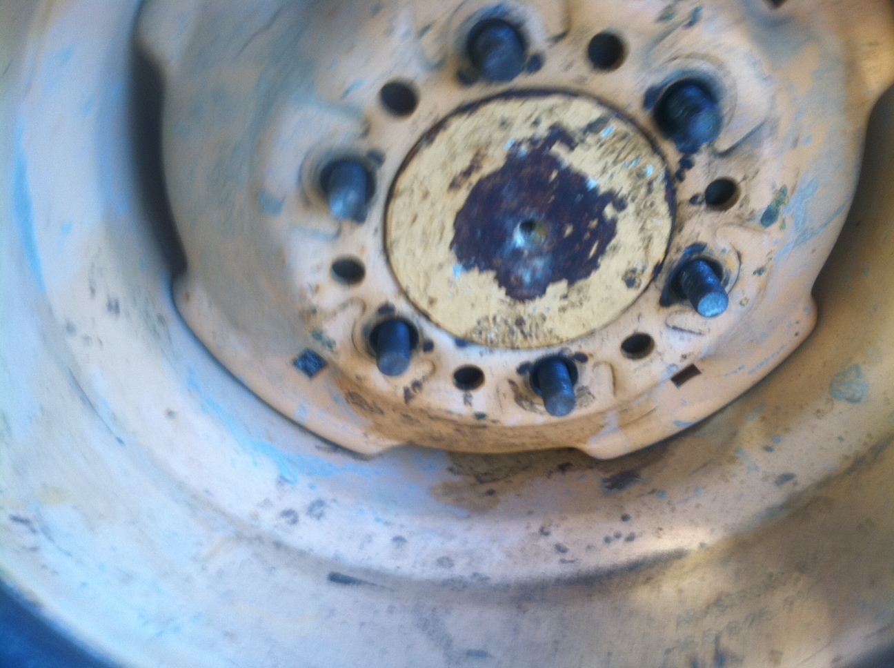

Here is the picture of the rear tire on the tractor. I have removed the bolts but can not remove the tire.
What do I need to do?

Looks like It may have rusted on. Are you in an area that uses a lot of salt on the roads or near saltwater? Penetrating oil, heat or force would be what I would try.

The center pilot hole of the rim is stuck to the pilot hub of the axle. Soak it down with penitrating oil, let it work in then use a hammer to tap on the rim inbetween the studs to break the corrosion loose.
