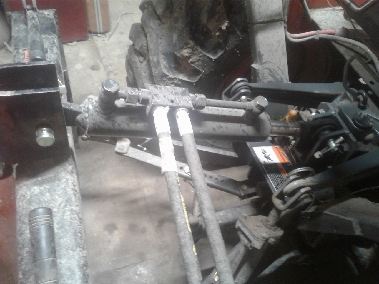

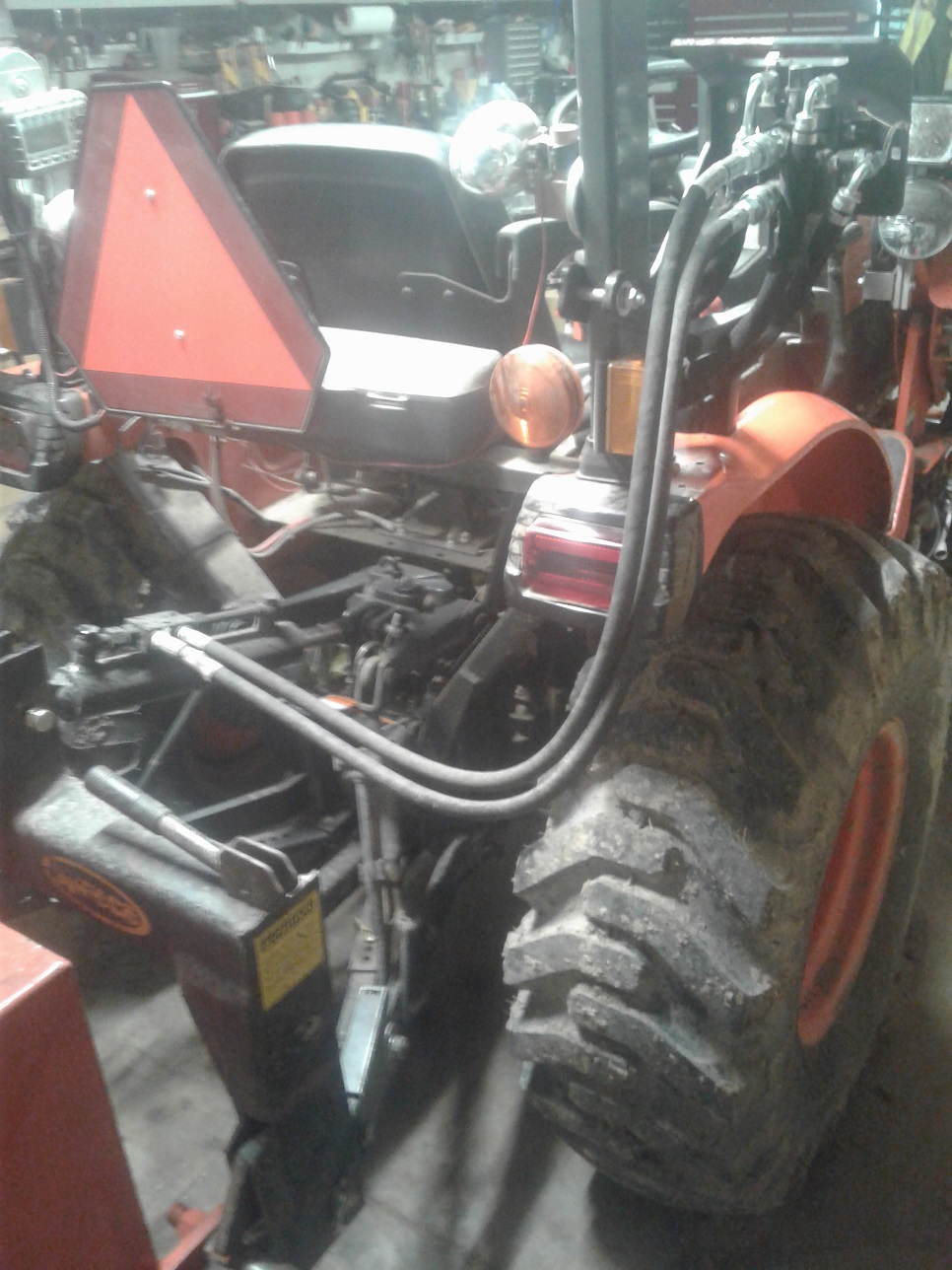

Get as many rear remotes as you can and third function for the front as well. 3 point quick hitch and Hydraulic top link.
Category 1 Hydraulic Top Link: 18 1/8" - 26 3/8" | AGRISTORE USA
My B2650 is the prior version of your tractor. The swivel on top link may be to wide for tractor. Clamp bolt or top link pin in vise, place cylinder over pin and use angle grinder to make the swivel end narrower.
At 80 y.o. being able to backup to implement, raise 3pt and you're good to go on non-pto equipment. PTO quick connections are now hitting the market if he has weak grip strength.
Still looking for hydraulic side link cylinder.
