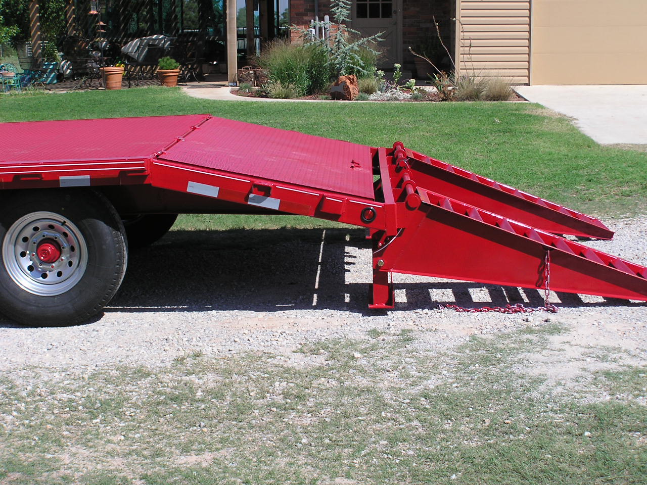

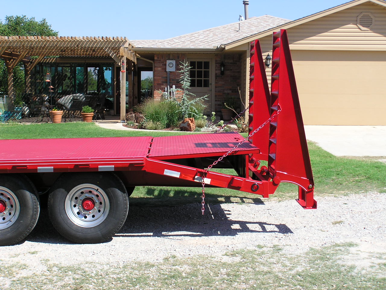

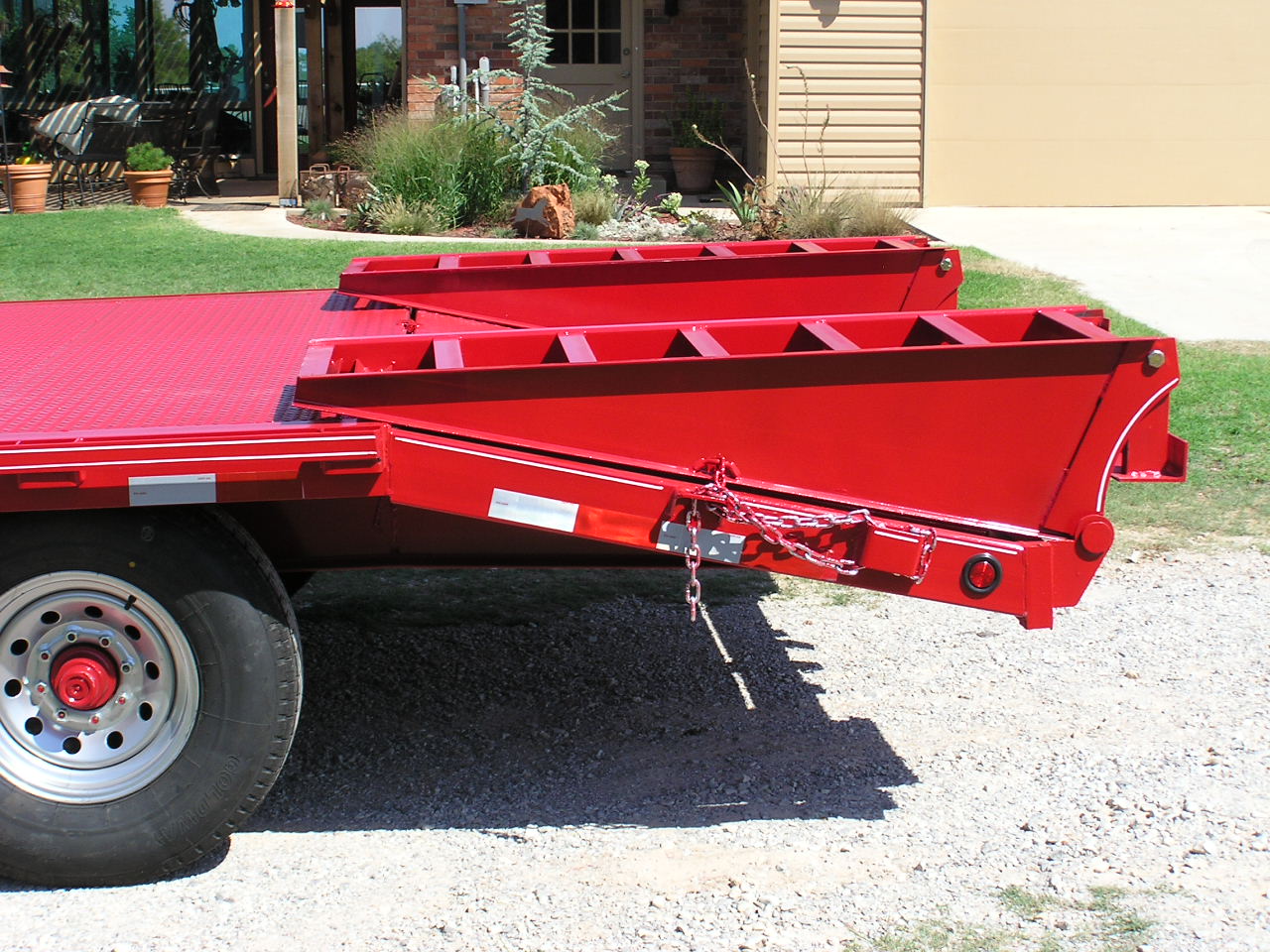

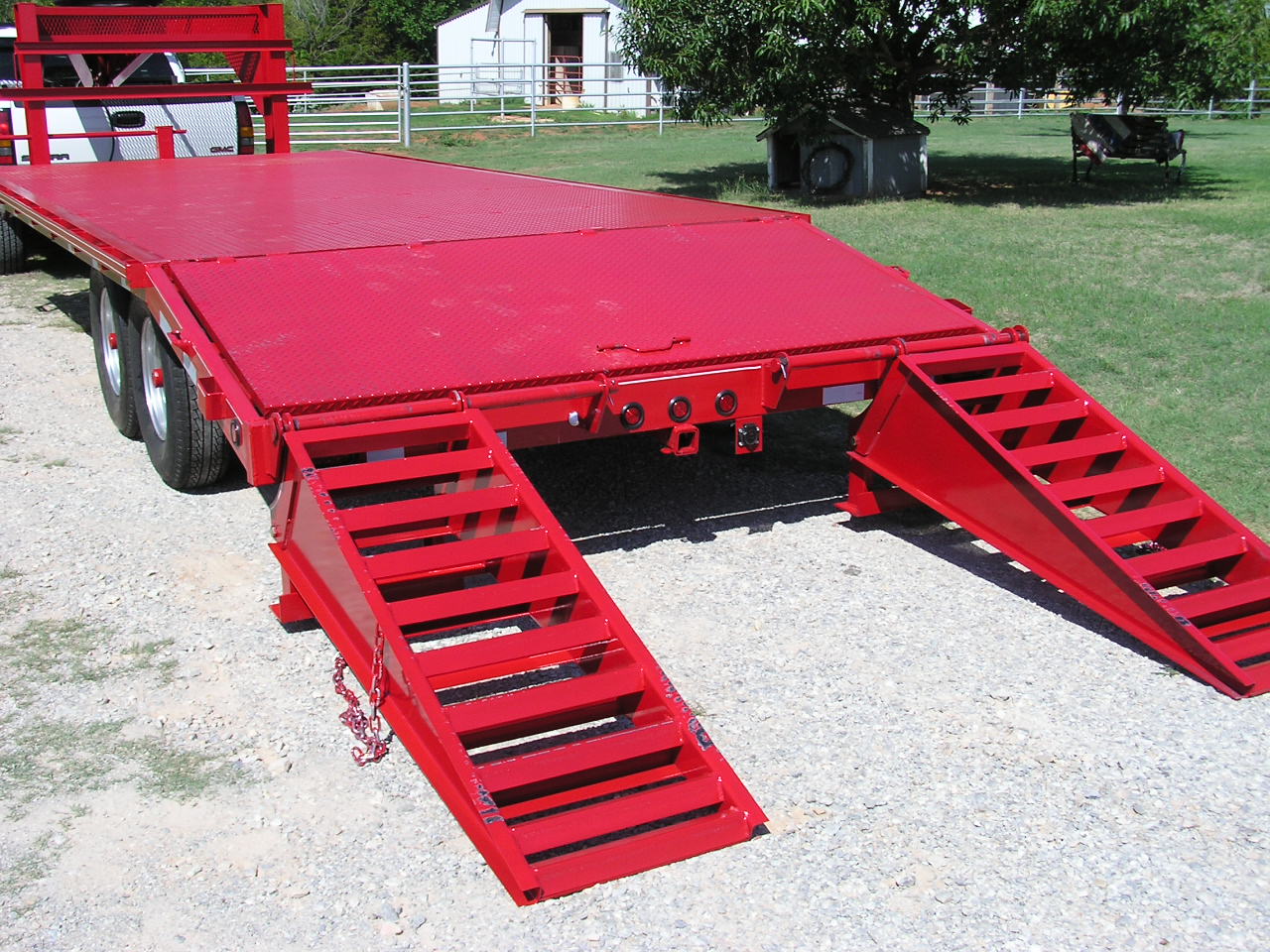

I recommend gooseneck! :thumbsup:
If you get a tilt, be careful hauling hay, don't load clear to the back or there will be more weight behind the axles than in front. You don't want the "tail wagging the dog".
Some car haulers have removable fenders, so you can open the car door when it is on the trailer.
Not sure you could load a Corvette on mine, I haven't tried.
