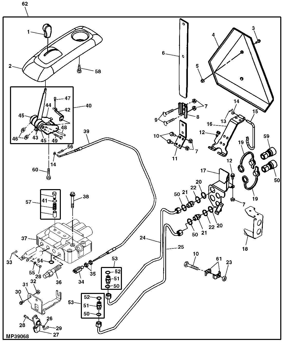

I have a 4200 w/FEL (also this has a SCV). Just purchased a 3 pt. mounted snow blower w/hydraulic shoot (only has one cylinder on it now). Question, is it possible to hook up both the fel and the blower and operate them at the same time. Remember I only have a SCV at the mid point of the tractor. Can I add a valve for the rear of the tractor to operate the blower?
   / Multi hydraulics outputs? #2
Sure, you can add another valve...Technically you already have it-but there is no lever or plumbing for it. JD sells a 3rd SCV kit for about $250 that adds the lever to the right hand fender and plumbing to the rear of the machine. The part number is BM19694
Picture is below. This will be the most economical solution.

Thanks kennyd for the reply! Will the 3rd SCV kit provide me with 2 output ports or 4 ports ?
   / Multi hydraulics outputs? #4
It provides 2 outlets that equals 1 circuit. If you want more, then it will be a home brewed setup, that will end up costing about $500 to do. Most people find that chute rotation is all they need, so you only need the one circuit.
But to better answer your other question:
No. Not without some sort of diverter valve to switch between the two. Prices will range from about $75 for a manual one, to about $150 for a electric one-then add in all the fittings, hoses, coupler and you will be at $300 to $400 or so.
