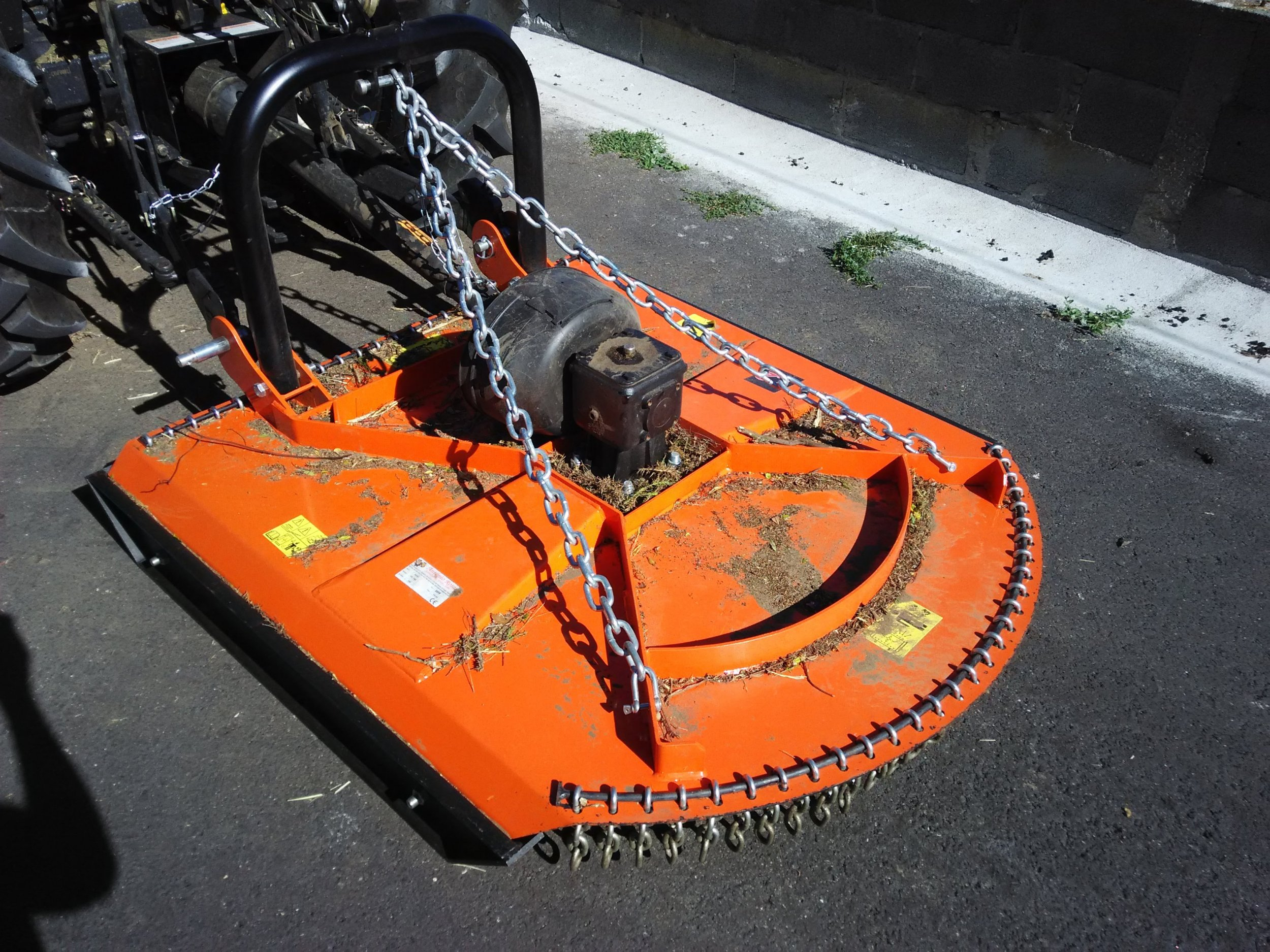

I know exactly what would work great but I don't think it's available in the US, so it's probably irrelevant but I share it anyway.
The brush cutters we have here in Portugal use either two or 4 high strength grade 80 chains, instead of blades. Along with a gearbox with at least 1:1.92 ratio. These cutters work great on the type of brush you're dealing with (thicker stuff). These do eat a fair amount of HP and can put lot of stress on the drive train, hence why it's bought either as wide as the tractor or slightly narrower, keeping in the mind the HP as well.
This is mine. Light duty version, 4 ft wide and cost me $650 back in 2017. Has seen all types of brush, some higher than the ROPS on the tractor and as thick as 3". And the best part is that it tends to shred the material, leaving soft edges on the brush that won't hurt the tires. While with blades, it can leave sharp points that can easily puncture tires.
It won't leave as nice of finish in grass but on everything else it does very well.
