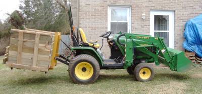

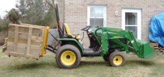

Here's a side shot showing my carryall and bucket combo for moving mulch from my pile up near the house to my garden 100' below. I can move enough mulch for about 2 1/2 rows vs. 1 row that I used to do with only the bucket or in my Gravely cart. The rig is very well balanced, too, very stable.
Ralph

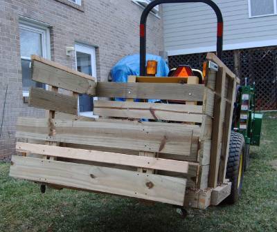

Here's a rear shot of the carryall with the back side folded down on its hinges. I only put mulch in up to the fold; that amount is about equal, maybe a bit more, than what's in the 53" bucket up front.
Notice the castors on the bottom. They're to make taking the carryall on and off easier on the concrete floor of my carriage house basement.
The bottom to the box is just a pallet bolted to the bottom "L" of the carryall. I've a mat and a couple pieces of plywood in for the mulch carrying, to cover the cracks in the pallet structure.
Ralph
