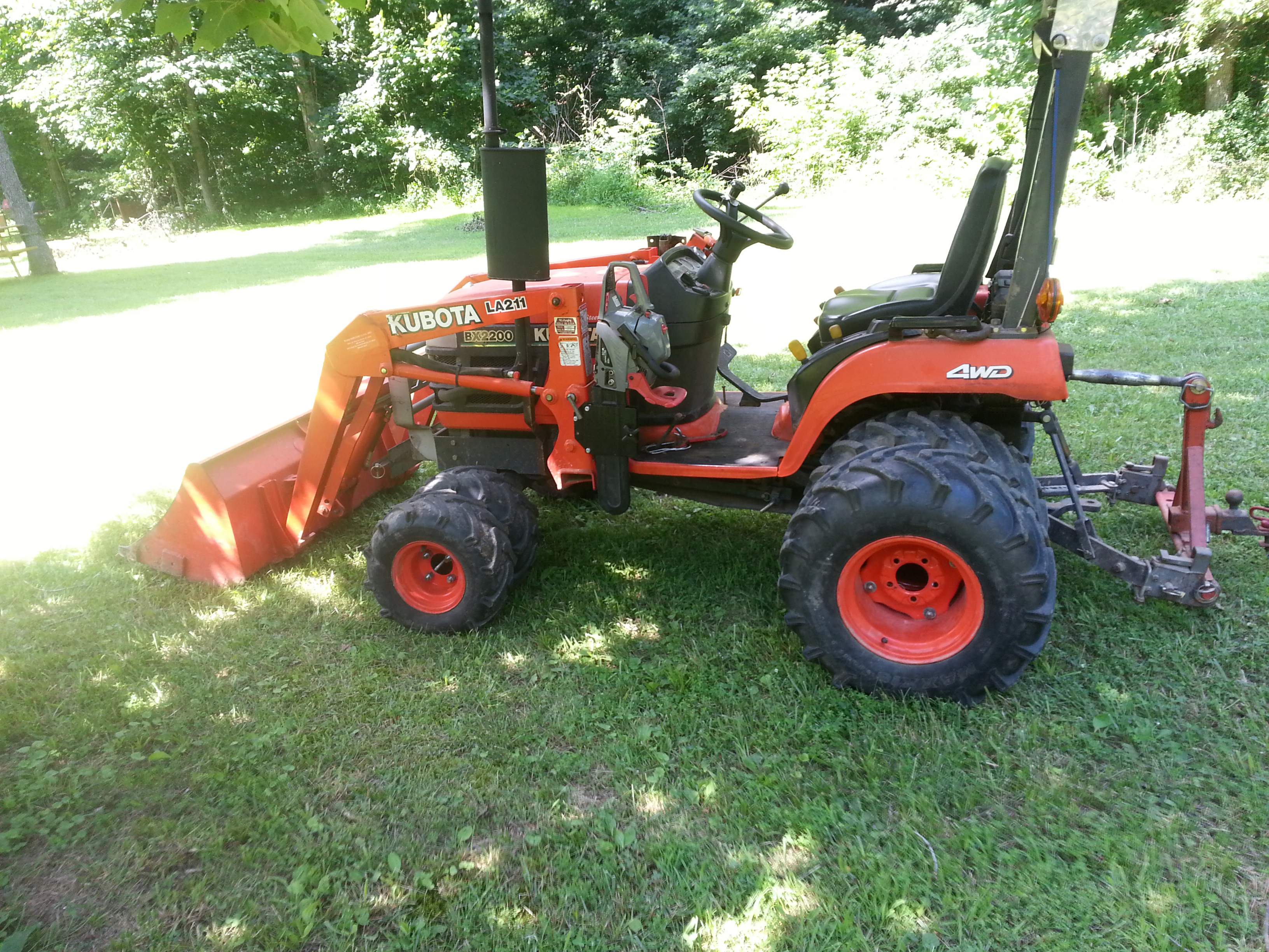

I've had an aftermarket muffler on my BX for about 4 yrs and when I first converted it to straight up exhaust, I used a round muffler from TSC. That muffler was straight through and too loud so I found a 1 1/2" inlet/outlet from a 97 Honda Civic that has worked well and is quiet as the original. I don't think you will like the straight pipe, loud enough it makes ears bleed.
