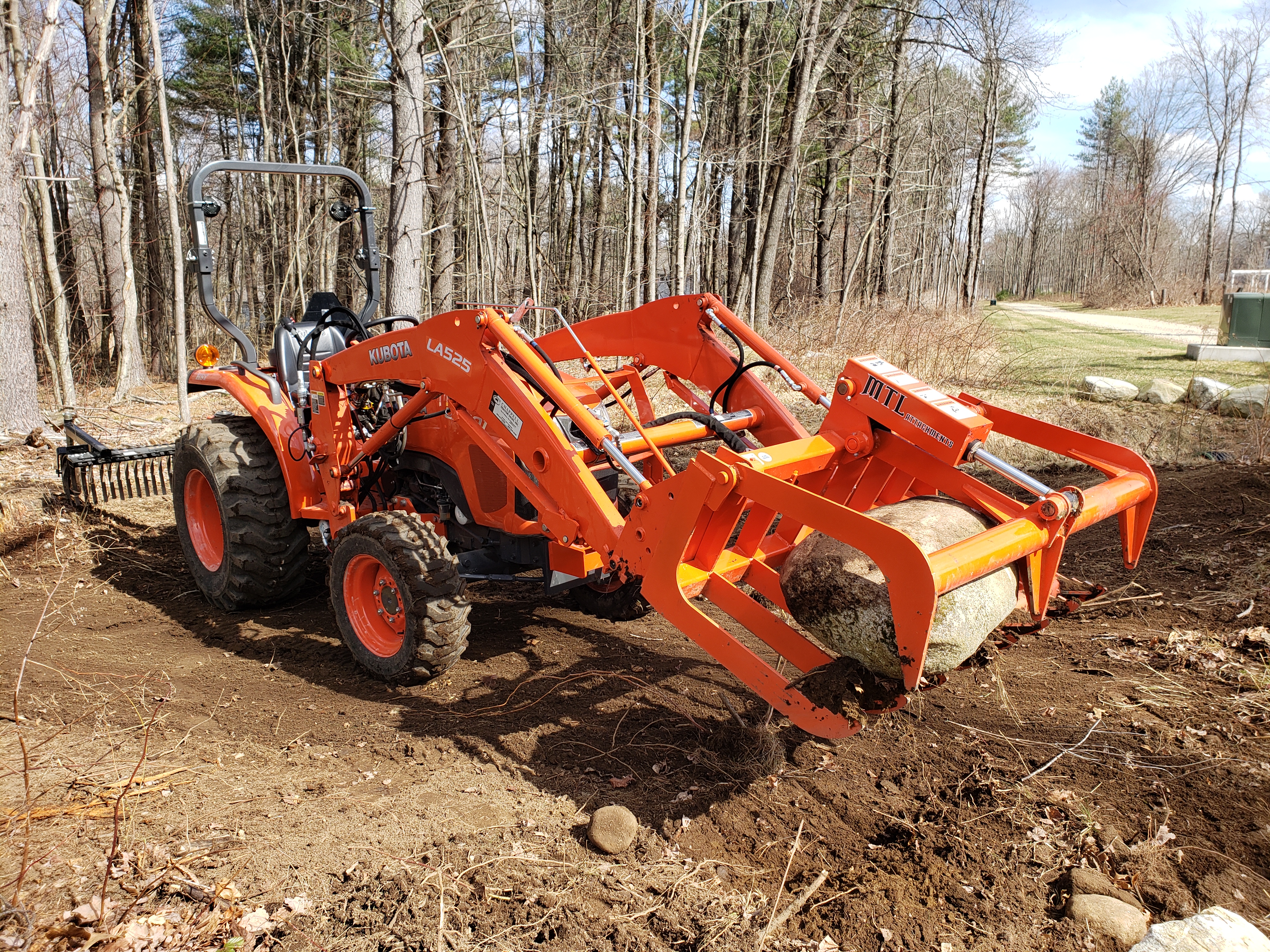

Pics:
View attachment 600054View attachment 600055
Grapple got here in the middle of the delivery window. Nice surprise to see that it is Kubota Orange, thought i was getting a black one!
Grapple looks great. Spent most of my afternoon installing the 3rd function kit. Not too difficult but spent a lot of time trying to figure out how to route wires.
I do have one problem. Have a leaky hydraulic fitting. On my 3rd function kit, not the grapple. Not sure how to fix that. Any suggestions?
I tightened everything up but didnt use any tape or loctite or anything. All others seem ok but one of the male fittings that the grapple attaches to is leaking. Tightened some more and it is leaking less but still leaking. It is in an awkward spot i wonder if i just need to use a little more torque.
   / MTL 48" Root Grapple
Found the cause of my leaky coupler. Unscrewed it and half a rubber o-ring fell out. Looks like it must have been
out of place and gotten pinched. Screwed it back together without the o-ring. Assume it will leak less metal-to-metal, but will have to chase down a new o-ring.
Still muddy here but hoping to get some good grapple time in next weekend. I did try it out for 5 min while it was leaking - grabbed a big stump no problem, picked a good size log off a pile without disturbing the rest, and grubbed up some debris. I think this is going to work out great.
Working great today grubbing a patch of thorns and moving some rocks.
   / MTL 48" Root Grapple #6
My 66” MTL has been a great and reliable piece of equipment for me. I have been nothing but pleased with it and I have worked it fairly hard over the last six months or so.
