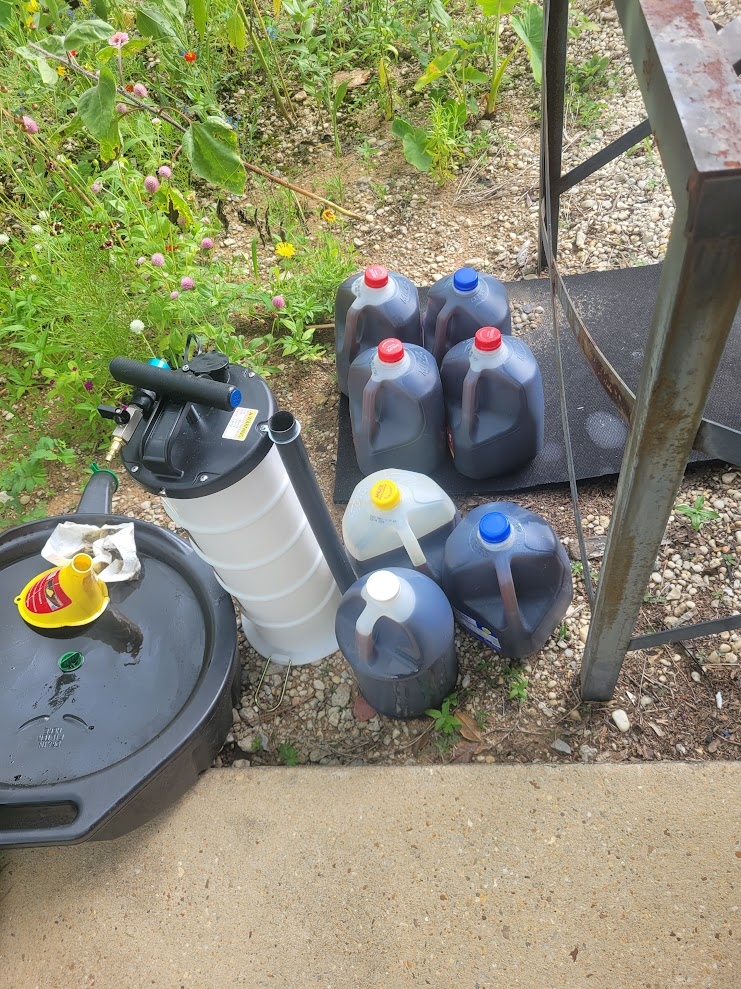

I hit 600 hours, and my hydraulic filters were due, fluid was coming up and I've been wanting to swap the fluid to synthetic for a while, so all that happened today.
Draining it was pretty straight forward. I used an oil extractor through the fill port and pulled out almost 5 gallons. Then loosened the main hydraulic filter and drained off about another gallon. Pulled the bottom 30mm plug and got most of the rest. Pulled the side 30mm plug and maybe a cup came out. Removed the HST filter and half a cup came out, and that was it. I did it in sections like that because I didn't have a catch pan large enough to hold all 8.5 gallons listed and I wasn't sure how much I would get in total. I wound up with right about 7 gallons.

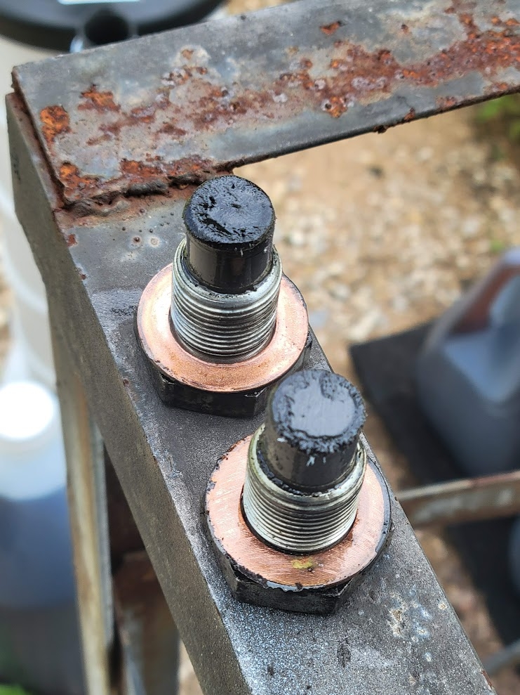

A little gunk on the plug magnets, not too bad. I can tell the dealership didn't replace the copper crush rings, they still have the factory black paint on them.
I didn't see anything shiny in the used oil. Funny what looked clear on the dipstick is dark in the jugs.
It's sitting there empty right now, buttoned up and with new filters WIX 51551 for the HST and WIX 51715 for the main The sky opened up as I was getting ready to fill, wasn't willing to do that in the rain, thunder and lightning.
Full synthetic TRIAX Agra UTTO Supreme will be going back in. I'll update when done and ran for a bit.
