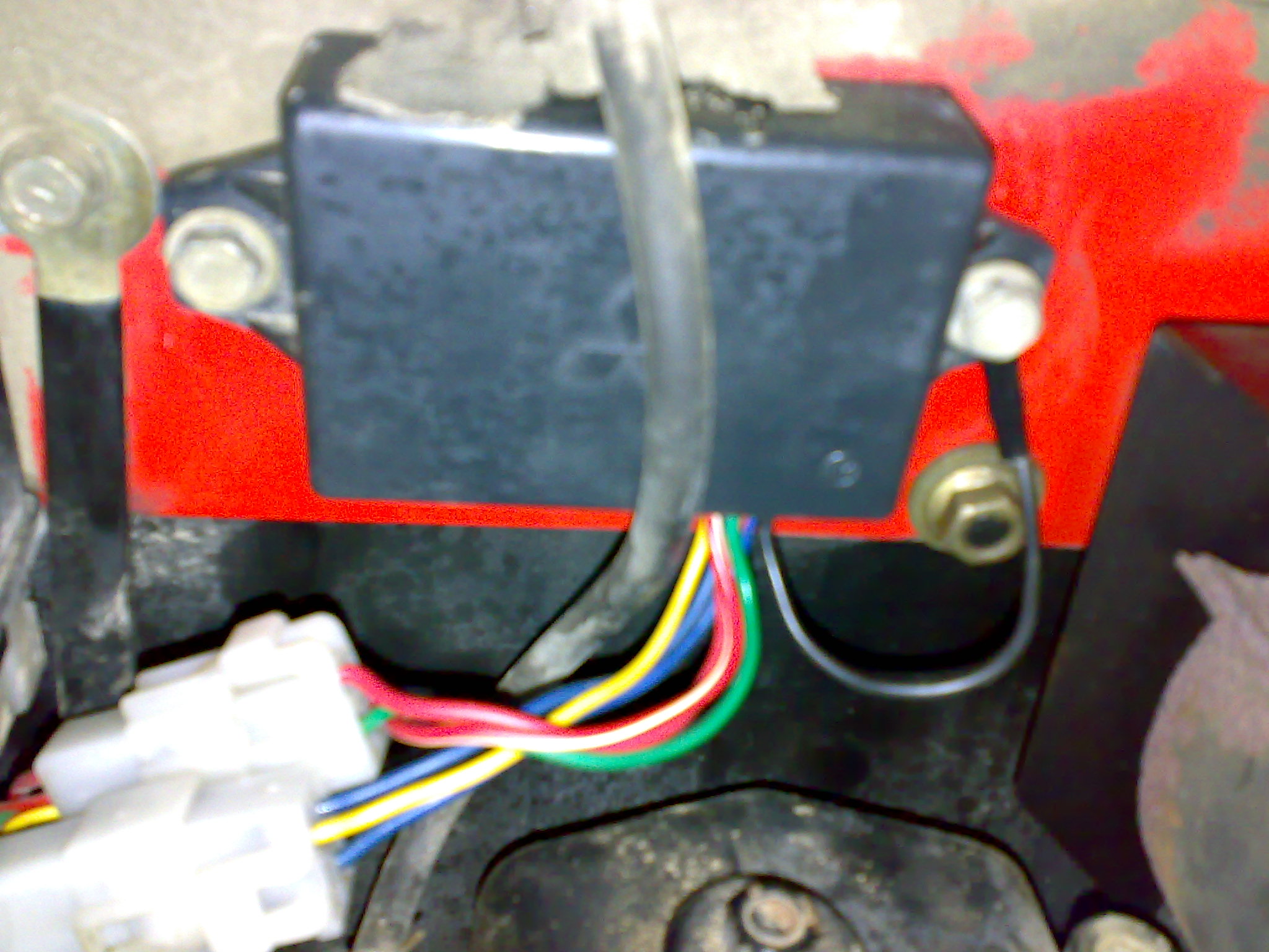

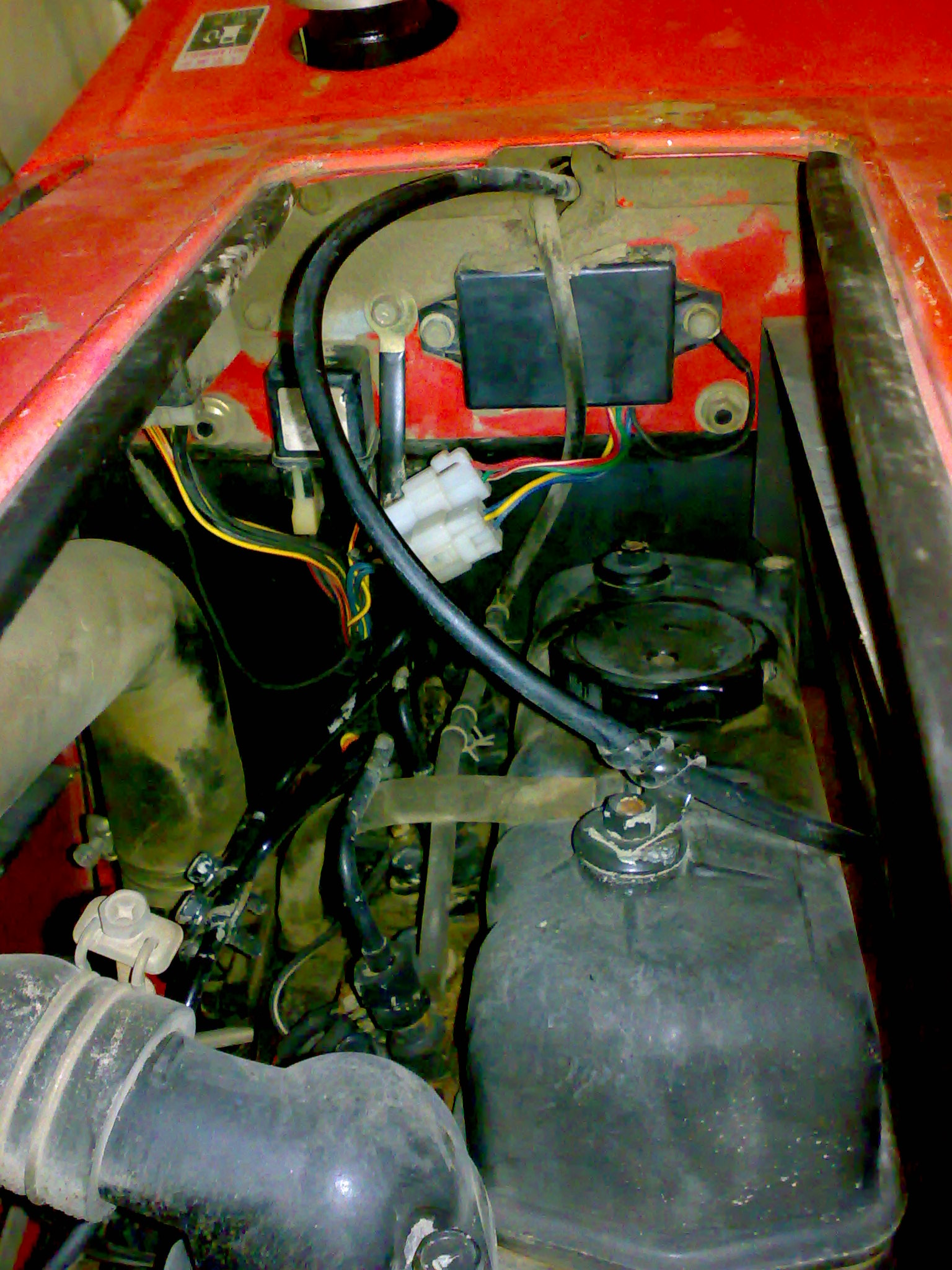

hi
seems the ignition on my MT18D is kind of faulty.
even if i pull the key, i hear a klicking sound (like relay) every few seconds or even more often.
if the clicking appears while driving, engine just turns of...
i took a picture of the engine block, i think the faulty part is the small black box in the upper half of the picture, clicking noises appear more often if i move the cables a little bit. does anyone know what this is or where i can get a replacement? there are no labels on it. it is kind of a blackbox.
thanks !!
ps: i tried to clean the connectors, but no success....

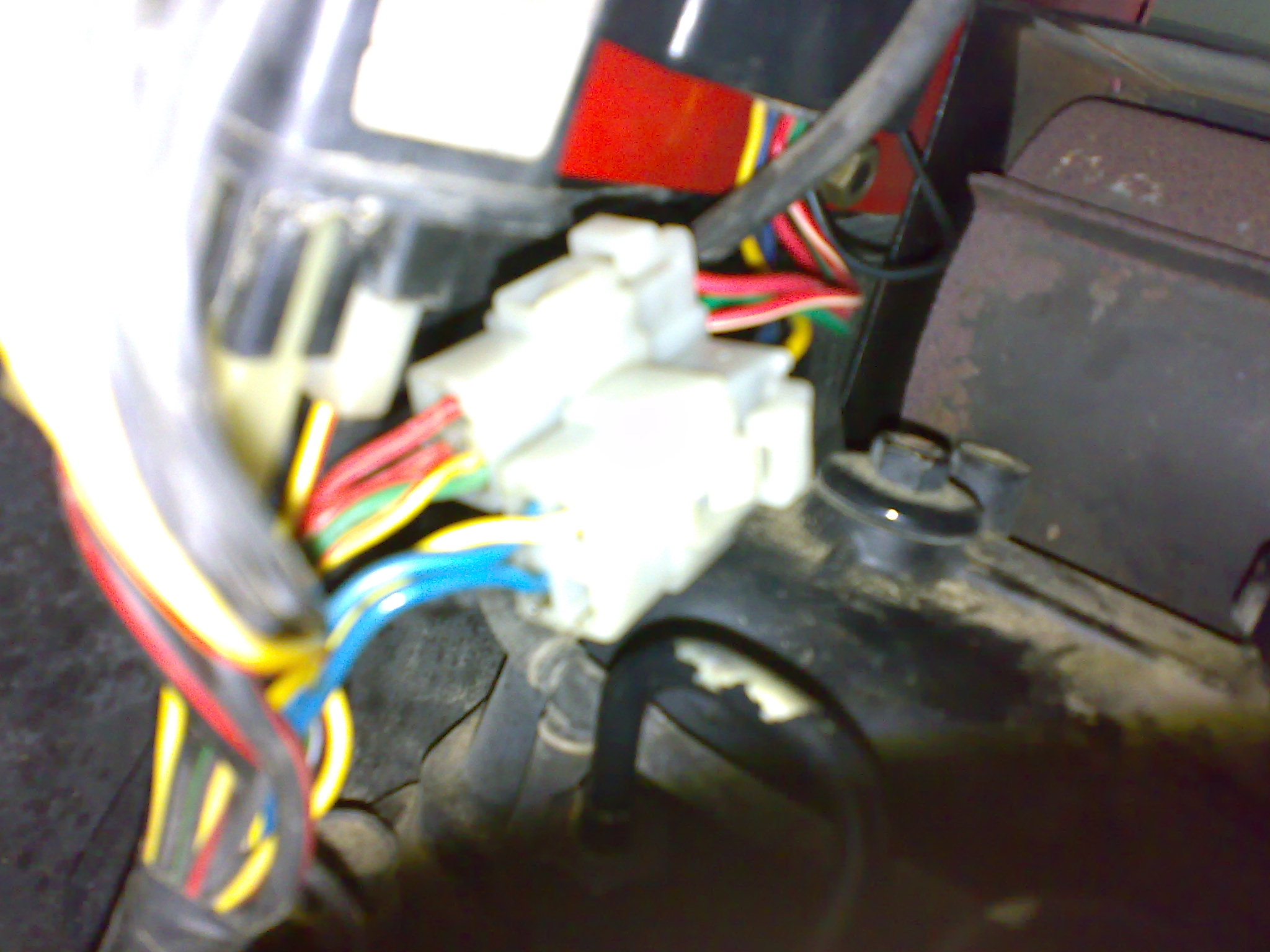

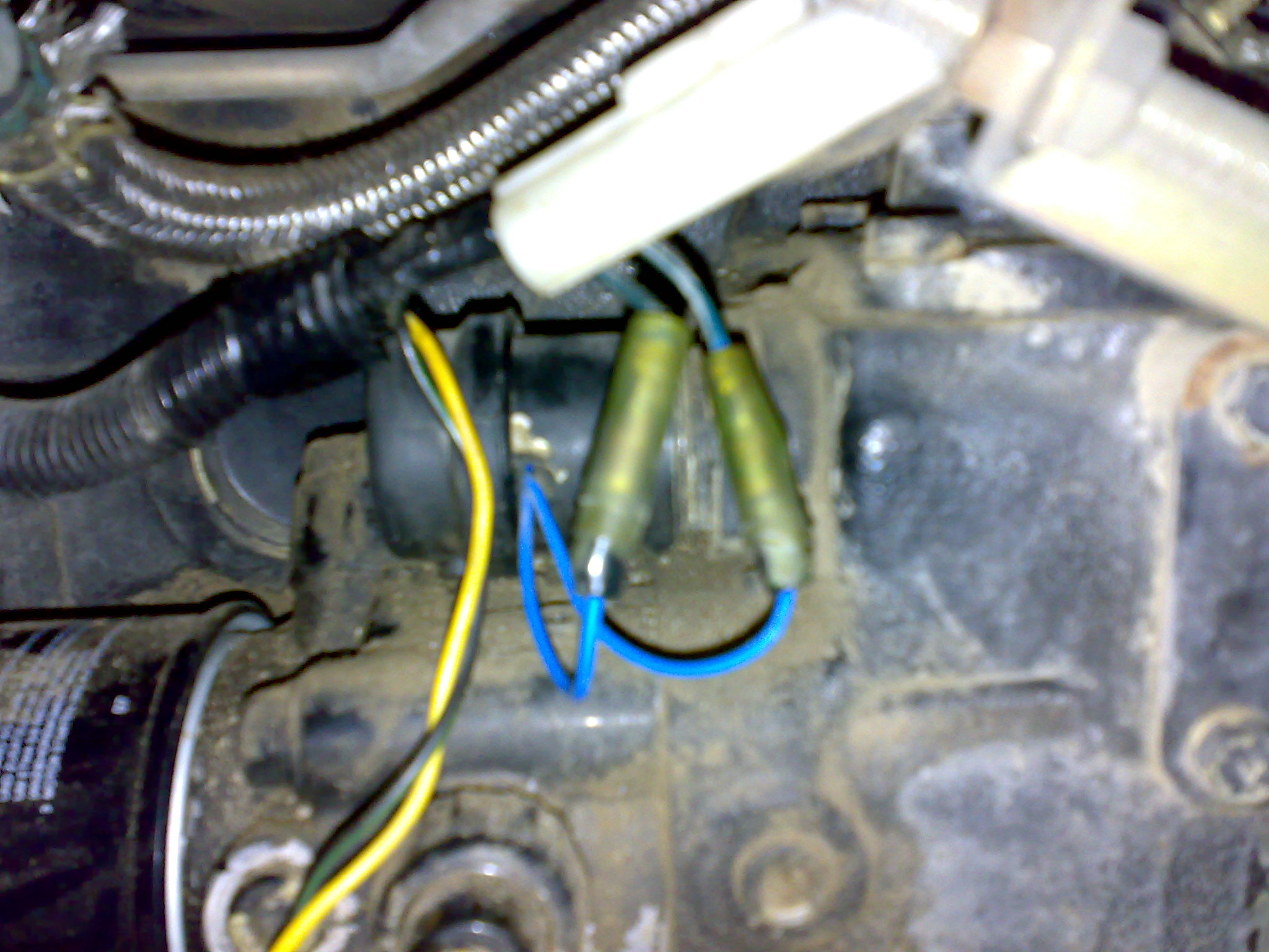

ok, i had some time to take another look at the problem.
bad news first:
after cleaing the connectors and grounding i was not able to reproduce the cable-movement theory. still clicking but not more or less.
good news is, that i know where exactly the clicking is coming from.
it seems it is coming from a magnet valve which controls fuel flow, which explains why the engine stops if the cklicking appears.
picture 1 shows this magnet valve with 2 blue cables going into the valve.
picture 2 shows the cables at the top of the engine being connected to a white plug
picture 3 shows the 2 blue cables dissappearing into the black box.
i removed the white plug and connected a voltage meter which shows most of the time 0.09V but sometimes suddenly voltage rises to 12V and drops back to 0.09V after some seconds or parts of seconds.
moving the cables did not change this behavior...
after cleaning the connectors and stuff, i found a text on the black box:
TV-94 94.4
any ideas?
   / MT18D spare part, ignition/CDI ?
FYI:
the part is called "Control Timer" an has Mitsubishi Part No. MM435745.
Price (new) is approx. GBP 75, EUR 95, $150
I found some in the US who has a used one für $70. I'll give it a try!
