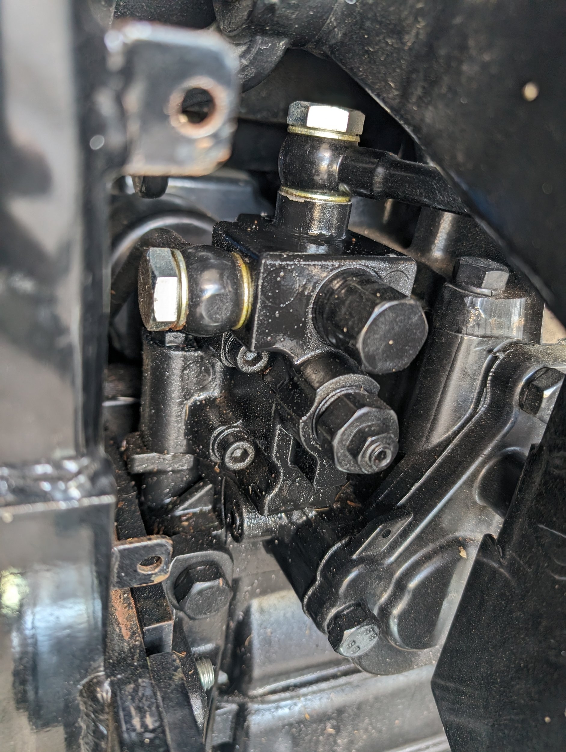

Just got home and upon closer look, it seems to be leaking from the top where the return line is, there's a little hole behind that banjo not sure if it's supposed to have a rubber cap or some plug
   / Mt122 leak #4
There's an Allen head plug in the hole in front of the top banjo fitting. There were a few MT1 tractors that had a loose plug and they leaked. LS had a service bulletin on it. Don't remember the size of the allen wrench needed to tighten, but I got over the top of the banjo fitting from behind the tractor to tighten it. A friend of mine took off the rear wheel on his to get at it easier. Had to turn it about one and a half turns until it was as tight as I could get it. Wiped off the oil and test ran, no more leak.
   / Mt122 leak
Haha yeah came into update on this, exactly what that turned out to be, first I tried to put little rubber plug, then I am like let me feel it see if it's a hex, tried 2 sizes and gave it at turn and it fixed, been cutting grass for 1 hours Everything seems fine and dry
