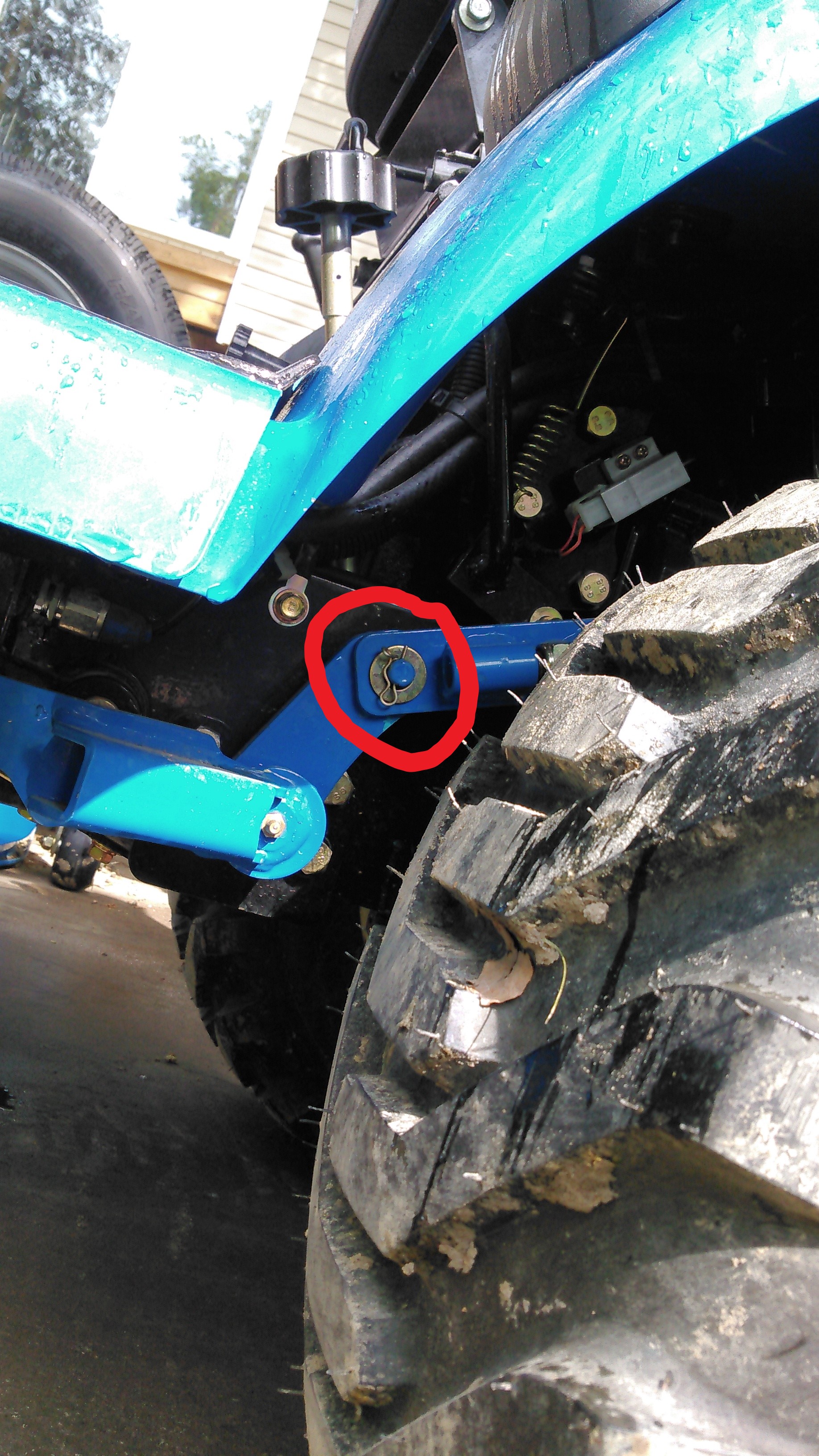

So off to ripping I go... after about 30 minutes, I reversed, and it felt like I backed into something. Stopped
to check what happened, and the arm on right side just under HST pedals that runs back to mower deck lift
linkage had come off. Further inspection revealed that the other side was close to falling, because LS ( or
dealer, not sure who assembles deck) did not put washers / cotter pins in. Maybe I should have noticed,
hence the 30% me, but it was my first time removing the deck, didn't know they were supposed to be there.
Here is a pic of the place where the cotter pin(s) were missing.

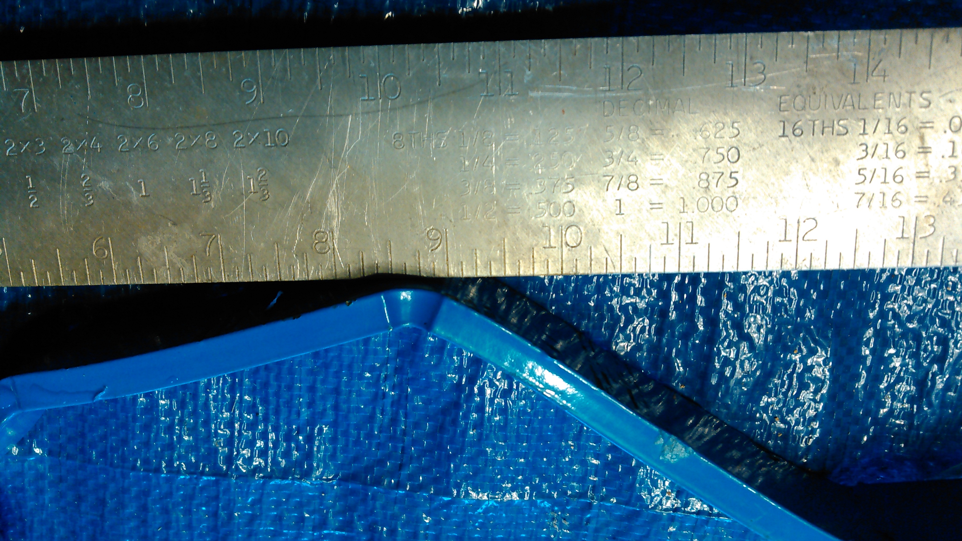

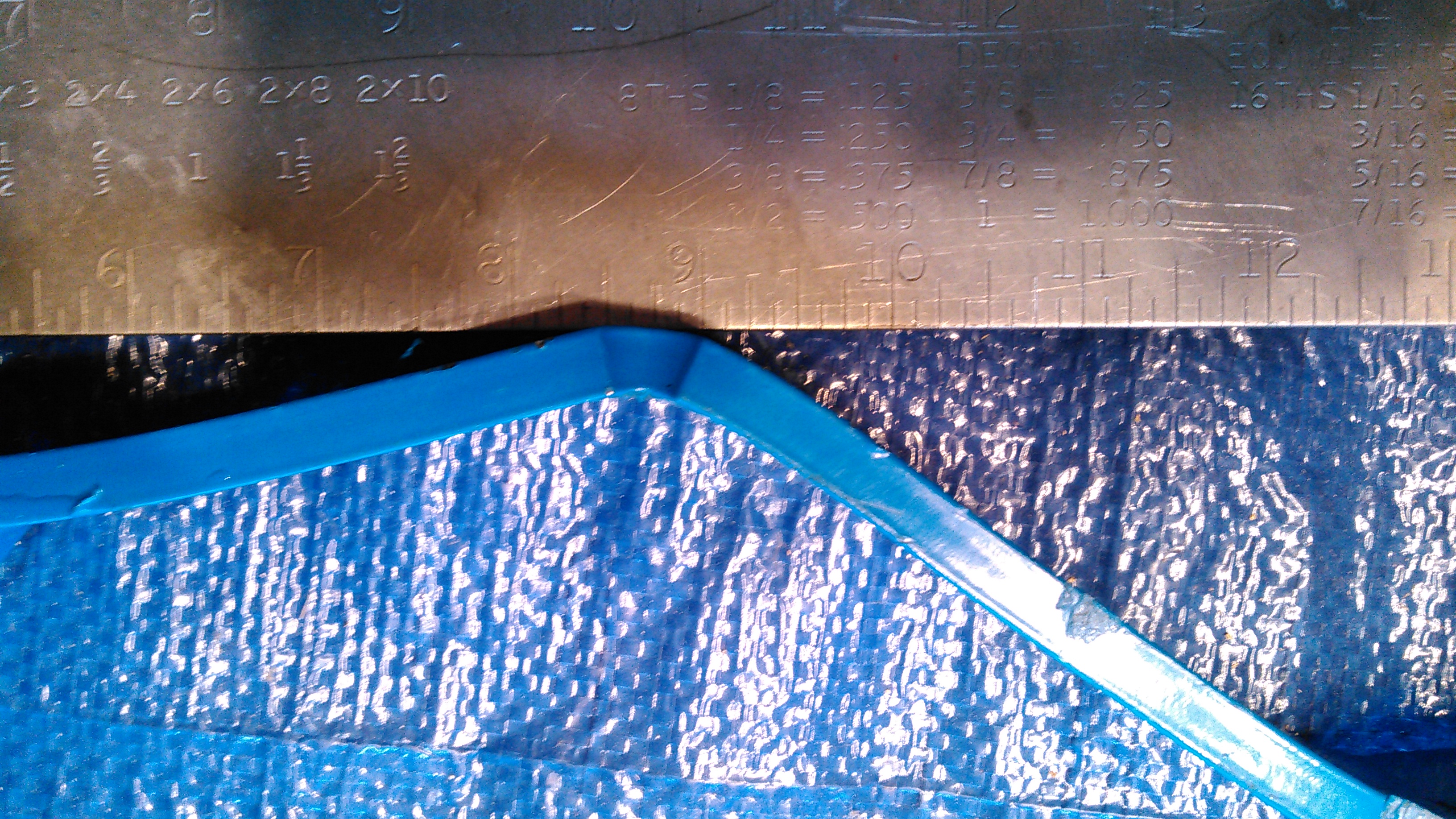

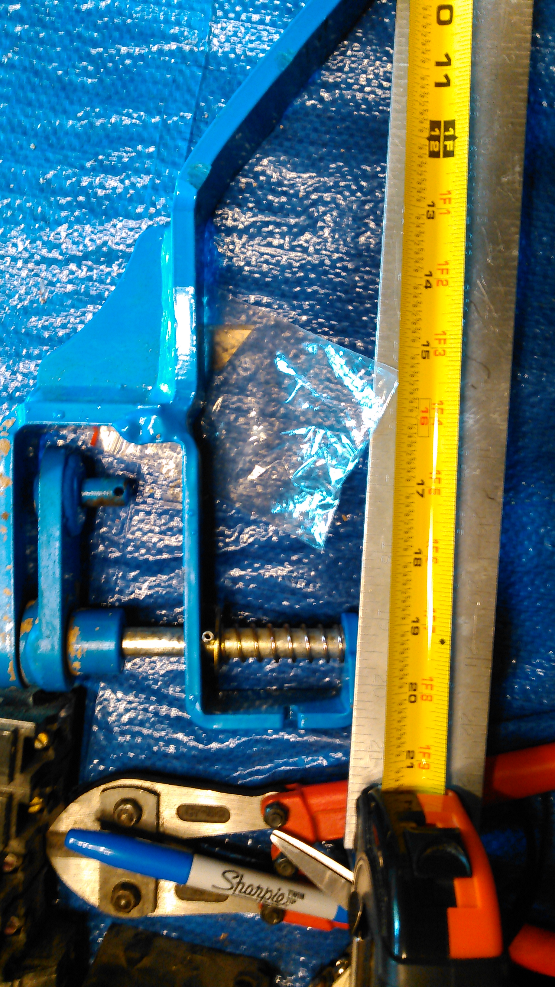

The arm was bent pretty badly, I straightened it enough to get the deck back on, but I don't think I have it
correct... I tried to go by the local LS dealer to compare it with a new one, but they had none with a MMM.
EDIT: Had some free time today, I think I've got it as close as I will ever need

I would not consider that your fault. It was assembled incorrectly!
   / MT-125 Messed up (70% LS, 30% me) #4
When you buy a new and pre-assembled tractor it is wise (but not mandated) that you check the visible and accessible nuts and bolts. Since the pin was in place, I'm not sure anyone would notice the missing washer/clip UNTIL the pin came out. I would push the dealer for a new arm as it was their assembly that missed the component. I was provided the install instructions with my manuals when I purchased my TLB so I know that the dealer had all they needed to complete the assembly upon receipt; they weren't doing it from memory. All of the equipment comes over on a boat, in crates, in various states of assembly for shipping. Every selling dealer has to complete final assembly.
