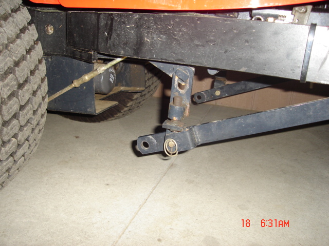

Thanks for the reply, did you have to level thedeck? Seems like on mine the left side is lifted higher off the ground if I try to only lower the deck to the have the wheels barely touch.
The manual says nothing really about adjusting this.

CB -- In the MMM manual, there's a section on set-up, with the initial procedure & adjustment process. Those two arms that attach to the deck have a height adjustment on them. Look for the large nuts near where the arms connect with those spring-loaded pins.

Perfect and thanks I am currently looking at it :)
   / Mowing the lawn
#9
So I was able to make adjustments last night. So with the deck at my calculated 3.5" cut height my gauge wheels are about 1/8" off the ground in the front and about 1/2" in the back.
I assume this should be fine because I remember my Toro said the deck should have some type of pitch forward.
Any input would be great. I can't wait to mow again.
   / Mowing the lawn #10
Don't know for sure, but mine pitches somewhat as well. Still have the snow blower on so I can't check! Grass is beginning to turn green, but hasn't started growing yet.
Here's a pic of that adjustment point, though it sounds like you've got that set up now (couldn't find it earlier)-- MMM adjust link.JPG
