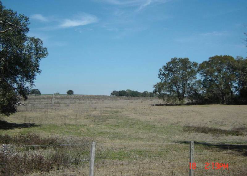

Actually, It is going to be a 9-5 job for some lucky person here! I've found a laborer (college kid) who I'll pay 7 bucks an hour to ride the tractor this summer.
The property was a cattle farm in a previous life (actually a farm since about 1910.) It was given to the kids in an estate, and in-fighting and negligence just let it go downhill. Wasn't cared for much since about 1990.
I'm developing it into 10+ acre farmstead tracts. It is perfect for equestrain uses and gentlman's farming. The property has huge live oaks, gorgeous pasture, and a gentle slope to it. Going to put in a gated entrance, private road and briddle trails.
Have been working hard to get all the junk cleaned up around it, now its time for pasture rehabilitation. Pre-sales are strong, so I don't think I'll have the cutting responsibility for more than 4 more months, except for the 10-20 acres I keep. However, I would like to get a larger type mower, but can't afford it right now with all the eupiment I just bought.
I just had it cut 2 weeks ago (it was pretty thick then) and the contractor had 2 tractors running with 6 & 8' cutters and it took 32 hours of meter time.
I'll look into the flail cutter and larger finish movers. I'm just worried about all the dead fall and stick out there. Slowly but surely they are getting cut up, but I don't see them not being a threat for at least another 3 cuttings.
Thanks for your help!
Ray

   / Mowing???s Hogging vs. finish.
Here's another shot after the second cutting. Currently, all the fences and gates have come down. You know, its actually kind of a dilemna. I could get everything done easier, faster, and cheaper with more excavtor/dozier time, but I would alos be screwing up the pasture and land and wouldn't be offering as nice of a product to the buyers.

That ground looks to rough for finish mowing to me. As for the 32 hrs mowing time, well, you have to spend it in order to make it. If you want to play in the developer business you'd better learn to get professional workmen. /forums/images/graemlins/tongue.gif
