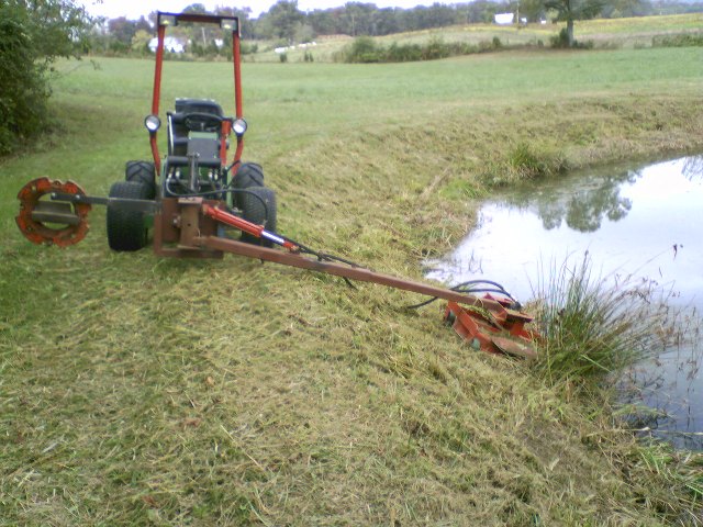

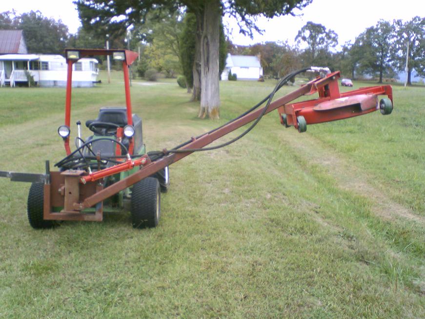

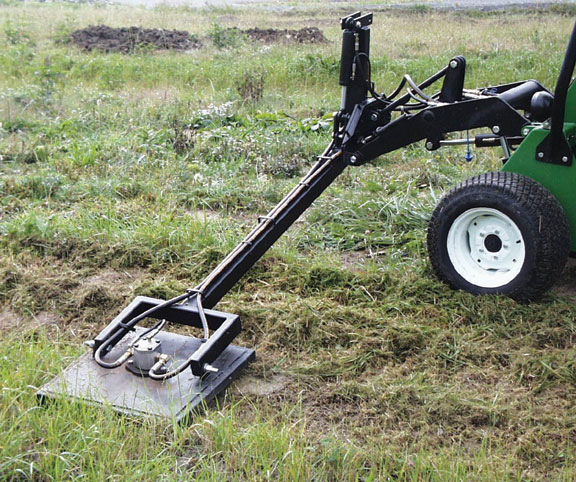

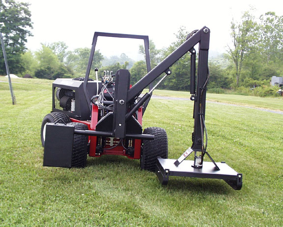

Here are some alternative ways of cutting slopes.
