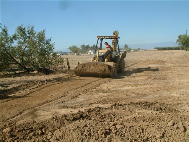

The pipe in my leach field is buried about 3 ft down. I've run over it with my Mahindra 5525 (about 6000 lb dead weight) with no problems. When the septic system was installed, the contractor used a Cat 4200 tractor/loader/backhoe (TLB) to dig the trenches and backfill. He used the TLB to pack the fill in the leach field trench. That thing weighed at least 10,000 lb. No problems after nearly 10 years.
