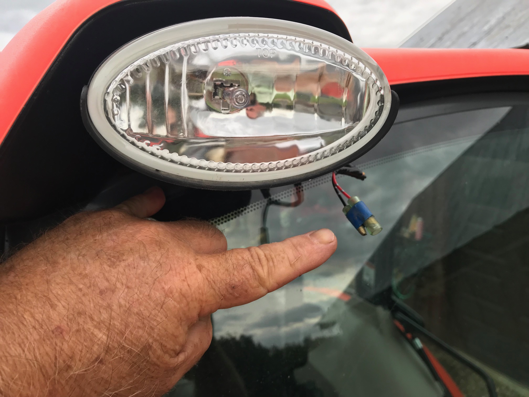

Title says it all. The lights on my M7060 suck and in the time of LED lights, Kubota missed the boat on this one. IU have quite a few LED lights from a buddy of mine that works for Truck Lite that i am going to mount on my tractor. Anyone have any idea what these wires are for?

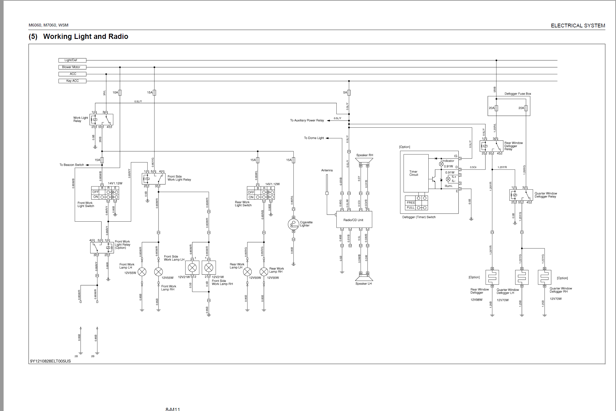

Here is the wiring diagram looks a like a plug for another lite, same switch

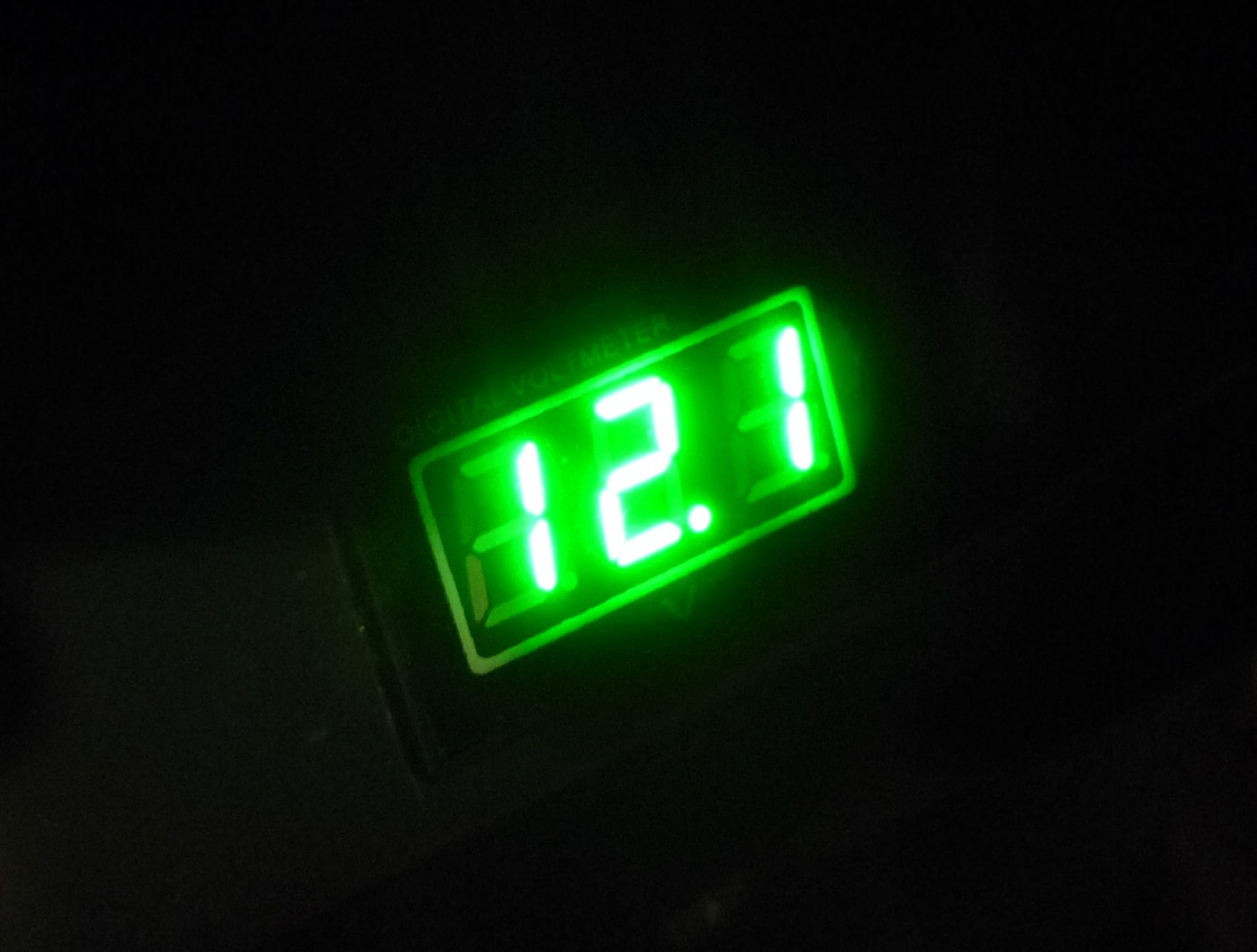

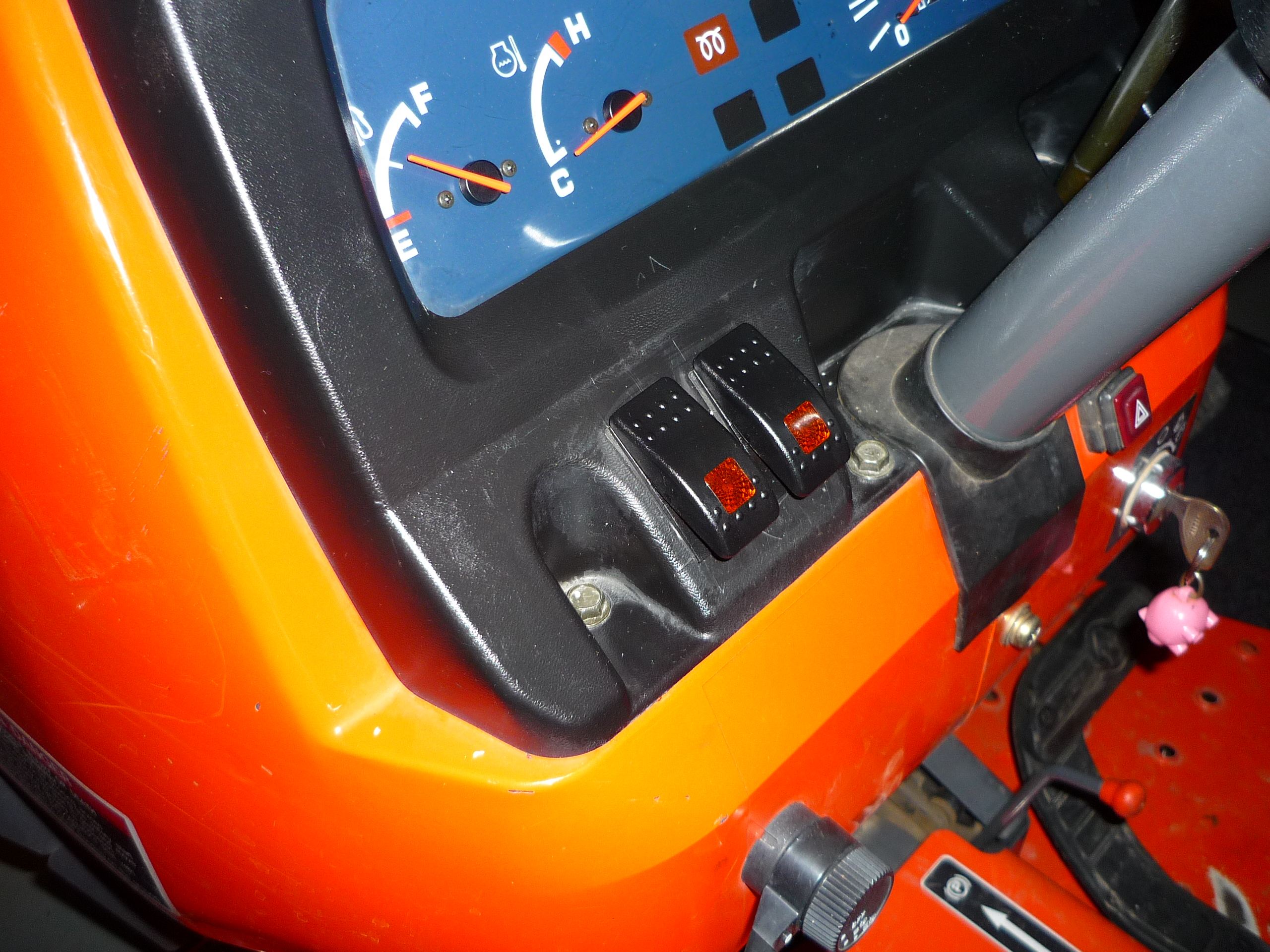

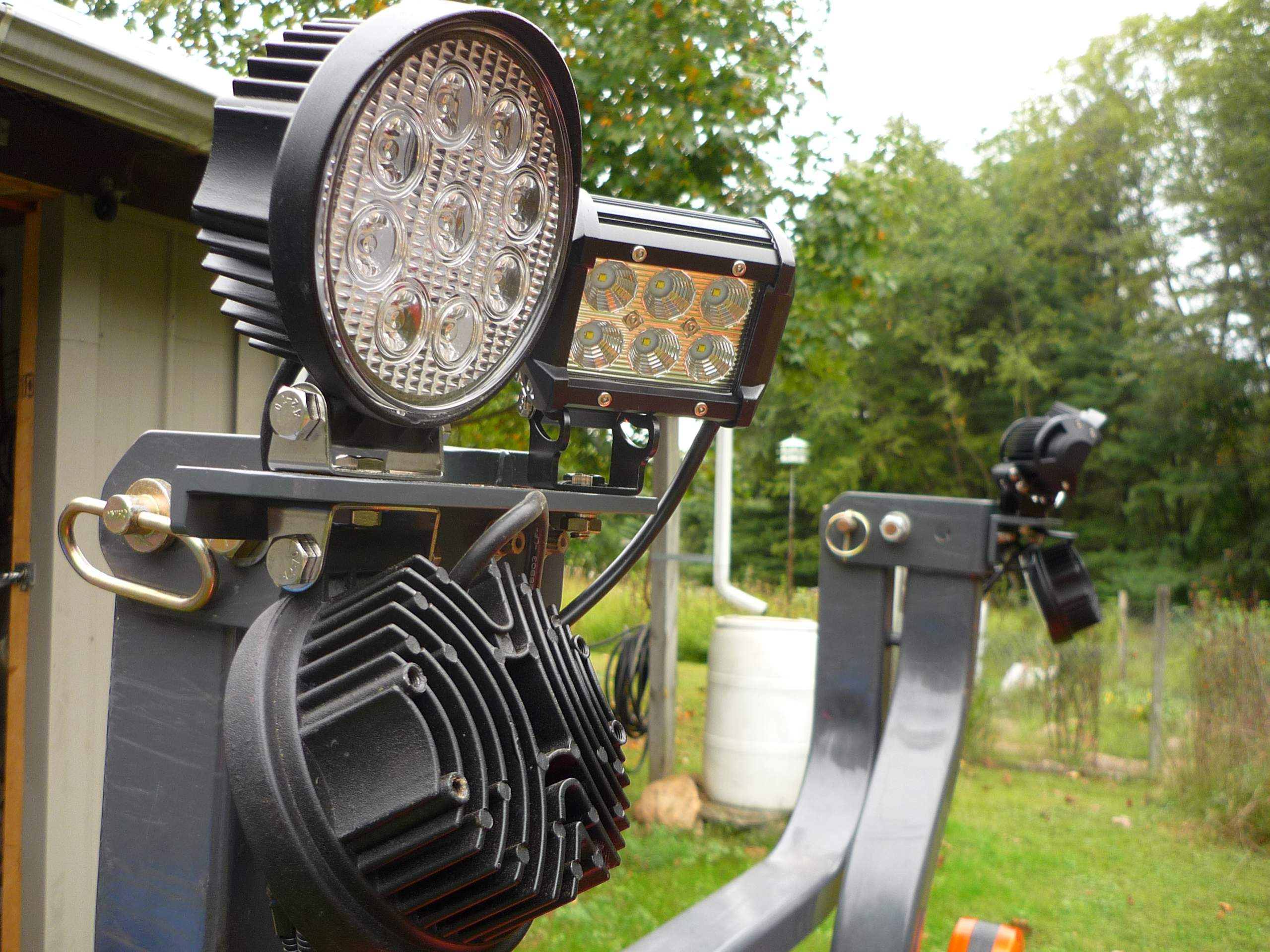

I have festooned my L3400 with LED lights (basically, cheap ones from China- although they all must come from China these days) since I used to need to snow plow at night occasionally, and they work fine. Two front, two rear, two side, or alley, lights. The current draw is very nominal, and they have worked fine for years. Just warm enough for snow to melt off. Waterproof rocker switches, lighted so if they get turned on in the day, I know it. Also installed a waterproof digital voltmeter, just as a simple way to keep an eye on my battery and charging system. For some reason, I can't remove the photo that shows the earlier version with just the two lights per side...

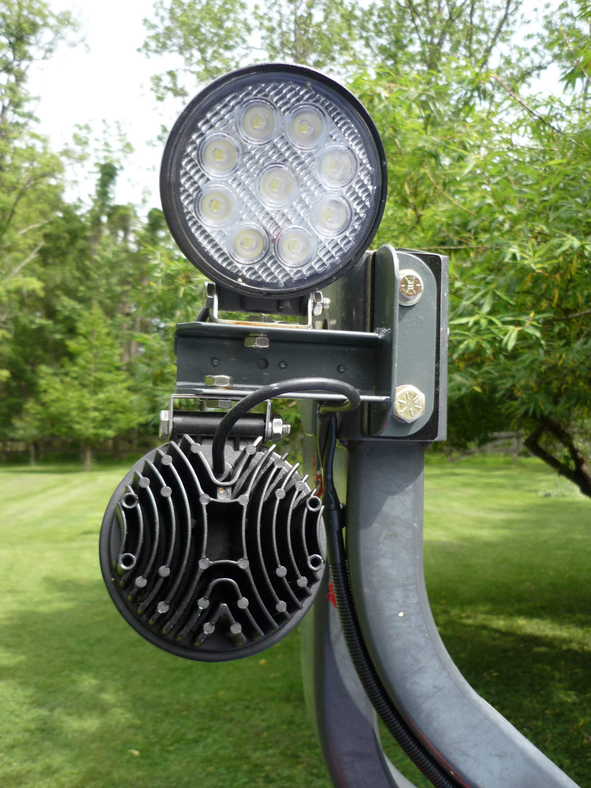

Like Varmint, I added 6 LED lights, all on my roll cage, and with them all on, I don't even use my factory lights in the grill, they just shine on the back of the loader bucket anyway. I often mow at night, or finish in the dark at least!

If those two wires come from up under your rear fender - they are hot leads. They power my rear light. If I had to do night work - I'd be getting LED flood lights from J A McDermott out of Ridgewood, New York. Commercial 12 volt LED flood lights. I've worked on commercial fishing boats that use them.
If you REALLY need lights - these are the ticket.

I have 2x 30W LED flood lights mounted on my ROPS (no, I didn't drill - I simply used wide HVAC band clamps).
I have one mounted for the front, and one reversed for the rear. You can see 500' all around.
