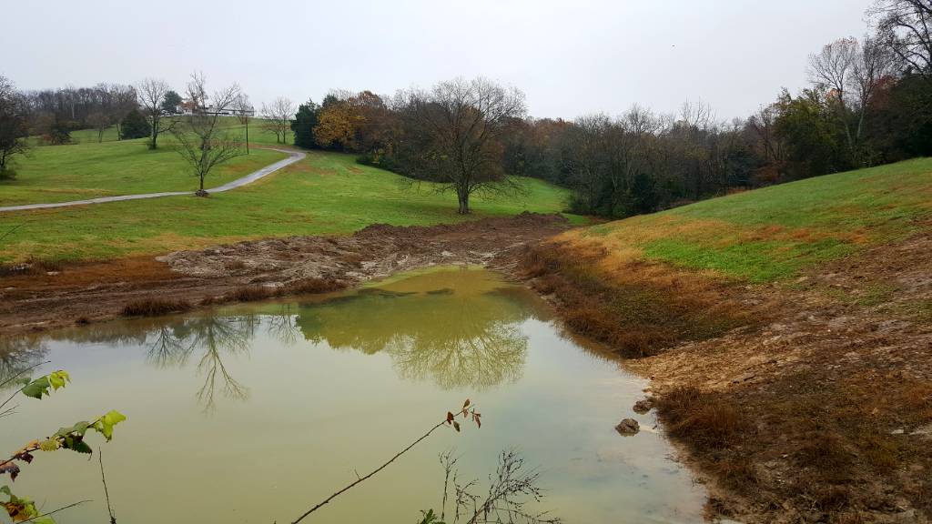

We use the flails for knocking down weeds in the pastures and paddocks. Much more maneuverable than the BH3210.
Kept the 5' rotary cutter for opening up woody brush for the first time, and to find the hidden rocks.Then we use the flails to maintain.
We have a Kubota ZD21 for mowing the lawn around the house. I also have a J-bar 6' rear discharge finish mower that i probably need to sell. Started to rebuild the spindles and add anti-wrap guards 2 yrs ago, and it is still sitting beside the shop. The rear discharge was good for mowing the paddocks to knock down the yellow blooming noxious weeds which cause my eyes to burn when cut with the side discharge ZD21.
