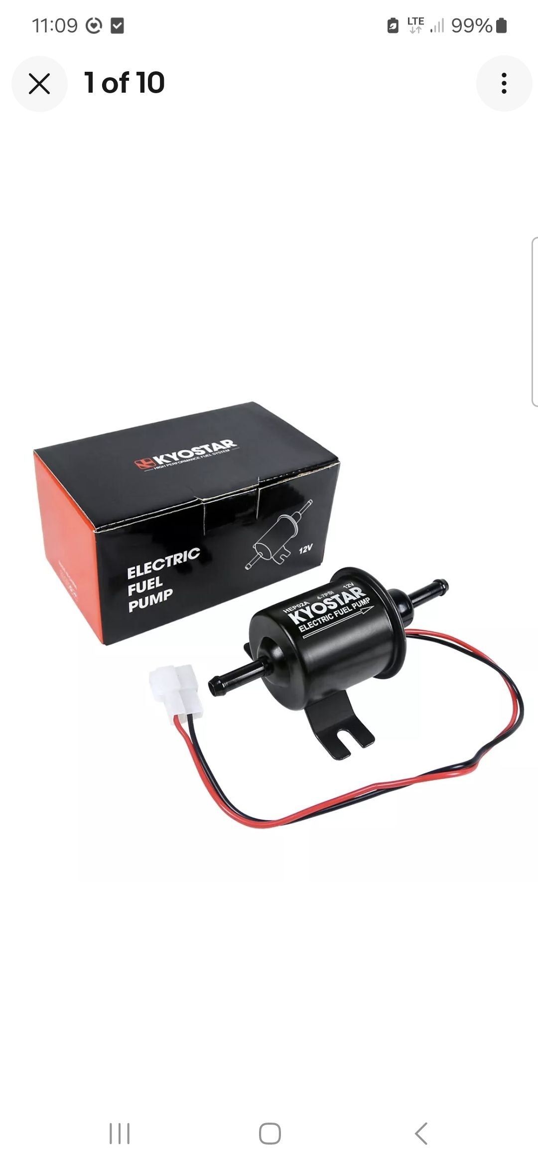

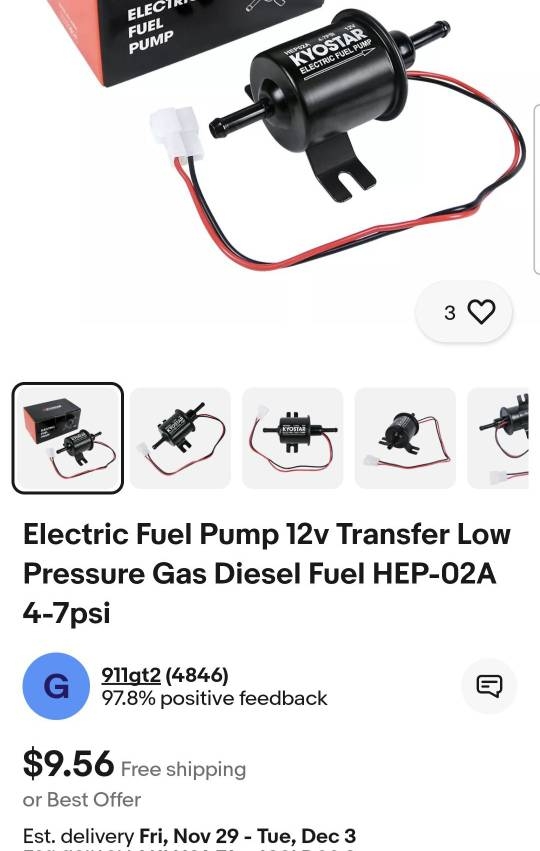

What I have is a universal gas pump ($10 ebay) and clip leads (Harbor Freight). Cut plug off pump, add wire as needed (Dollar store extension cord is fine) with clip leads other end. Then you need a length of fuel line and clean container (1 gallon gas can, milk jug, etc).
Disconnect fuel line at carburetor and plug it.
Now feed carburetor with this, having new fresh gas. Clip pump leads to battery, red is +, black --.
If it runs fine, you have fuel delivery problem.
You can use pump later to fill tank, etc.
If it still has problems a new carburetor may not be expensive. If it's $30-$40 to me not worth rebuilding by the time you buy a kit.
