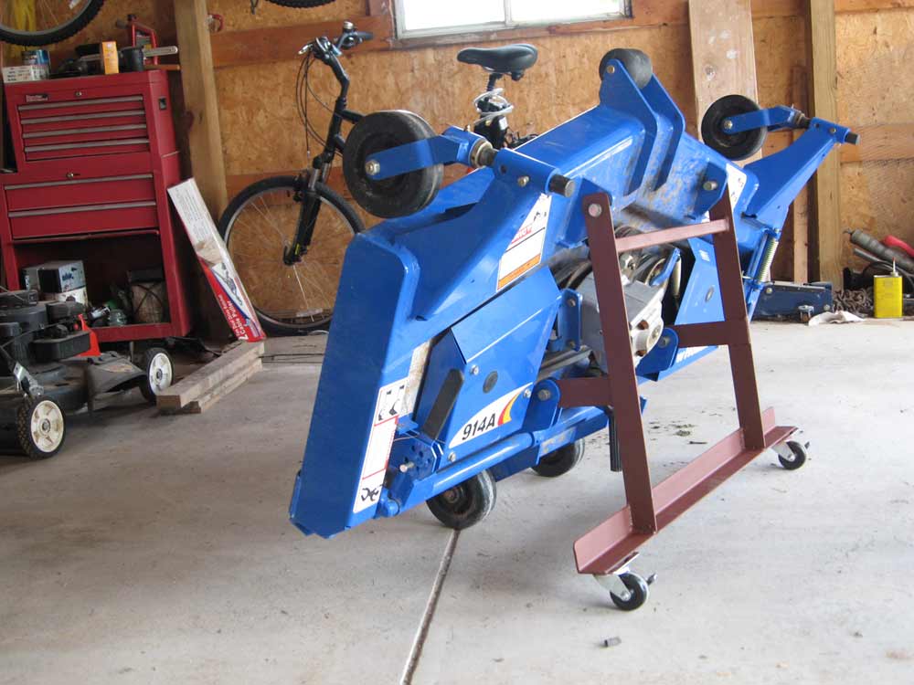

Does anyone have any ideas for a mower stand for the New Holland 72" mid mount mower. There are no rear casters to work with, and the fronts are recessed behind the anti-scalping roller, so I do not think the axle stands will work. I want to stand it up vertically to store and clean the underside. How do the other NH owners do it?

I built this because of the same deal. I wanted a way to store it upright and also be able to clean the underside. It uses some flat stock, piece of angle, and 2 caster. It rolls so eazy and saves me a little space. If anyone has a better idea I too would like to know.

looks like a good stand to me. would,t think it needed any improvment
   / Mower stand for NH 914 72" MMM #4
The pin-on stand is good.
The next step would be to fabricate lower extensions for two more caster.
A four castered stand would be easier to "steer" into a tight spot.
