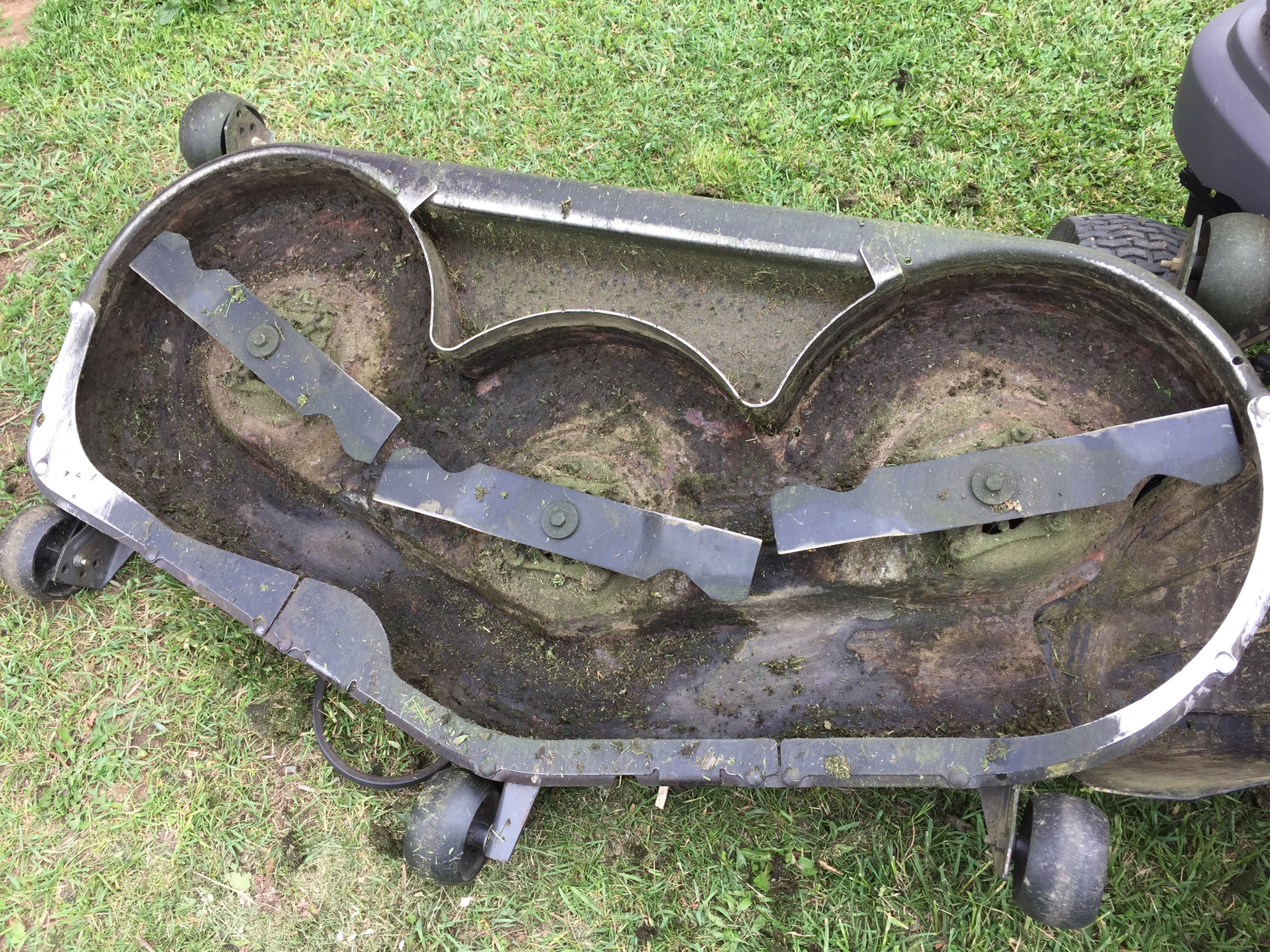

Time to pull the deck off and clean it out, grease some zerks and put it all back together.
I'm getting a build up of wet grass on the deck so I'm just gonna clean it out properly, deck doesn't like wet grass too much lol.
   / Mower is acting funny, what do you think is wrong?
I should have taken before and after pics, I'm surprised it could discharge anything lol, sticks and all kinds of crap stuck inside.
