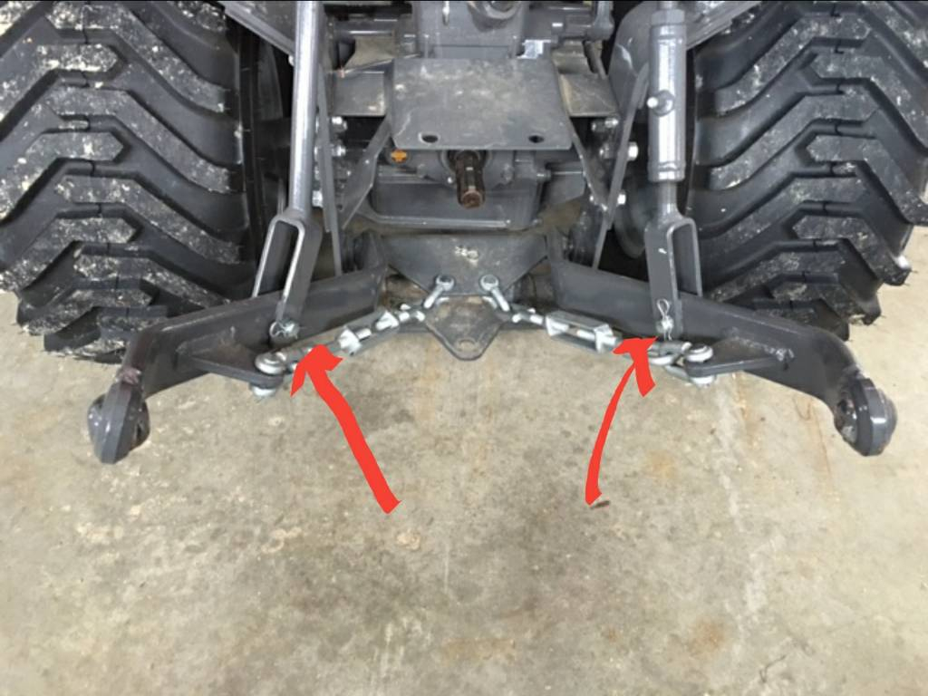

I am about to pull the trigger on a Massey, or so I thought-- but is it true that the mid mount mower cannot be used with the backhoe attached? I know the BX and Deere can.
I plan to use the backhoe as ballast for the loader and really don't know if I like the idea of taking it off every time I want to mow.

I can mow with my backhoe attached. You just need to be mindful of the lifting arms since they can move between the backhoe and tractor. I just removed my lifting linkage and lower arms and don't need to worry about and issues.
Yes. You can mow with a backhoe on. But, it's an extra 600+lbs. I prefer not having to worry about banging it on things. And it makes quite a racket as the cylinders leak down a little, get sloppy, and rest/chatter onto the transport pins.
   / Mower Incompatible with Backhoe? - Massey GC17XX #3
If you're careful with how your tuck your lift arms away between the backhoe and tractor, you really don't need to worry about it. Just disconnect the link where it connects to the lower lift arms.
   / Mower Incompatible with Backhoe? - Massey GC17XX #4
Just unpin it here and tuck them up and away. Make sure the actual lift linkage isn't going to impinge on anything is they move a little.
The belly mower uses a shared lift reference and they move together but can move independent.
