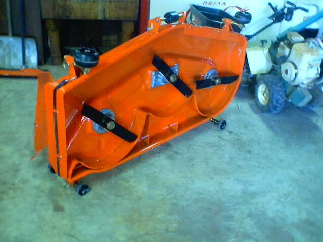

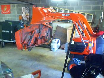

   / Mower deck mover #5
I have a set of those moweraxles and they are the way to go for stowage and servicing of the MMM.
Use the FEL to lift the MMM into position then set it down. The MMM is easily rolled around out of the way.

   / Mower deck mover #8
Three things:
1) Dude. Didn't see the line in the manual about steam cleaning and waxing your mower after each use.
2) Where do you "pick" from to get the MMM up on those axles? I'm assuming there is some place you can hook in or some strap you made and that you don't just pick up one lip of that oh-so-pretty mower deck and hope it doesn't tip to the other side when you get it up...
3) While this is a nifty way to store the deck, it still looks like a royal pain to pull it out with the turning of the scalp wheels and replacement of the one set with these axle things. Turned the scalp wheels ONCE and vowed to never do it again. Took a half hour and wasn't very easy. Or fun.

> Dude. Didn't see the line in the manual about steam cleaning and waxing your mower after each use.< Oh it's there on page 'errr, ahhh, yeah, that page :D
Actually that pic was taken when that MMM was still a virgin and hadn't cut one single blade of grass yet. You see when one buys a brand new MMM in the dead of winter, one's mind starts to modify and change things after said mind has sat and looked at said MMM for too long :D
How did I lift it into that position? Easy, 1st you start off with FEL bucket hooks (did a thread on that), hook up a chain to the MMM and to the bucket hooks and then I let the BX's hydraulics make little work of depositing said 250lb MMM where ever I want it too :D
These pics were taken the following winter when I was putting the MMM away for the winter. It weren't as purty as it was in the 1st pic.
I can R&R my 60" MMM in about 10 - 15 minutes without breaking a sweat. it's all in having a plan :D
