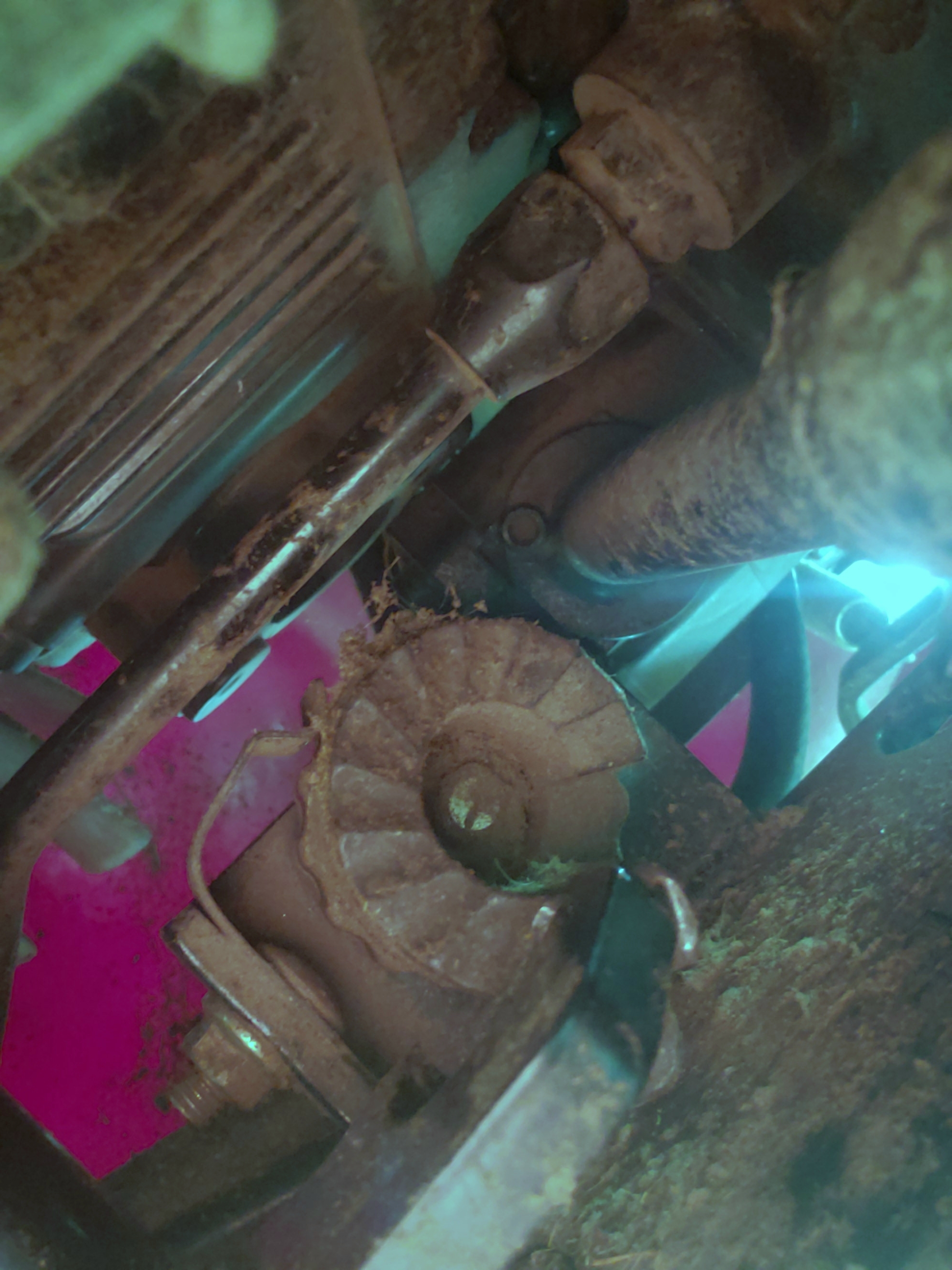

Have you still got this tractor and figured it out? From what I'm gathering, the knob has come loose and moves a bit, no longer just a tight circle when turning, but can be tilted. I'm going to see if it can be tightened to no longer shift. I have a picture from the bottom, and it appears the contact areas are worn.
