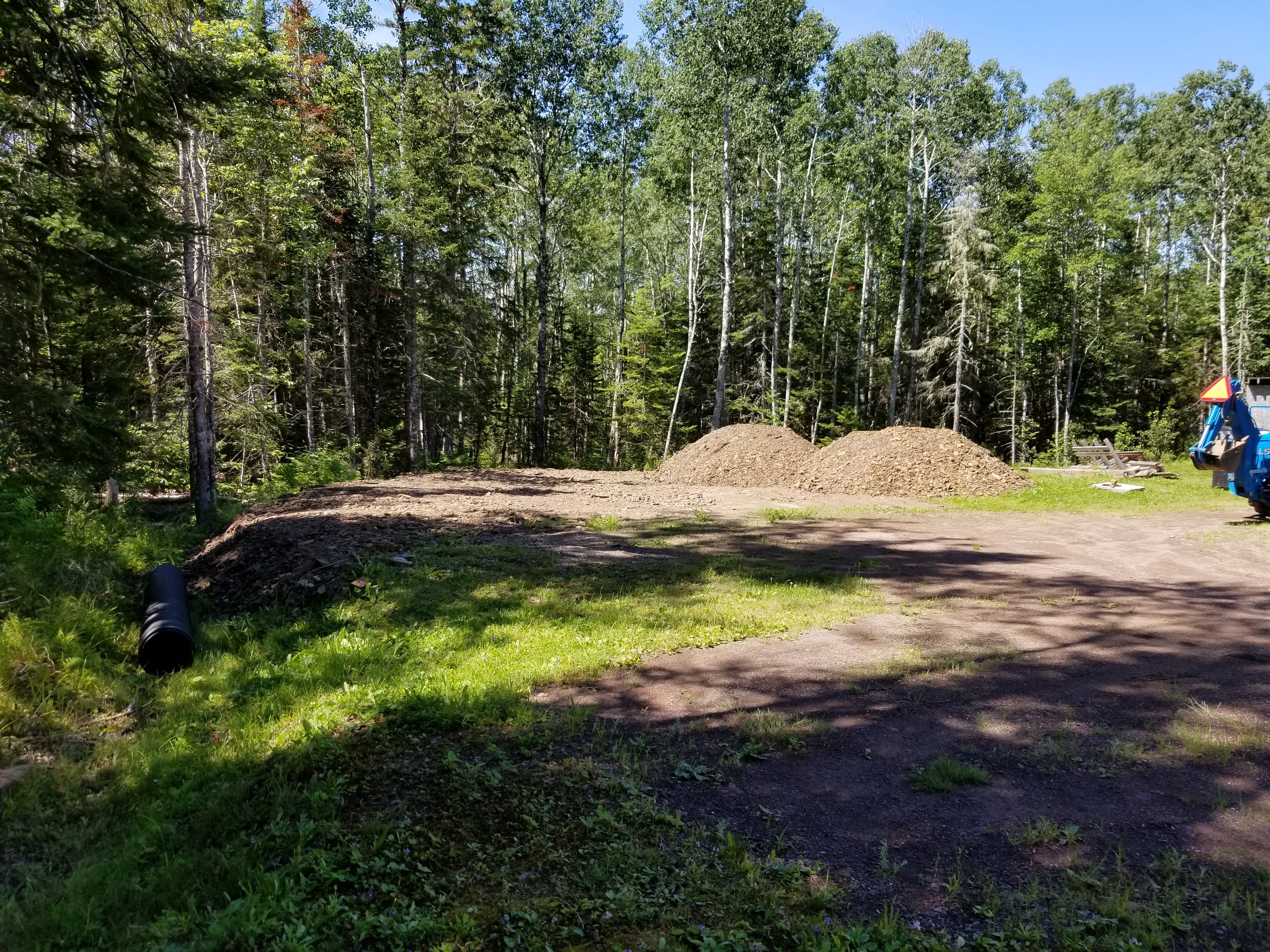

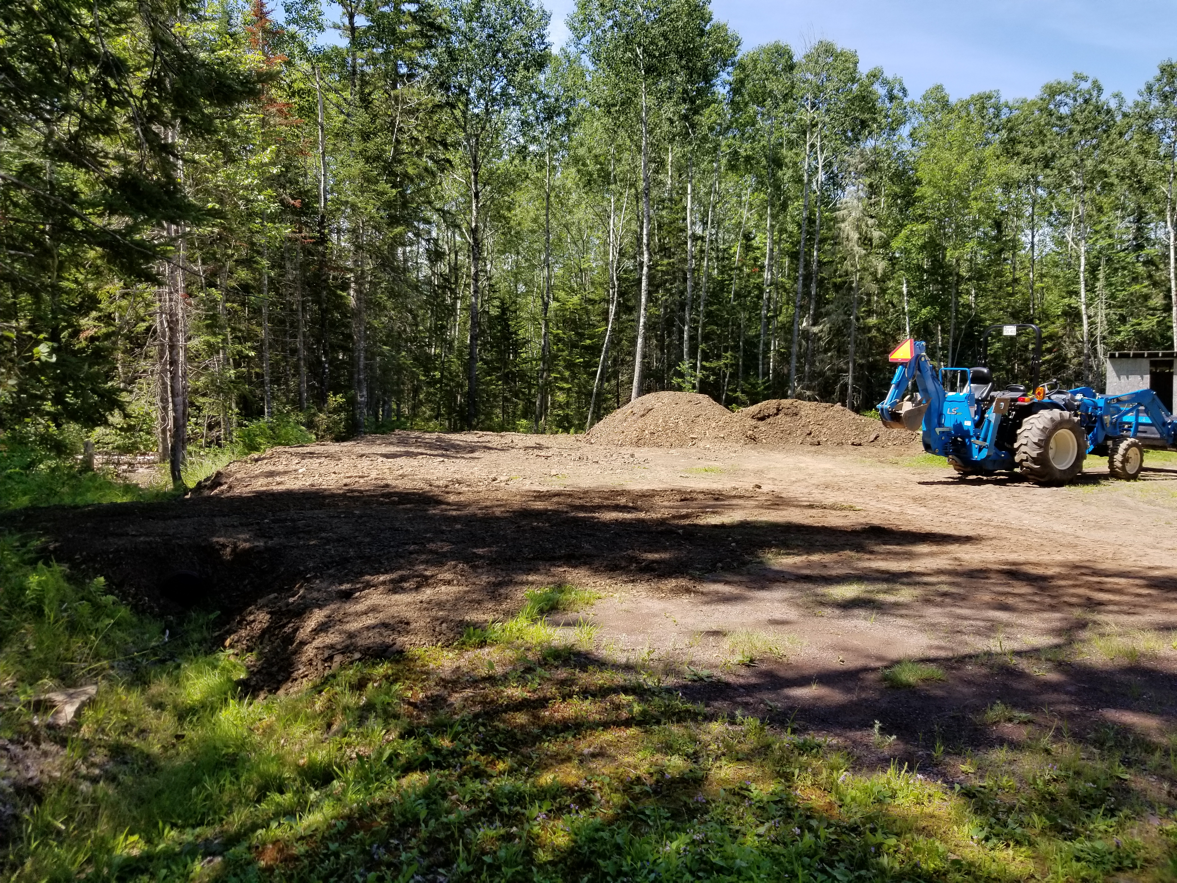

We finally decided to fill in some of the big hole in the back yard a few weeks ago.
11 tandem loads of crushed shale in the hole and 2 on top for working around the yard with.

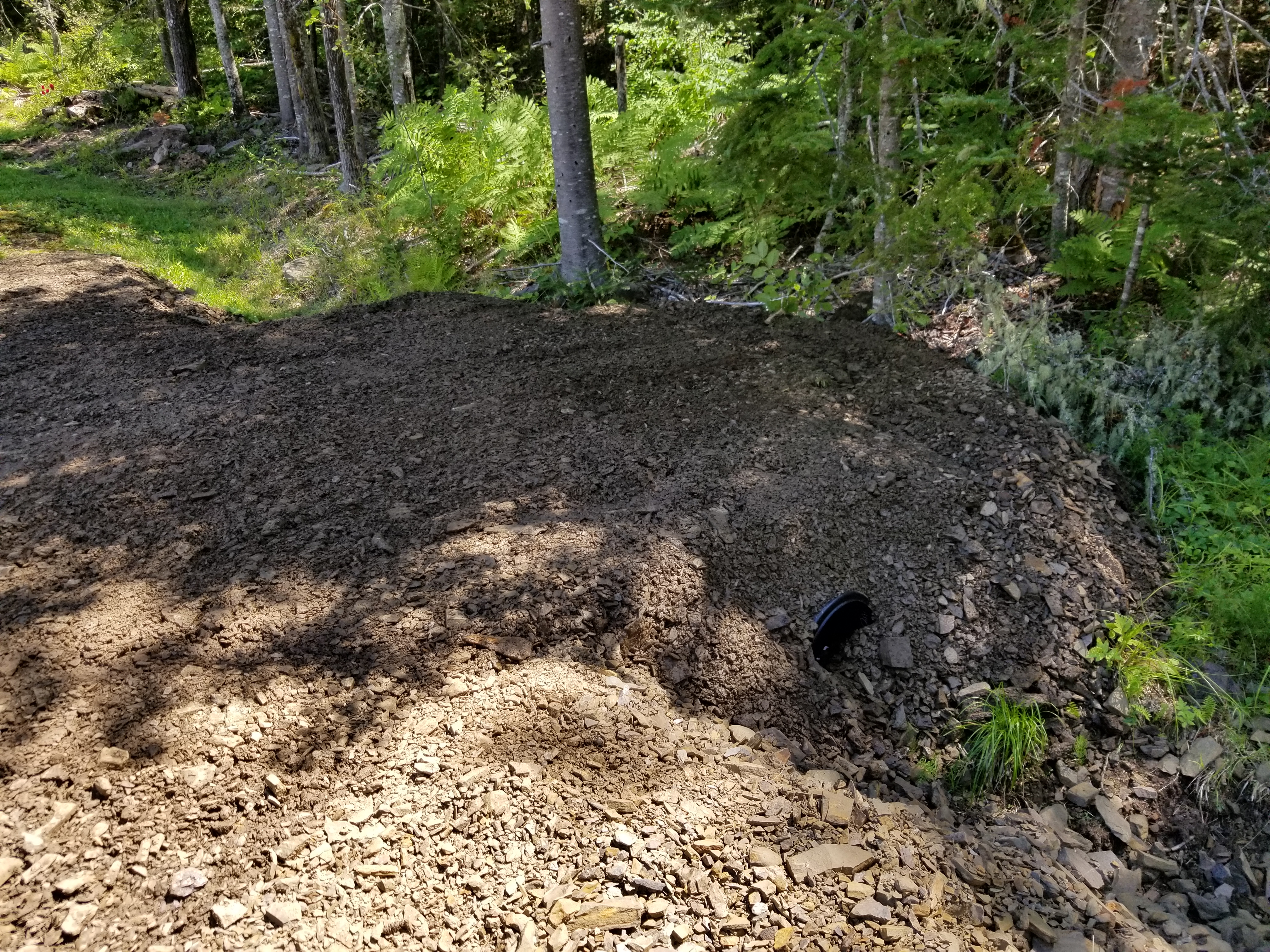

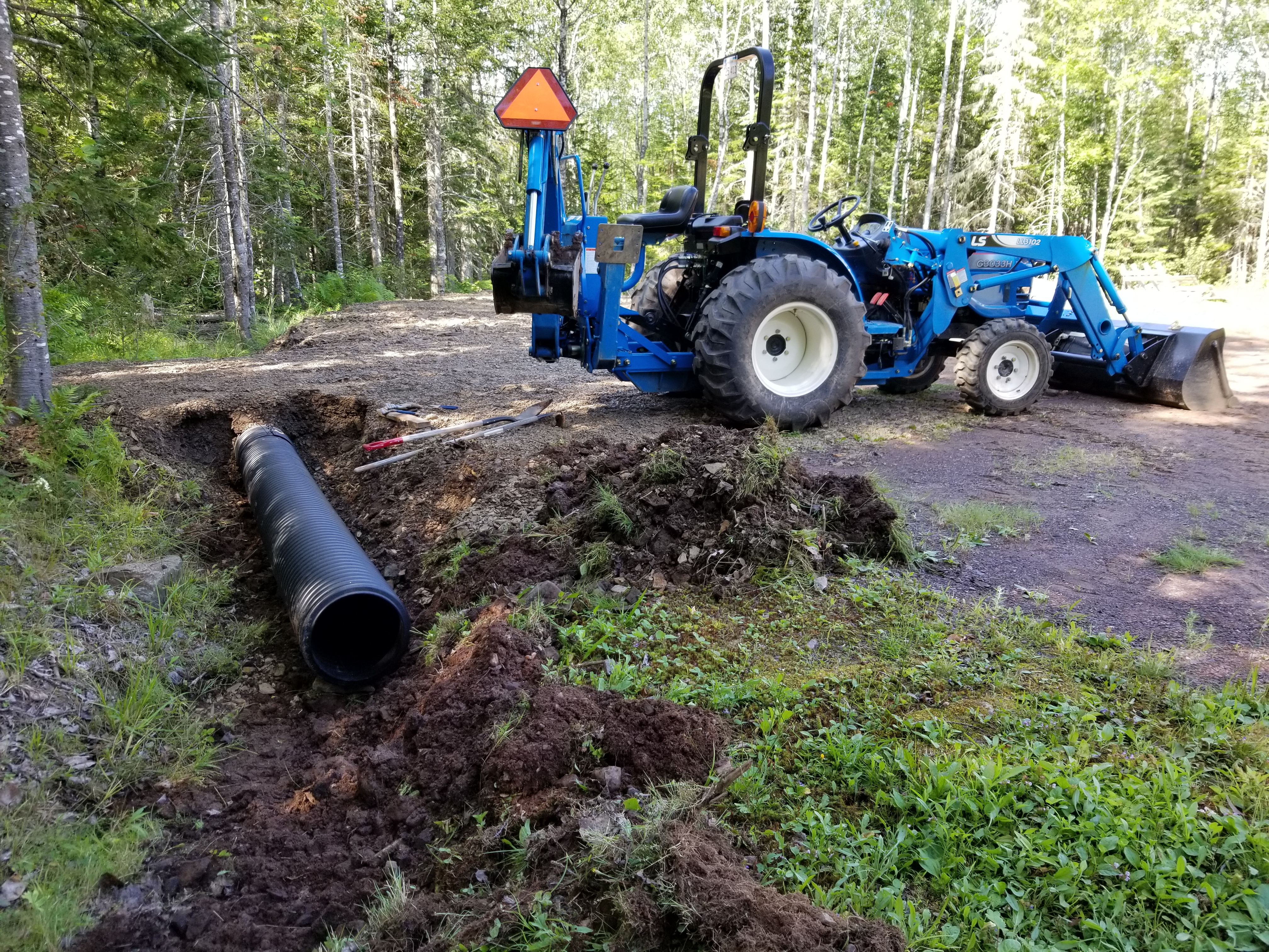

Yesterday I put in a small culvert to get me across to where our garage /shop will go in a few years .
now i can easily start dropping trees and removing stumps where it will go.
I cleaned out the culvert ends right after the pic was taken :D

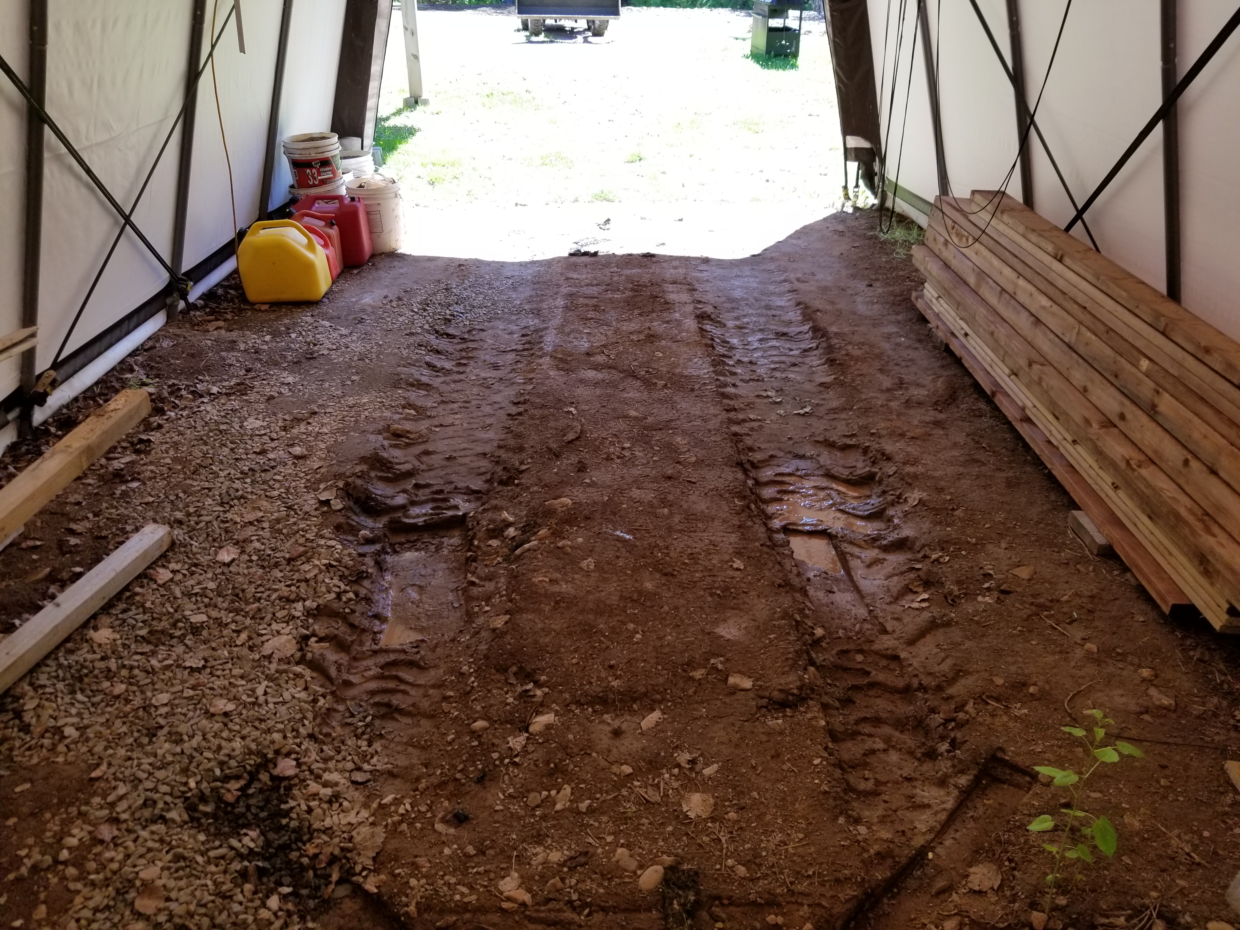

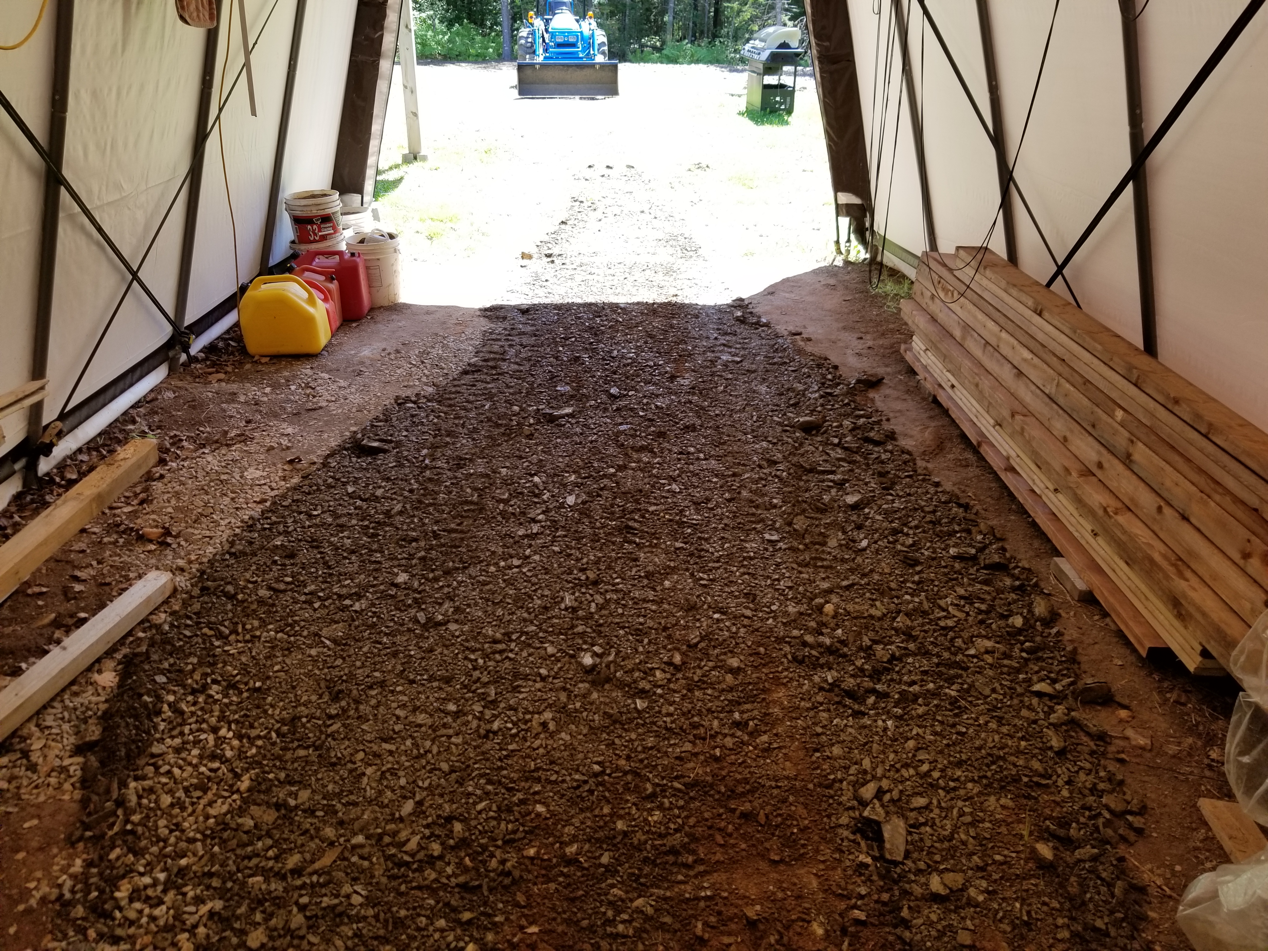

Also my enclosure has been getting a little muddy as of late so I figured it was a good time to straighten it out while i had the material on hand.

This being my first culvert install I figured that I would buy the 24 footer. This would give me 12 feet for the garage culvert and I would have the other 12 footer for another part of my property.
Turns out that 12 feet turns into about 9 foot 6 after it's in and there is material runoff on the ends . (newbie mistake) In the winter there will be ice on this sometimes so that is not a comfortable width. One 18 dollar coupler later and I have about 21 feet of usable driveway across the ditch now. Much better. It would have been easier to couple before I put the first one in but learning from your boo boo's is always a good thing as well :thumbsup: .
