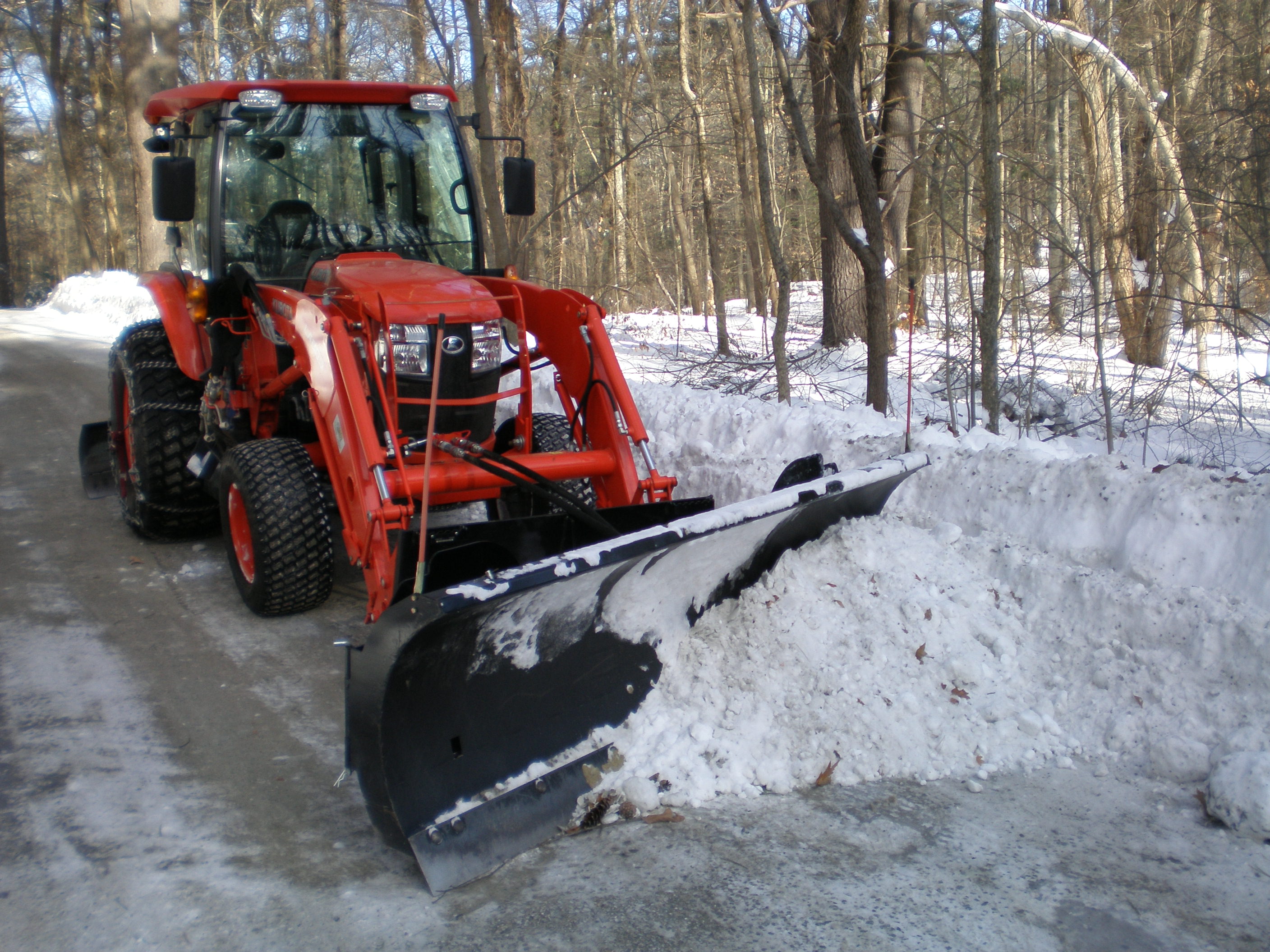

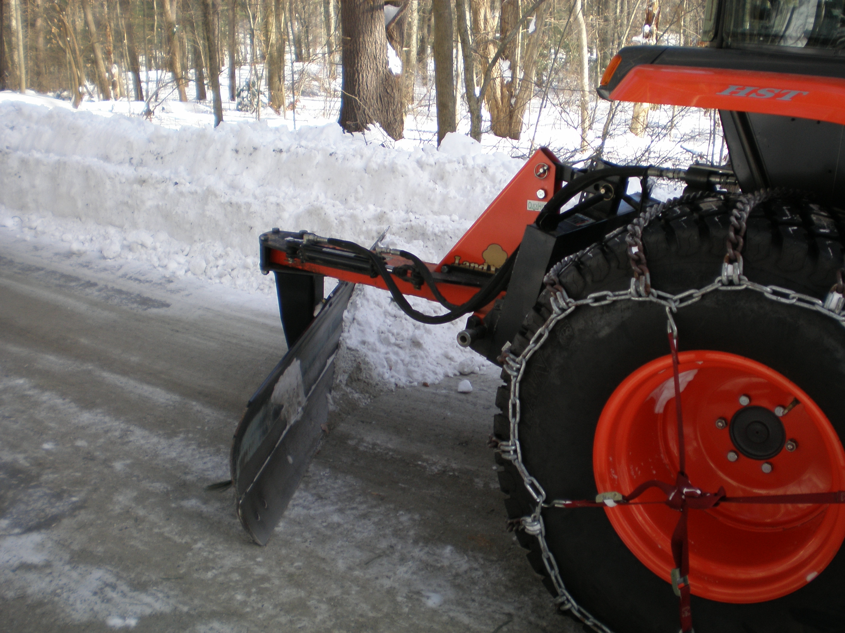

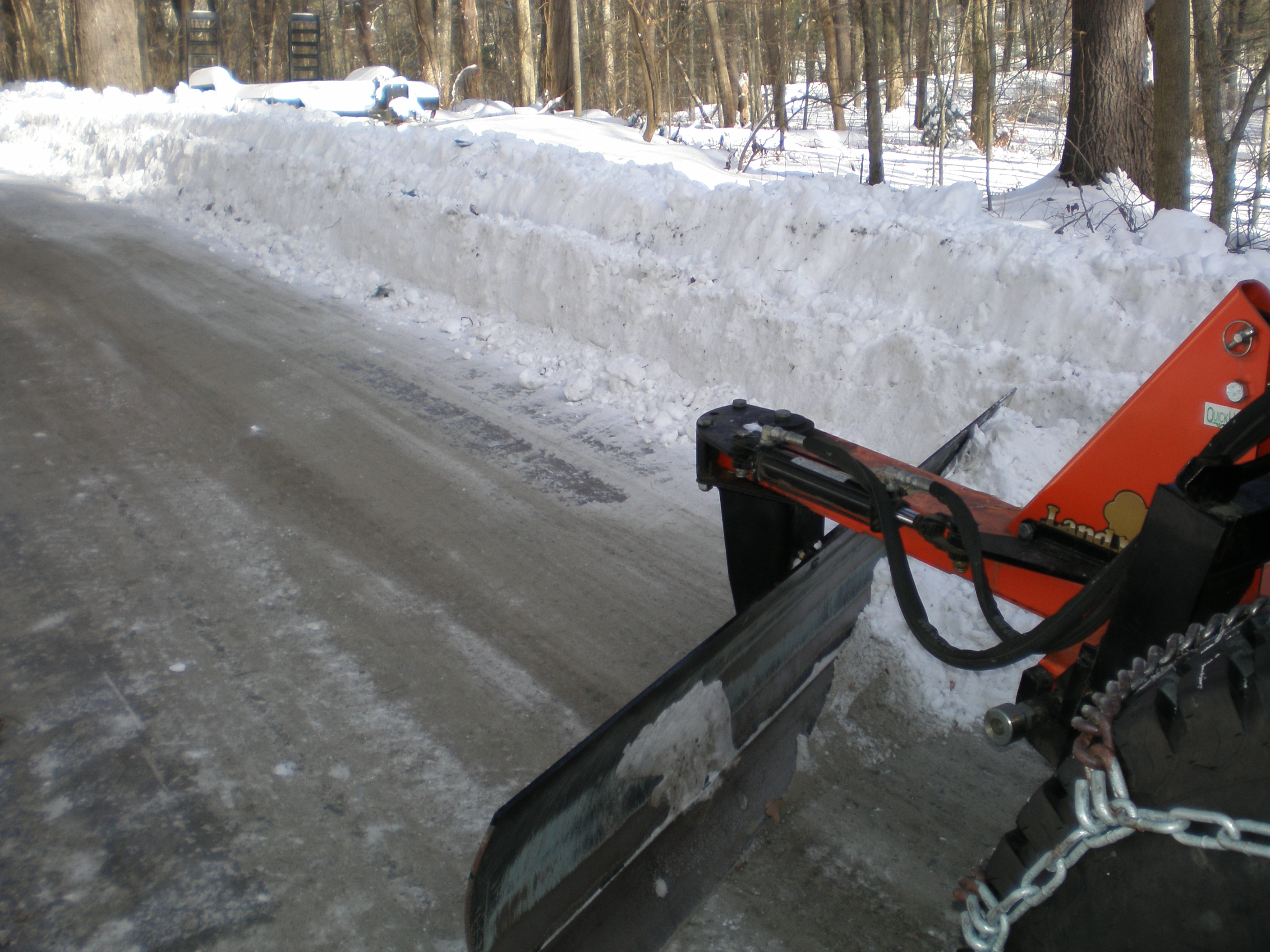

I only use both at once when snow stick/wet,for front plow will ride upon snow leaving 1" or so and rough...rear blade the cure.

Too many variables;snow depth,weight,size of your tractor ect.FEL's are good for moving banks back and rough removal of snow.Rear blade is more useful and a better finish.Some people use a "light materials" bucket that has a lot more volume;a front mounted plow is very useful.I use a 8ft.in front and a 7ft.rear.
